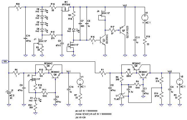

Forgot about a question to all of you guys: I would need help in searching for a really good power supply for the oscillators which can be squeezed in a relative small PCB space (3.3V @ 100-200mA max)? I opted for Salas but he does not like the idea to have his design implemented in a commercial product so I respect his decision and move on. There's LP5900 approach (already used in WaveIO) but I feel that is something better out there...

PFM Flea is highly recommended and small footprint.
AD797 based linear regulator, flea by name and flea power by nature but can easy be fitted with pass transistors, its a very high bandwith regulator so attention needs to be paid to layout.

its hardly needed to license the flea, its a well used concept thats hardly unique, its pretty much exactly what I already linked and recommended. so I think as long as you make some original parts choice and do your own layout, you are free to use it how you wish. I know of at least 3 datasheets for opamps and references that include a flea type regulator.
I mean no disrespect to Martin, its a good reg and quite suitable for this application, but I really dont see that permission is needed to do something along these lines ie. a filtered low noise voltage reference, feeding a low noise opamp, with or without pass transistor, or buffer to increase the current, as long as you dont just lift the layout and BOM.

As an alternative to the Flea, the Peranders's (member of this forum) regulator, named 'JSR-02' based on Jung reg with surface mount parts could also be a suggested base for a clock regulator. Salas regs are maybe more intended for feeding analog stages where audio bandwith only is concerned.
when you can get such good performance with ~10 parts, a super regulator with at least 4 times that is complete overkill. we should really stop using the name flea, its kinda limiting anyway, theres a number of variations on the theme that would be useful here. Lorien did mention compact was desirable, but then he mentioned the salas reg =)

We all know that "compact design" is relative thus subjective concept. If a PSU is good enough but uses a large amount of heavy parts then I could try to replace some of them with smaller ones while (try to) keep the performance for the entire design.[...] Lorien did mention compact was desirable, but then he mentioned the salas reg =)

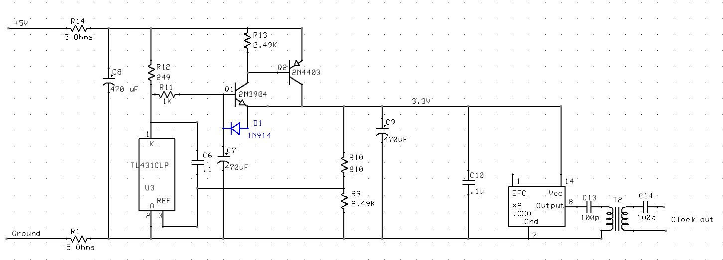

True, but as I mentioned, what benefits shunts can have over other types are not really of any benefit for a clock reg IMO, the extra heat and size are just a waste of effort. For this application absolute lowest noise and the ability to place it close to the dac trumps low output impedance over a wide band and great dynamic behavior. the small flea regs are very difficult to beat for clock power, demian has posted some nice designs too, with lower noise than either and compact, but you would have to get permission.
the integrated design is interesting, with the floating clock output. I suspect you would need to substitute the output transistors for 100mA+ though
