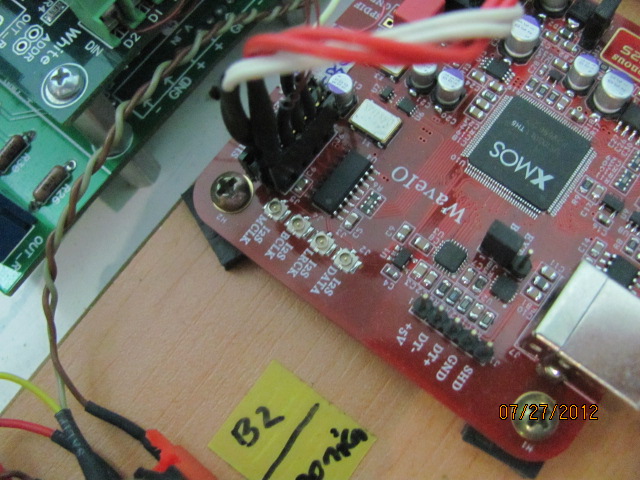

does somebody know how to connect the masterclock to an buffalo II DAC? What mods are necessary? 😕

@hochopepper: you are very right, Twistedpear left a backdoor in the BuffaloIII for the sync mode. There is a 3 pin socket underneath:
http://www.diyaudio.com/forums/digital-line-level/192465-asynchronous-i2s-fifo-project-ultimate-weapon-fight-jitter-55.html#post3027495
and here is how it looks like when connected:

I am synchronously clocking my B-II from an external async USB receiver. Here is how: First, depower the onboard oscillator by either removing the Trident regulator for it, or, if you are using the onboard regs, remove the appropriate inductor on the underside of the board to de-power the oscilator. Next (this is optional, it will work without removal, but I advise removing it because it will be in parallel with the new masterclock) remove the onboard oscillator. Now you will have exposed all the clock pads on the board and should be able to figure out how to hook up the MC feed from the Wave IO: I added a micro BNC jack directly to the board with some tricky soldering and using some kapton tape to block some of the pads from shorting the hot pin-I was able to solder the hot pad of the micro BNC directly to the hot pad of the MC position, and get one side of the ground pad of the micro BNC to solder to the ground pad. The other ground pad on the micro BNC was insulated from the board with kapton tape (otherwise it would have shorted to the hot pad).
If you just want to try synchronous clocking without removing the onboard oscillator, you can just supply the hot pin of the Wave IO masterclock to the pad on the B-II marked R-17, on the side where the trace goes into the ESS chip-it will work fine without ground for testing purposes.
I would strongly recommend against removing the XO.
You can access the same pads from underneath the board. Since you are likely to destroy the XO when removing it, unless you have a hot air rework station and know what you are doing, you will be unable to go back (if needed) and could easily damage the board in the process. I don't want to see people accidentally killing their DACs.
The XO output is high-impedance when not powered, so there is no downside to leaving it in place.

Brian, but the question was re the B-II. And yes, without proper tools it is unlikely that one would be able to remove the oscillator module without damage. B-III is much easier to manage for synchronous clocking, thanks for that! But it can be done on the B-II as well, one just has to be careful...
