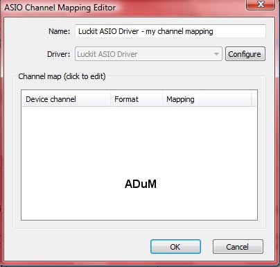

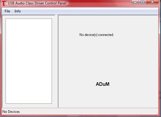

Teralink USB isolator based on ADuM4160
I purchased the board due to the low cost assuming the risk (or certainty?) that it couldn't work with WaveIO.
Yes, it doesn't work with WaveIO.
WaveIO is recognized by my Vista system as Class 1.0 through ADuM and as Class 2.0 with direct link.
Unfortunately the driver doesn't take into consideration a Class 1.0 unit so there's no way to have music played.

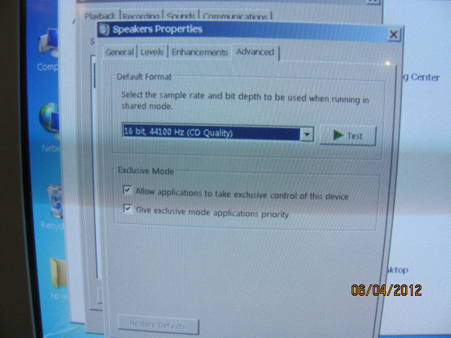

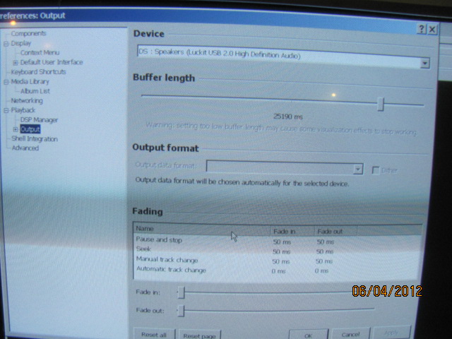

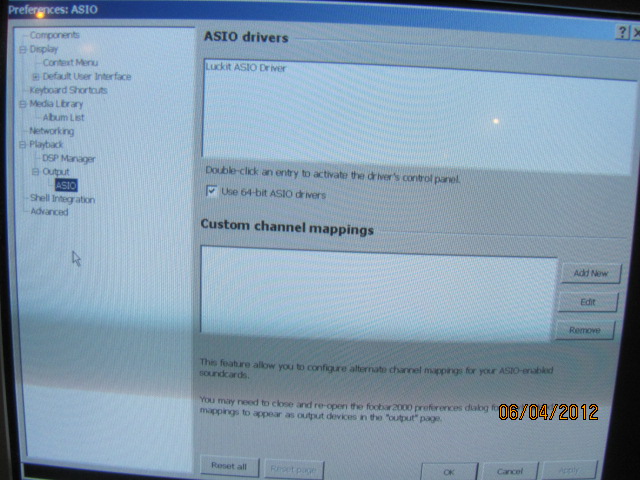

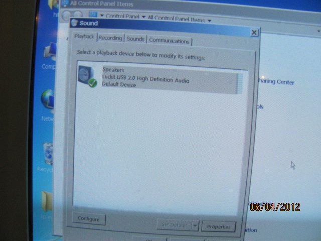

first off make sure you have your usb input for Wave connected to the dedicated usb2 of your motherboard., foobar gives you the option of preferences when opening it up to see what is happening when playing a file.
In the preferences you can open the output window and you will see which device is playing ., from there use luckit audio 2.0 among all of the choices given. If using other choices like Luckit Asio driver you might experience dropouts when playing streaming files, so experiment as you go along .
Also in the Foobar components the Asio support 2.1.1 should appear . With that in mind your foobar should work fine . if not well advise .
Hi
I check the drivers and these are as suggested by you.
Playing 16/44.1 files are OK . Anything higher results in drop out evven with Foobar.
regards
kp93300.
I asked the same thing to Lorien and he said that the firmware forces highspeed usb2, therefore it wont work with anything that limits the speed under 480Mbit.
He may release a different firmware in the future.
