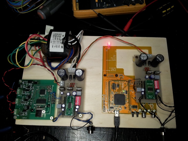

Very nice project Lorien! I am thinking of designing something similar like this using the XMOS chip. All I really want to to read the audio date from the PC via USB and the XMOS chip seems to have the software to do this without killing myself in writing software and driver I know little about hehe.
I want to do exactly what you have achieved... get the USB data to I2S or even SPDIF, but maybe not as extensive/high end as you have. Maybe keep my project below $50 and less components.
I want a good sound to come out of it but I think some of this jitter talk is making my head go crazy, either people have some super precise equipment and amazing ears or I am just deaf :/.
All i can do is pick some decent clocks and the XMOS in asynchronous operation and that should be good enough to mitigate major jitter, no?
I have 3 SACD players and one "Reference" CD/HDCD player (all pretty old) and I can't tell much difference between them... (except the one that costs $30 and weights 5lb lol).... sooo i dont think I can hear the difference in this case 🙁
I want something that will output good Stereo sound out of my PC.... somehting better than whatever comes out of the 3.5mm jacks on the back of my Creative X-fi.
I do have some noob questions on the XMOS tho, just so I gauge what I will need to do.
Since you've already done that can you tell me how easy/hard was to work with the XMOS dev tools and chip?
Did you mess a lot with the firmware on the XMOS chip?
How did you program the XMOS chip? You used their programmer/development kit?
Does your board output S/PDIF? Looks like it does

Why don't you just spend $30 on the Behringer UCA202 and be done with it?I want something that will output good Stereo sound out of my PC.... somehting better than whatever comes out of the 3.5mm jacks on the back of my Creative X-fi.
Your message makes it seem like cost is more important than quality, and there's no way you can build your own for less than established companies. Based on your account above, you'll never hear the difference.

Well I could go out and buy a $400 DAC that does everything and more but I'm an EE and I definitely want to develop my design skills and it wouldn't be much of a DIYAudio if i bought it lol
Well I do have nice "budget" equipment and my Playes are real good quality and I hope eventually when I get the rest of my system (Enery Take Classic Speakers and Onkyo TX-SR508 Reciever) replaced with some more high end stuff I might be able to differentiate better than now. There is a difference between players but it's not.... WOW THERE IS A DIFFERENCE factor but definitely my Sony and Denon have a really good sound stage!

No, I wouldn't say that quality does't matter to me hehe but I want to get my feet wet first and than optimize and get exotic with this board, and I didn't talk about the DAC and the other stuff that will follow on 🙂
I will design my own Hi-Fi system from the USB to DAC to PreAmp to AMP to Stereo Speakers. And when my tech is mature enough I will tackle SACD and CD player and keep upgrading my designs for higher and higher fidelity.
I've done two interconnect cables and already 70% done with my DIY Speakers (not counting paint job lol) and getting info on my next tackle.

I just wanted to explain my point that it makes more sense to design a reasonably high-quality DIY interface rather than something cheap.
I have designed many custom boards, and they're all expensive to make in small quantities. That's true whether the designs are cut-throat cheap or super high-end. Thus, my philosophy is that you might as well make DIY boards as high-quality as humanly possible. They're going to cost about the same anyway. Besides, cheap designs are churned out all the time by mass-market electronics shops, so you might as well let someone else spend the time making cheap stuff and focus your efforts on something a little better than average.
Where DIY folks tend to draw the line is with the number of layers and the cost of the parts. A few DIY designers try to stick to 2-layer boards because they're so much cheaper. Personally, I've done so many 4-layer designs with solid power planes that I'm not turning back to 2-layer unless the design clearly would not benefit (*). On the subject of exotic parts, I tend to like designing for multi-site and optional SMD placements. That way, budget-conscious DIYers can leave off the costly parts and still have a working design. When I was younger (before college), I learned a lot about electronics by taking things apart and noticing how many empty sockets (now empty pads) there are on commercial products. They do this to save on the PCB costs, while allowing everything from entry-level to mid-price to audiophile quality.
Long story short: I fully support efforts by the contributors to this thread to put as much design excellence as possible into this project.
(*) I wonder how possible it would be to have both 2-layer and 4-layer designs of the same schematic. That might allow budget-conscious DIYers to get in with the less-expensive 2-layer PCB while the high-end folks can compare the performance of solid power planes. Of course, this defeats the advantage of group buys for a single PCB design, but it's an idea...

RF PCB design is totaly different from high speed digital design.
We use a 13GHz scope to examine our high speed lines (DDR interfaces, ethernet etc).
The most important thing with high speed digital layout is keeping the impedances equal (around 50ohm single ended, 100 diff pair) and ensuring signal integrity, the best way to achieve that is to use SIV (signal integrity verification software) works with IBIS data available from most chip manufacturers. And lots of ground planes for return currents, and preferably all lines done as stripline routing (especially the higher speed ones) if possible.
90 degree angles are best avoided, 45 degree angles work perfectly, you dont need to do curved traces, it wont make any noticable difference and will make layout a complete pain.as noted, I use u.fl. But there are coax alternatives which do not make the right angle turn. I am curious what experienced RF design engineers might have to say about this. I have heard that pcb board traces are often purposely designed with gentle curves rather than hard right angles for high speed signals. How much difference these choices might make are fun to speculate about, but without some serious measurements, it really is just all speculation.

You know what....... excellent point! I guess I am just afraid to go all out on first try only to strike out with a nonworking design and hundreds of $ in wasted money.... but yeah PCB's aint cheap :/
So yeah.... what kind of clock does OP use for his design? I mean part number. Any PLL clock in the future?
Yeah it is a good idea to leave empty slots for higher end components, it will be like having two designs in one 😀 only that it will be much cheaper just to get it working with the basic parts and than add on 🙂

Lorien's WaveIO removes the clock inteference from the USB and converts to I2S, right? He achieves that via the XMOS asynchronous mode and running the XMOS as a master with it's own stable clock....
I read somewhere that they buffer the USB input and further remove any jitter or signal interference.
What the hell are GMRs?!? anyone have a part number for me or a datasheet? I cant find them on digikey... something to do with magnetic isoltion?
Ground isolation, any done on WaveIO?

@ zxgravediggerxz: There are a lot of manufacturers that are using XMOS chips in their designs. I just wanted for WaveIO to be a good alternative to
stock board provided by XMOS at the same price. I do confess that at the beginning I didn't took into account the fees paid for money transfer, shipping. so I am where I am with the price. And, like rsdio I don't see me going back to 2-layer boards even if I wanted to...
My experience with XMOS firmware is.. rather limited even if I have more than 10 years experience in uC programming. The firmware is.. how do I call it... fragile. Any important changes into it has caused BSoDs to my laptop so I tried to keep it as much as possible close to the original form.
On the other hand, there were no one for me to give any advices on how do I have to do with XMOS to reach my goal other than XMOS itself. All your questions will find the answers there, just make an account and ask.
Your goal in essence is noble but going cheaper will not bring you performance unless you are really know what you're doing and this task is rather a time consuming one (at least in my perspective). I also have this in mind... but in my case it will show-up in a different form. I'm in process of designing it, hoping it will work at the end 🙂
