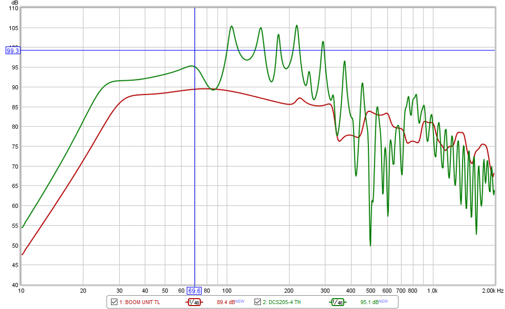

I came across this tapped horn design a couple of days ago:
Inexpensive entry to the world of Tapped Horn subs... -
Techtalk Speaker Building, Audio, Video Discussion Forum
Any advice as to whether two of these might be a good choice for mainly hifi listening in comparison with more conventional sealed or bass reflex mounted drivers? This small tapped horn design appears to get quite “low“ with small drivers.
That TH design is 119 liters net (that's big for one 8" driver) and has a passband output at looks to be only 3dB or so more than the output of my "Boom Unit", which is a TL designed around that same driver, that takes up 26 l net and has a wider usable bandwidth with no 10dB out of band peaks to deal with. The "Boom Unit" serves as my multimedia subwoofer.
For HT use, if I had that amount of space available for my use, I'd go for a vented or TL design based on a larger driver, for more linear output capability.

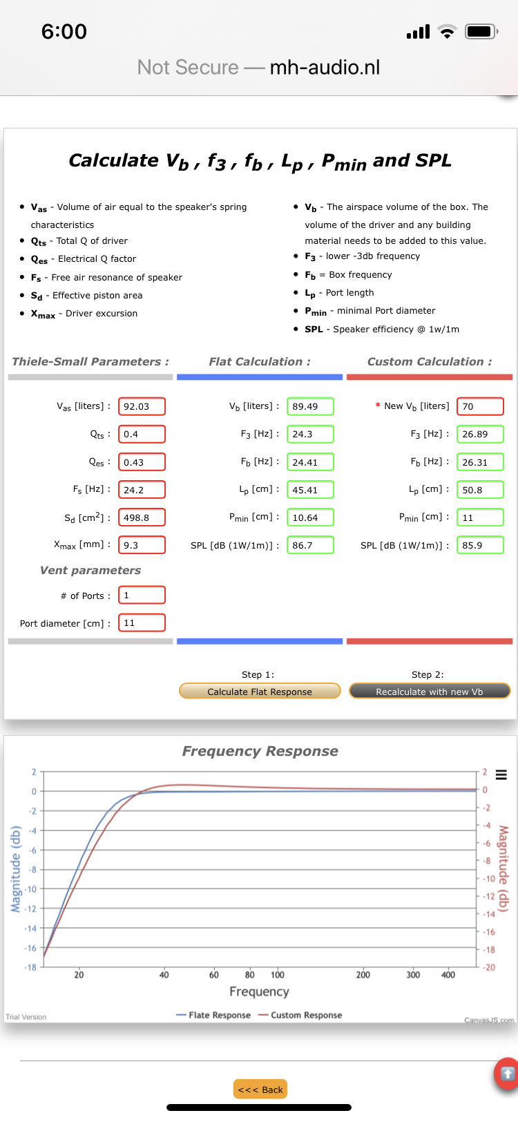

I’m heading toward a pair of DA DCS305-4 12” drivers in 90 litre bass reflex enclosures. Should be ok.
Out of interest. How far off a flat response is it ok to go before it’s noticeable? See attached. I reduced the box volume by about 20 litres and the simulated response rose by less than one decibel.
1dB changes won't be noticeable IMO.
It's worth grabbing a measurement mic and seeing how much of a mess the room can make of a carefully-tuned subwoofer.
Chris
Chris
Thanks Chris. Yes, I suspect my wooden floors, walls and 10ft ceilings will mess things up a bit..
