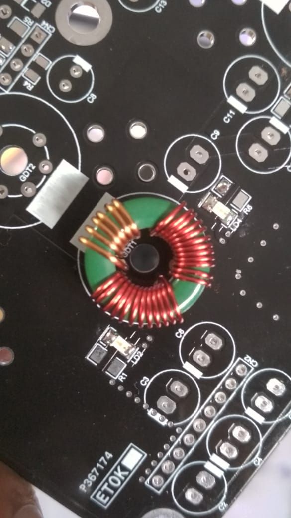

I use my own floating isolated supply based on toroidal ferrite core which gives less than 5pF isolation capacitance between secondary and primary. Both Hi & LO sides are powered this way. This way the reliability goes up and things get simple to tune like one can adjust the real time dead-time, gate driver charging rate of both sides without even connecting the main rail voltage bus. You just have to feed the gate driver with a square wave signal of your choice to reveal the outcome at the mosfet gates in order to fine tune the drives. This is how industrial motor inverter gate drives are configured using IGBTs.
With bootstrap option there is a considerable difference in amplitude of both gate drives [HI side is always less than LO side amplitude in real world conditions acquainting the fact that the charging of Hi side capacitor happens thru LO side Mosfet and its RDS based voltage drop causes the gate drive to get lessen by couple of volts or so, when it is conducting several amperes of current in real world applications, which leads to uneven heating of mosfets], which is not the case here. You get same amplitude gate drives,which means symmetric rise and fall times at switching output node during dynamic behaviour and No fear of 0 or 100% modulation time interval causing boot capacitor charge failure.

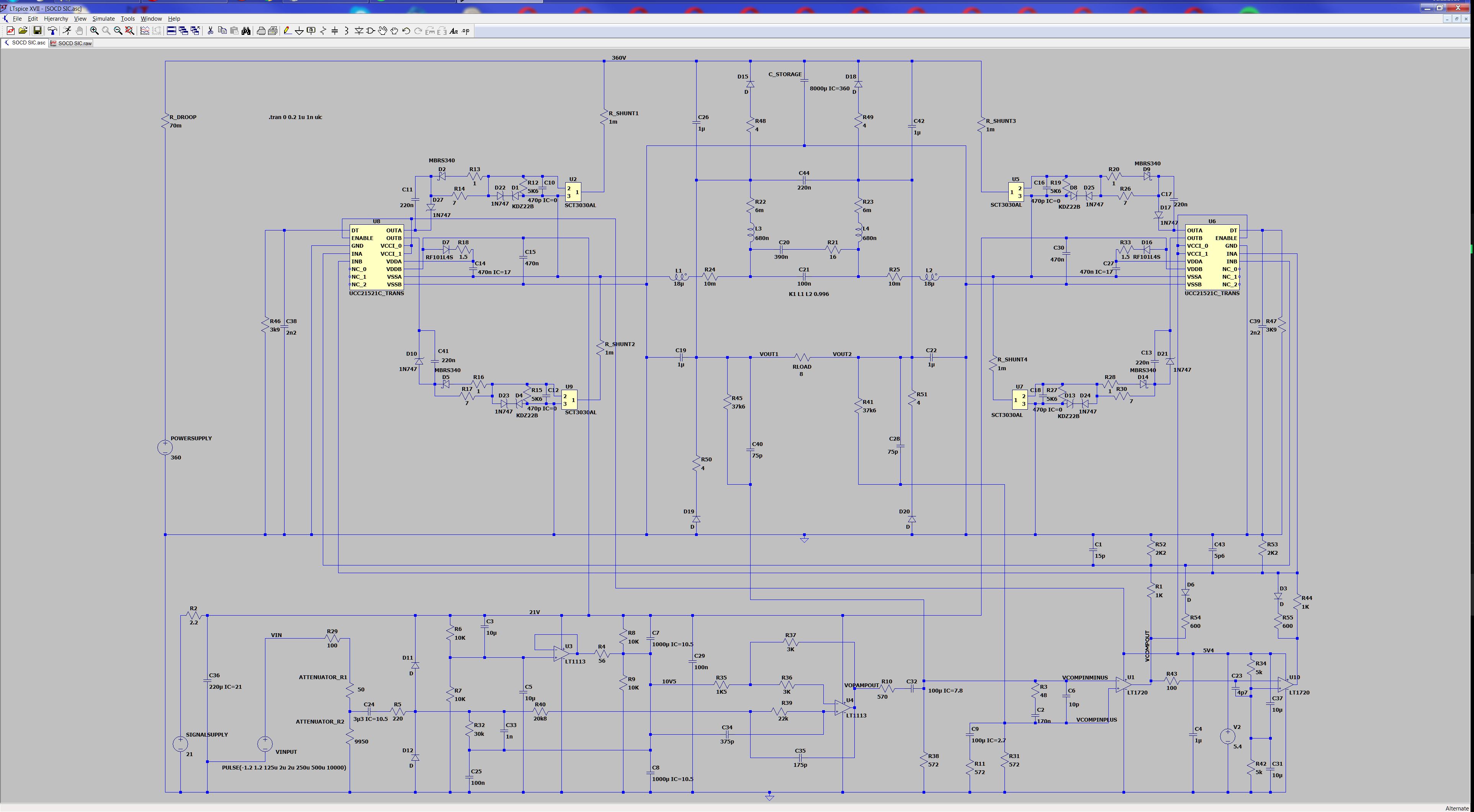

@kASD: I know the advantages of floating supply. But the disadvantage is added cost / complexity. So my idea was to "get away" with charge pumping. My sims show that it more or less is working. I ll post my current sim file soon when I am done for today (and done for this year 2018).

So the only way to get a working 3V6 zener in LTSPICE was to take the standard.dio, copy the 1N750 model into a new line, change the name to 1N747 and the parameter from 4V7 to 3V6. Saved the new standard.dio and - Working!
The gate voltages start to look somehow "useful" - I m having progress!
Pulse skipping will save switching losses during high power transients.

Anyway, attached you can find the current 2018's final status of SOCD SIC.
(As you can see I have a 4K desktop, an I ll never go back to anything less)

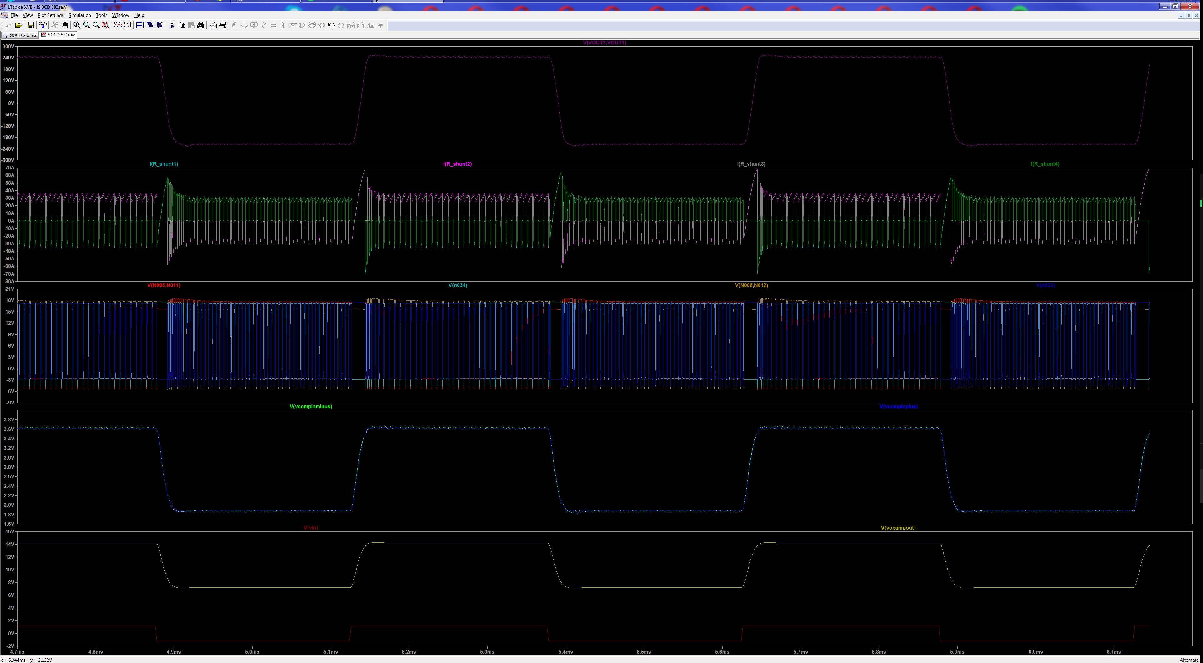

Last post for 2018 (I promise, as long as there is nobody talking back or asking!).
->Topic: Square wave step response. I fed a 2KHz signal to the amp with a steepness way beyond ANY audio signal bandwidth (2us rise and 2us fall time).
Attached the result: 6500W RMS power into 8 Ohms with no ringing and (almost) no overshoot!!
Happy New Year 2019!!

Hi Michael,
Happy new year🙂
I use the transformer at 500khz with fixed dutycycle of 50%, just to power the gate driver chip at high and low sides at 15VDC. It doesn't serve as the gate driver directly. It's role is of isolated DC-DC converter only.
The rail voltages in half bridge range from +250/-250VDC and some times in a full bridge upto 400VDC.
I am in love with these small transformers,they do wonders whether it's a gate driver supply or powering an isolated current sensor they keep the system ultra reliable and very simple.
