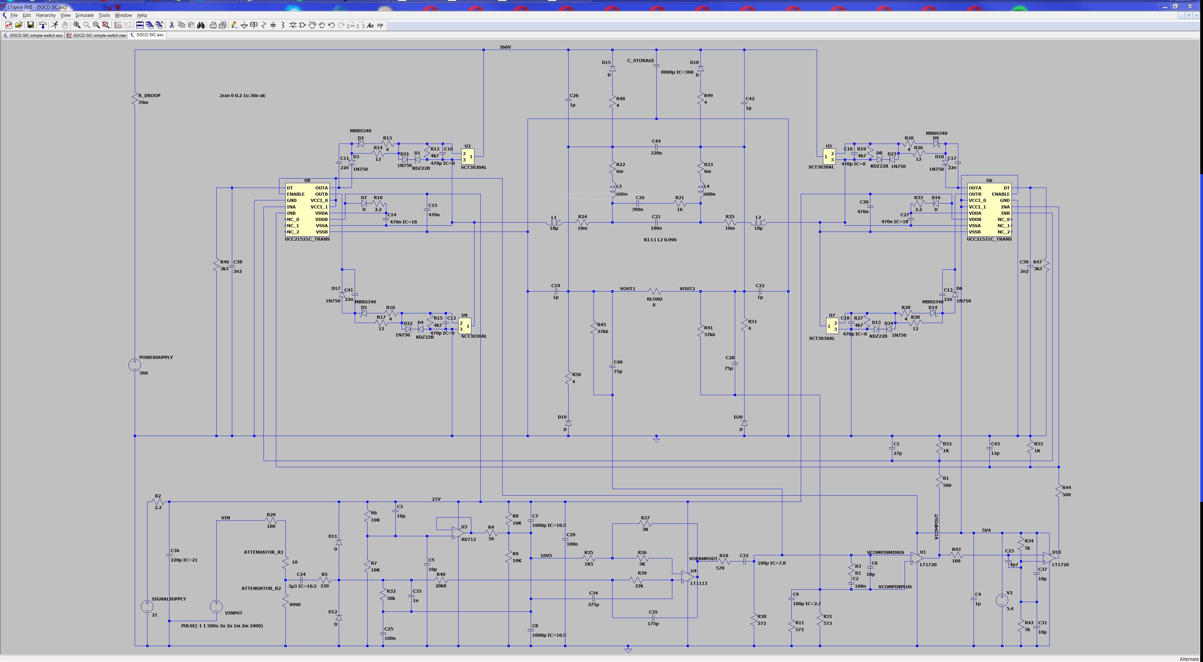

I have been staring at an LTSPICE screen for many hours with the final result "time step too small". Need help!
Goals: Self Oscillating Class D SOCD SIC with 7.5KW into 8 Ohms using SICs and 1 x 360V supply (the cooling is another story!!)
4KW into 4 Ohms or 16 Ohms
Whole impedance range of 4 - 16 Ohms with clean step response (fast rise time, almost no overshoot, ...)
The usual 20 Hz - 20 kHz BW, self oscillating, 100% stable under no load and capacitive load.
Not sure if my charge pumped gating concept with slightly negative off state voltage will fly - simulation does not converge.
Quite much for a few days off?
Look at my next post for the current schematic...

Why there is no common mode error correction?
I really liked your gate driver model, mind sharing it...?
Any ideas how to get the simlation running? I think it is the drivers that cause the convergence issues.
What is your opinion about the charge pump gate concept?
Ups I found an eror in the schematic: VSSB of U6 must be connected to GND of course, not to drain of U7.
I don't like charge pumps for high side, I always implement floating isolated supply for high side, its so easy and reliable in my designs
Share the sim file and the driver if you want others to help you out
The sim is running now, since I found and fixed the schematic error! It is SLOW, but I got already a few hundred microseconds.

Just replaced the 4V7 zeners by more appropriate BZX3V6. I 'll upload all the *.lib files in zipped form here. Unfortunetely, the LTSPICE does not "like" the BZX3V6, so it is all convergence errors again.

BZX55C3V6
Put "*" before "BZX55C3V6".
Back to 4V7 zener. the negative gate voltage will be a bit high comapred to ROHM's -4V abs max rating. Not sure if that low rating is real.
Noticed some subharmonic oscillation tendency at high excursion. Reason is the comparator does not switch in time if too low overdrive is present. In contrast to the usual gradual frequency drop as the voltage approaches rails, here the frequency will suddenly jump to half. The solution is to increase the impedance of RC between the inputs of the main comparator, hence to increase it's overdrive, at the expense of loop gain.
