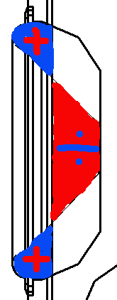

The formula for a cone volume that is 11 inches around and 4 inches high is 126 cu inches-about two liters. throw in the volume of the basket rungs and you have 2.5 liters.
So you only have to increase your box volume 2.5 liters-less than 10% of a 1 cu ft box.

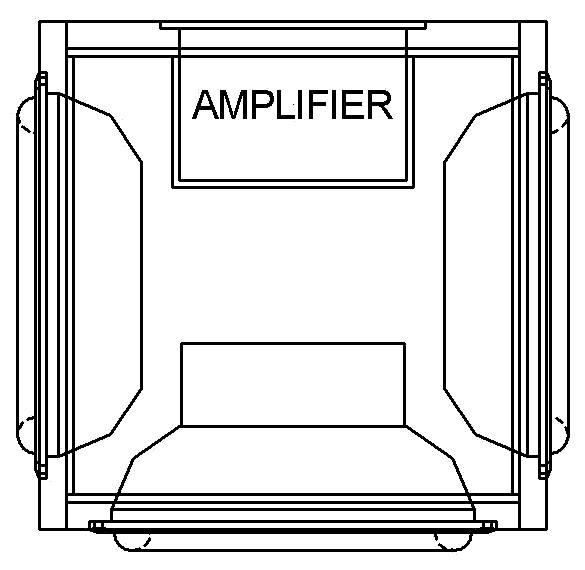

Do me a favor-what are the outside dimensions of your box and what thickness of materials did you build it with? Also, if you have the dimensions of your sub amp that have attached, please give them also. If you don't have the sub amp dimensions, just tell me the approximate power-they are likely to be equal to other sub amps in size.

Hi
If you use your old box I think you can forget about adding volume. there will be almost no difference if your box is well build (thick material). See pic below.

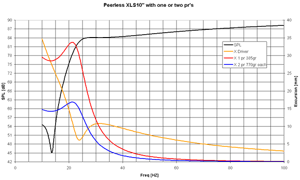

A little more detailed description of my problem seems to be necessary: When running the sub at high SPL’s I get very large excursion in my PR, that’s why I would like to use two of them.
Kelticwizard:
The net volume of my present box is 27 litres. And it will still be in my new one. My problem is how to tune the two radiators. I imagine they should be heavier then today’s 385 gram. What I’m thinking about is the analogy to a ported box, if you have a box with a specified port and you want to use two, to lower the speed, you have to make them longer. Shouldn’t my radiators be heavier?
You asked about my box and amp. The box has outer dimensions of 366x366x366 mm, the material is 5 mm steel and 18 mm pinewood, internally the box is braced with ø8 mm steel rods. The amp is a Hypex HS 200, which is placed outside the box.
Keld:
I have downloaded the software (Thanks) and simulating my driver and one 385 gram PR in net volume of 27 litres makes very large excursion under 30 Hz. Mechanical Xmax is +/- 22 mm for the PR so problems do occur approaching 25 Hz, so my apprehension seemed to be correct, maybe. Simulating with “Minimal leaks” and “Minimal fill” (I guess the rods will slower down the air in the box a little bit) I get an Fb of 23.68 Hz. When trying 2 PR’s and aiming for this 23.68 Hz the weight of the PR’s is exactly doubled 770 gram each. Can’t really be a coincidence, doubled “piston area” doubled mass? Or?
In the plot one can compare the excursions for the single PR and the double PR designs. The SPL and the excursion for the driver remains the same.
Kelticwizard:
Keld:
