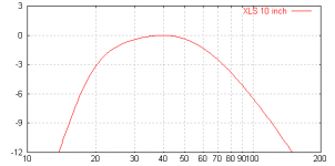

The sub is in a 29 liter box. Net volume, I'm figuring, is about 26.4 liters. (Good guess?) I bought a PartExpress plate amp with 6dB boost at 30 Hz. (Seemed like a good idea at the time.) But playing around with the new software, it looks like I might be better off with an amp with no boost at all. The downside (snort) would be that to get the crossover point in the right position, between 70 and 80 Hz, I would need to turn up the volume and set the crossover to 50 Hz rather than 75 or so. The lowpass rolloff would therefore be reduced from 12dB/octave to maybe 9dB/octave.
My question: Is that acceptable?
See the graph below.

I built a sub using the 10" XLS and PE sub amp and it certainly doesn't need any boost. Just change the 2 resistors in the PE amp to disable the boost....... details should be with your instructions.
Really I can't see what your problem is............ adjust away and will sound much better than with the boost. Give the software the flick and check with the ears.

Perhaps I did not explain it well enough. If I change the resistors to make the amp play flat, then in order to get the combined response of the system flat, I will have to set the nominal crossover point about 1/2 octave lower than the actual crossover point. That will yield a subwoofer high frequency rolloff of only about 9 dB an octave. I am asking if that will prove unacceptable.

I'll check with the ears, but I'm not going to give the software the flick. It's good stuff.

I think I've hit on a solution employing my AudioControl Richter Scale bass management unit.
The mains are ported, and start to roll off at around 70 Hz. They are down 6dB at 50Hz according to Martin's Mathcad worksheet. The rolloff is -- what? -- 24dB an octave? Effectively, the rolloff of the sub amp's nominal 12 dB low-pass is only maybe 10 dB, because the unequalized sub has a rising response in that range.
Soooo.... I tried running the sub using the Richter Scale, which has a Linkwitz/Riley crossover with a 24 dB/ octave rolloff.
Well folks, however I set the crossover knob on the plate amp (within reason), it sounds reeeeally good, although the Richter Scale is set up to roll off at 90 Hz. Before, if I turned the sub up enough to get the bass flat in the 30-40 Hz range, there was some muddiness in the deep male voices and so forth. Now I can get plenty of low bass without that problem. I think I'll change a resistor in the Richter Scale to put it at a lower crossover point, which should help a bit more. I'm not sure exactly what frequency to select though.
