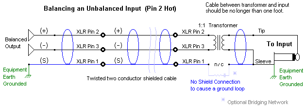

Here is a summary which represents the facts as I've researched them. When connecting a balanced output to an unbalanced input the rules are:
1. Impedance balanced outputs - cold can either be left floating or connected to the shield.
2. Active balanced outputs - cold must be left floating.
3. Transformer balanced outputs - cold must be connected to the shield.
In all three cases, the shield is connected to pin 1 of the XLR.
A versatile device!
It utilises a transformer, which is a more effective way to convert balanced to unbalanced, but more expensive than a simple interconnect cable.
It's based on this:

That resistor is completely unnecessary. It seems, looking at the innards of your unit, it's a simple op-amp driving setup and obviously no transformers.
So, if you're going to make your own cables from a simple coax, use Pin 1 and Pin 2 and wire to the RCA connector and leave Pin 3 floating. Job done and good enough.
Dave.
I can't agree with Davey enough!!
Provided it is NOT a transformer balanced output then simply connect XLR pins 1 and 2 to the RCA plug and leave pin 3 floating.
P.S. If this interconnect causes hum then disconnect the shield at one end of the interconnect, either at the XLR end or at the RCA end.
Also, the interconnect should be as short as possible to mitigate against picking up noise.
Breaking the shield at one end of the interconnect is only necessary if hum and buzz turn out to be a problem.
If the devices at either end of the interconnect are connected to different power sources (mains outlets) then a potential ground loop is created. If the ground potential at the source end is different from that at the load end then hum and buzz is the likely result.
The solution is to cut the shield at one end. Some sources say it's better to cut at the high impedance (in our case RCA) end.
If it is a requirement to have both ends grounded, then placing an HF filter in the shield can help to avoid any noise.
This entails placing a 'bridging network' across the shield gap. The first interconnect diagram which I attached on page one shows an optional bridging network consisting of a resistor in series with a capacitor. However, no component values are given.
Scottjoplin suggests placing an approximately 10 ohm resistior in the gap. Perhaps he can explain his choice of resistor and in what way it would be effective.
At the end of the day, it is easier to steer clear of this type of filtering by simply grounding one end only.

It's worth stressing at this point in the thread that we are discussing a transformerless, balanced to unbalanced interconnect cable. Probably I've over discussed it, but here I go again!
I have looked at the references and it would appear that hum issues depend, not only on the safety ground arrangements of the equipment, but also on the exact mechanism (and there's more than one!) behind the interfering noise.
One important safety precaution: NEVER remove an equipment safety ground where fitted!
If the source and destination equipment each have safety connections to electrical ground via their power cables, then a simple break in the shield conductor at the destination end should be sufficient to remove any hum. Signal return is provided via the equipment ground connections.
There are other equipment arrangements which may require a 10 ohm resistor to be inserted into the break in the shield. The resistor contributes by maintaining sufficient ground continuity while reducing the hum.
Thanks to the other contributors who pointed the latter fact out!
I've not come across that remedy before. What can be done is take a cable from the source chassis, run it close to the interconnect and connect to the receiver's chassis. Then disconnect the power lead earth of the source.
