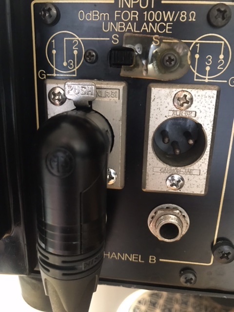

So, given the way that this XLR has been wired (pin 2 hot), should it be plugged into this socket and should the switch be in the position shown in this photo?
Previously I used a "Hosa GXR-135 Adaptor XLR male to RCA” that has pin 3 as hot and pin 1 as ground and it worked perfectly well.
Plugged in the newly soldered XLR and there’s no signal or sound coming through.
I’m sure it’s an obvious mistake so please be kind...

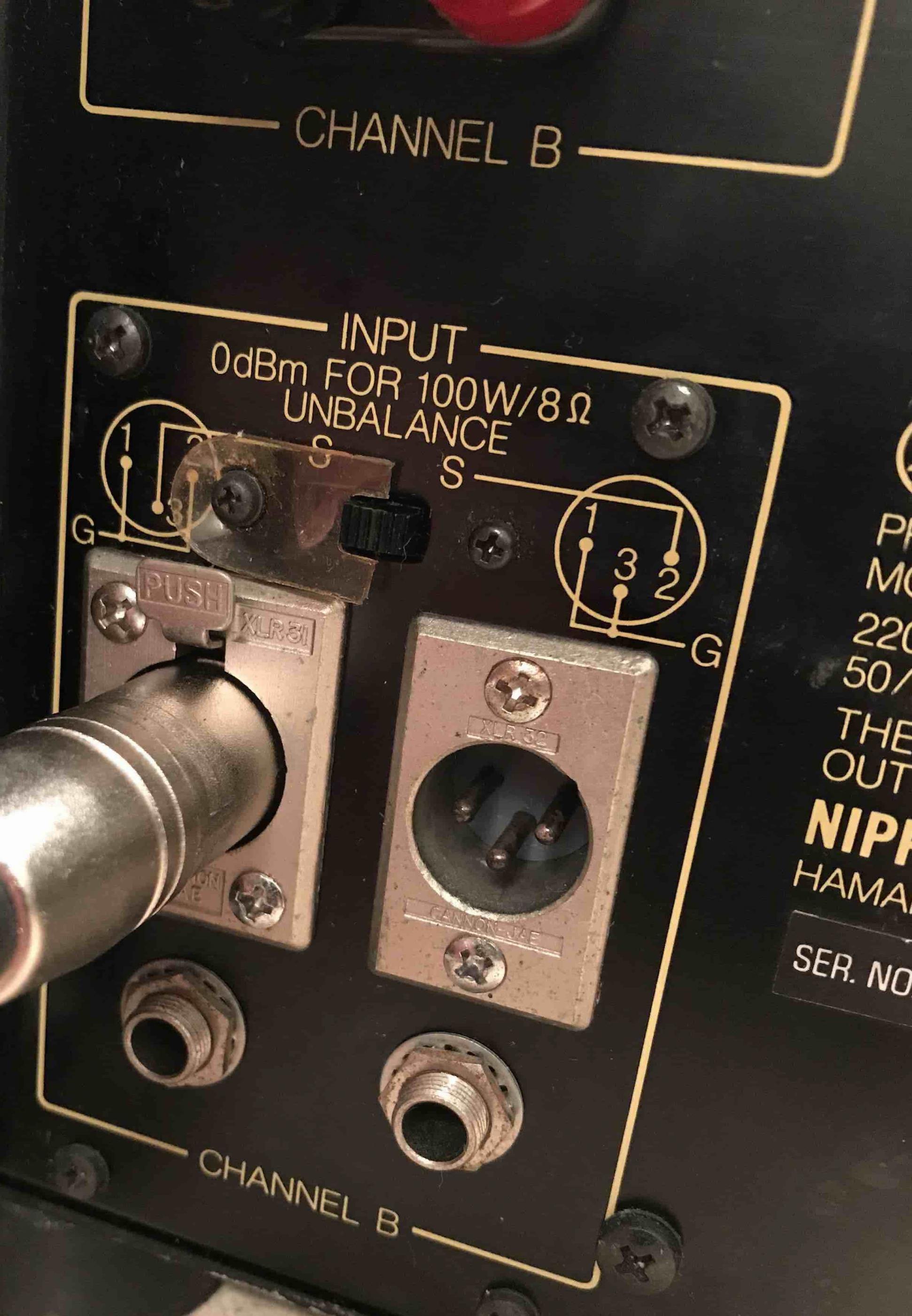

I presume this is a phase selection switch. So Switch it to the right (Standard is HOT signal on XLR pin 2).

Moved the switch on each channel.
Testing one cable (and checking functionality on Channels B’s output XLR socket) there was a signal present and sound came out of the speaker connected to the Yamaha P2200 with volume pot at max but when the preamp is turned up a little the sound starts to distort, especially noticeable in the lower/bass range.
Plugging the same cable into Channel A, no sound comes through and the meter needle doesn’t move at all.
This didn’t happen at all when I simply used a Hosa RCA to XLR adapter plug.
Then plugged the XLR back into Channel B and there’s no signal or sound output coming through, rechecked Channel A and still no sound.
About to delve back into the XLR plug. But what’s probably the best thing to change?

Thanks everyone for your help on this, here’s an update..
So wiring a male XLR plug, the following arrangement is working for me.
No audible noise or hum.
XLR plug:
Pin 3 is hot.
Pin 1 is connected to both the ground wire and the copper braided shielding.
Inside the plug, Pin 1 has a short wire connecting it to Pin 2.
RCA plug:
Pin is hot.
Sleeve is connected to both the ground wire and the copper braided shielding.
Slide switch is pushed to the left on both channels.
XLR plug:
Pin 3 is hot.
RCA plug:
Pin is hot.
Your's is the way the drawing shows for the left handed XLR receptacle. And it's a rather unusual one. Even in an unbalanced XLR connection the hot wire is usually assigned to pin 2 (XLR teardown: 1 = Xreen, 2 = Life, 3 = Return), according to the right handed receptacle drawing.
Best regards!
Edit: I don't see that much use of this switch. What else does it do than switching the related recptacle to the amp circuitry? Why not just leave the unused input open? Who knows?
Best regards!
