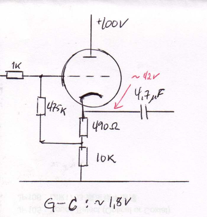

First question; it has a 6922/E88CC/(6DJ8) output buffer, (cathode-follower), how do I improve this?
It has a regulated plate-supply of 100V, can be increased to 120-125V, (with added zener), and still have regulation, (132V after bridge).
