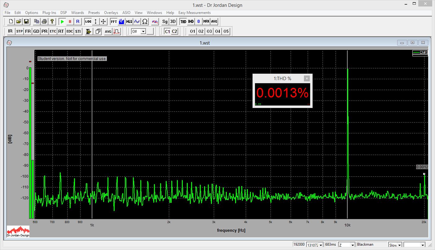

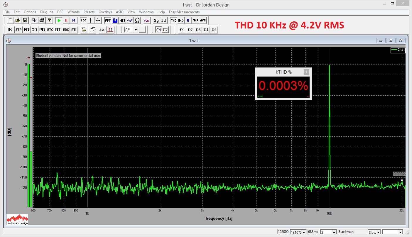

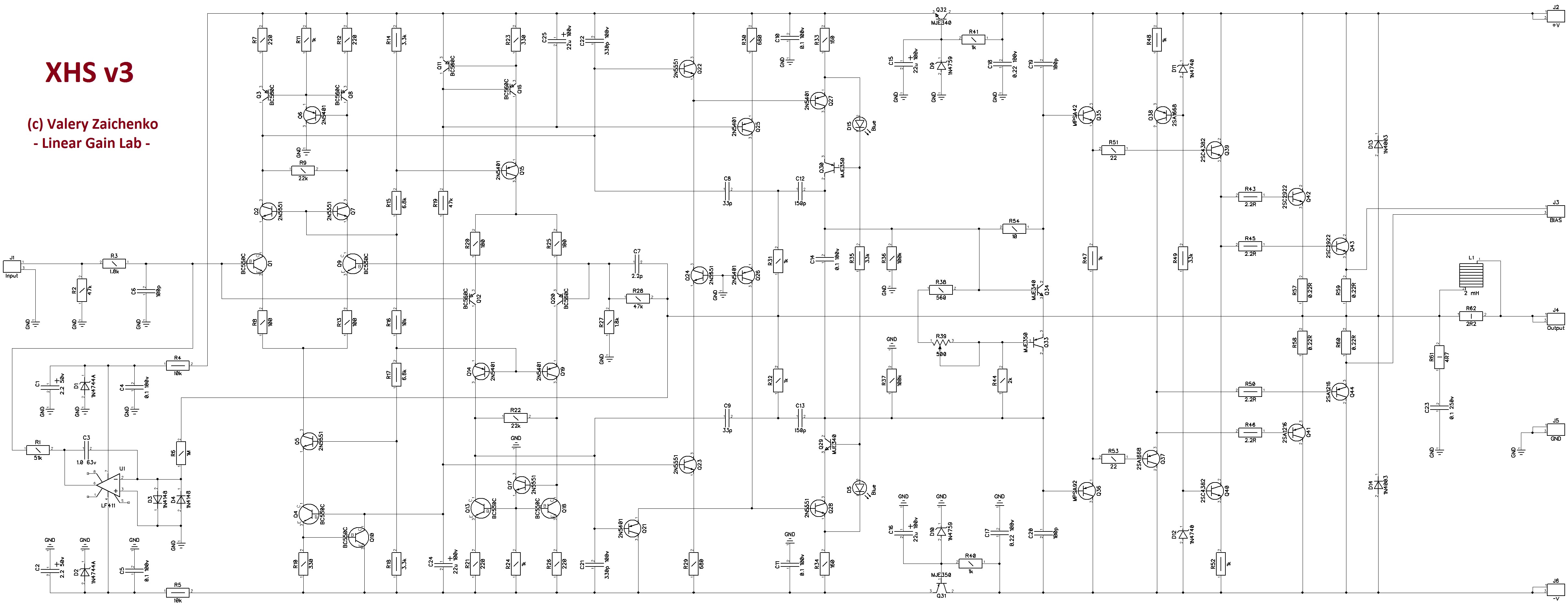

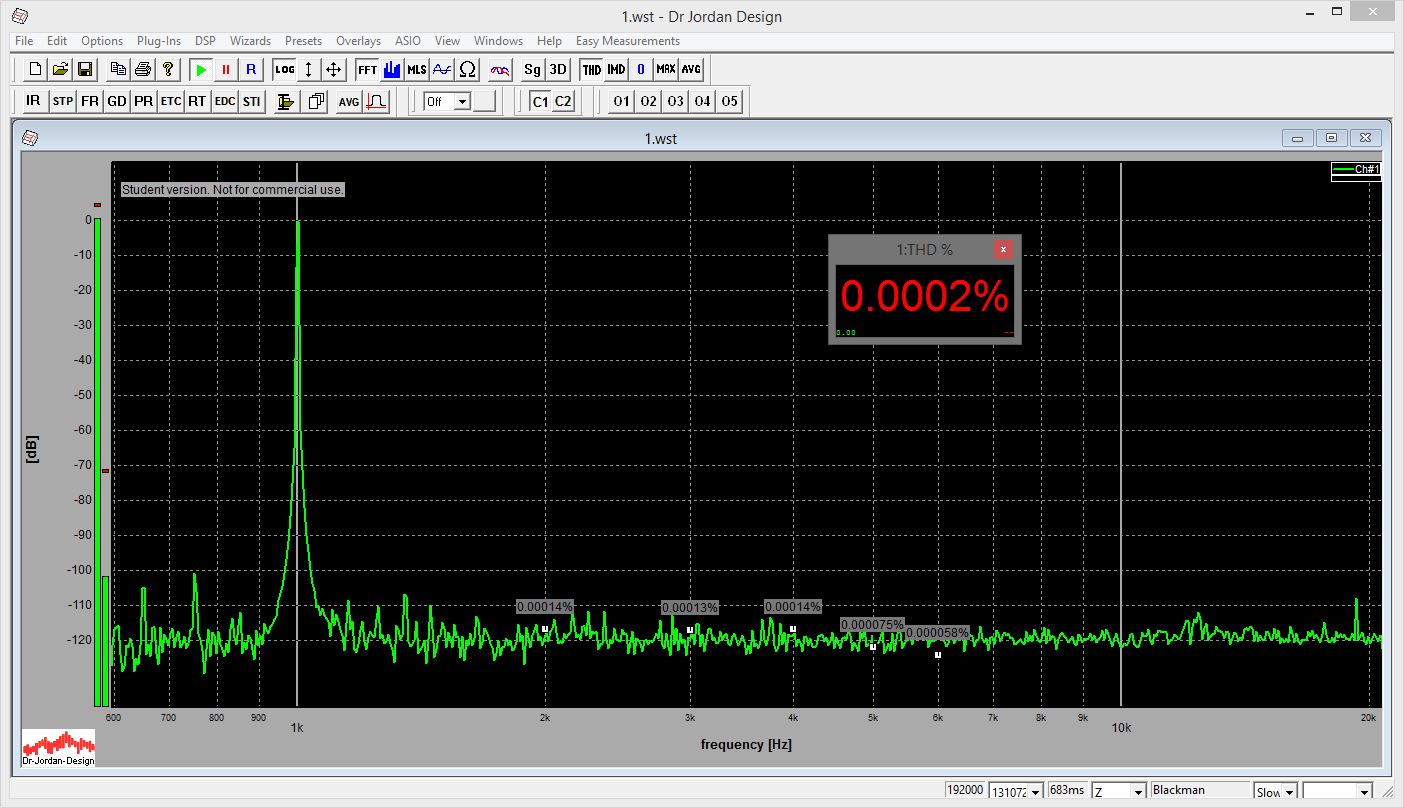

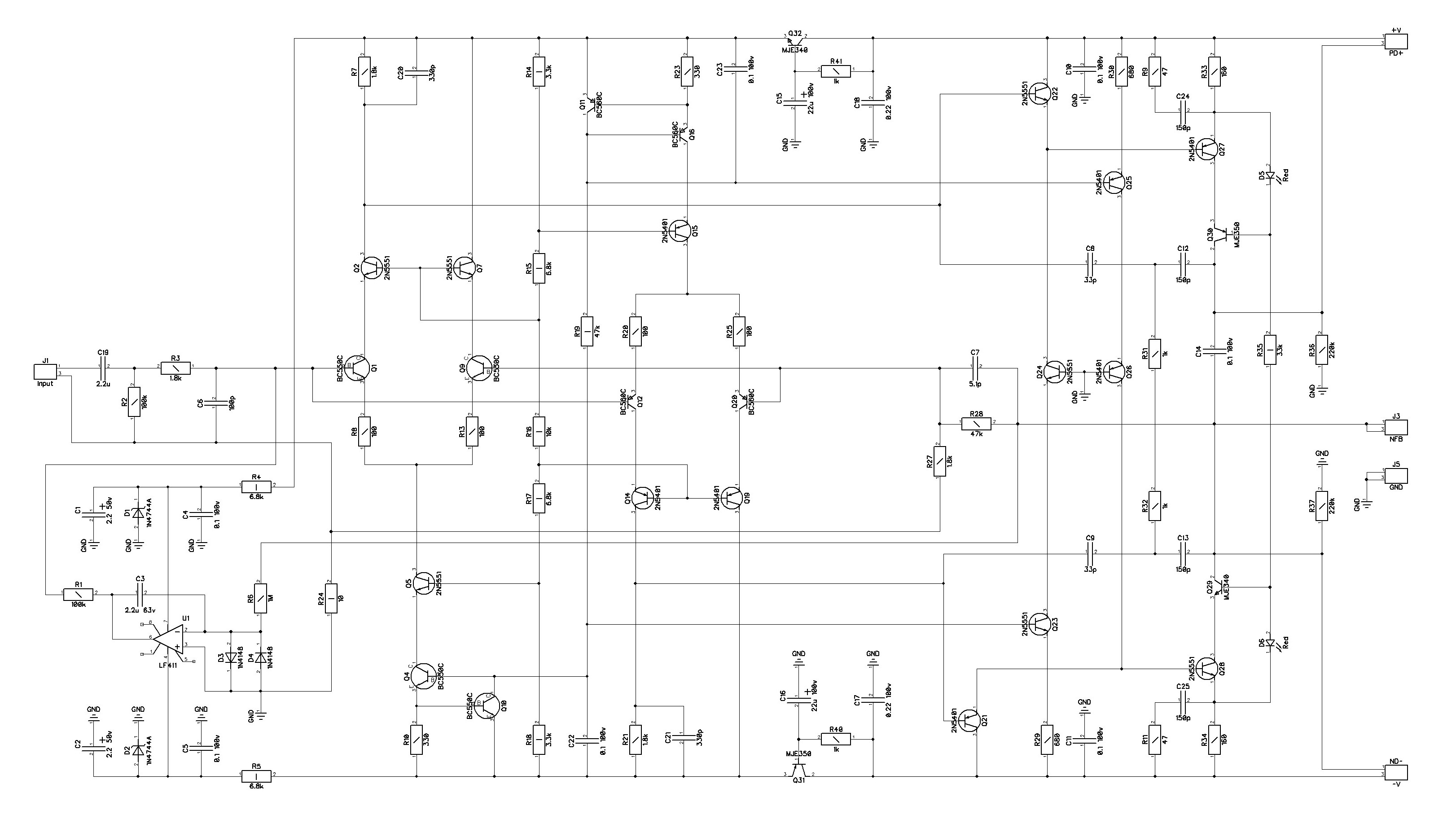

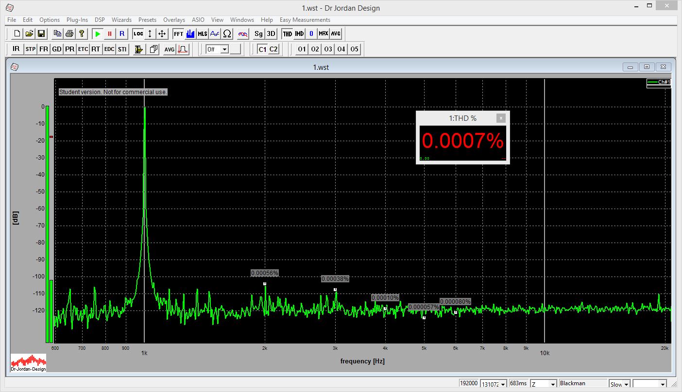

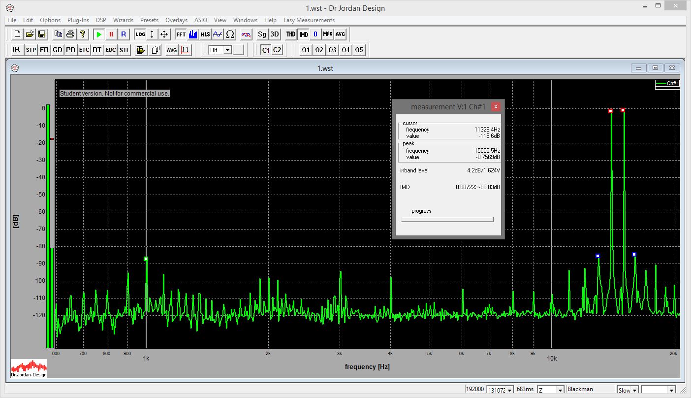

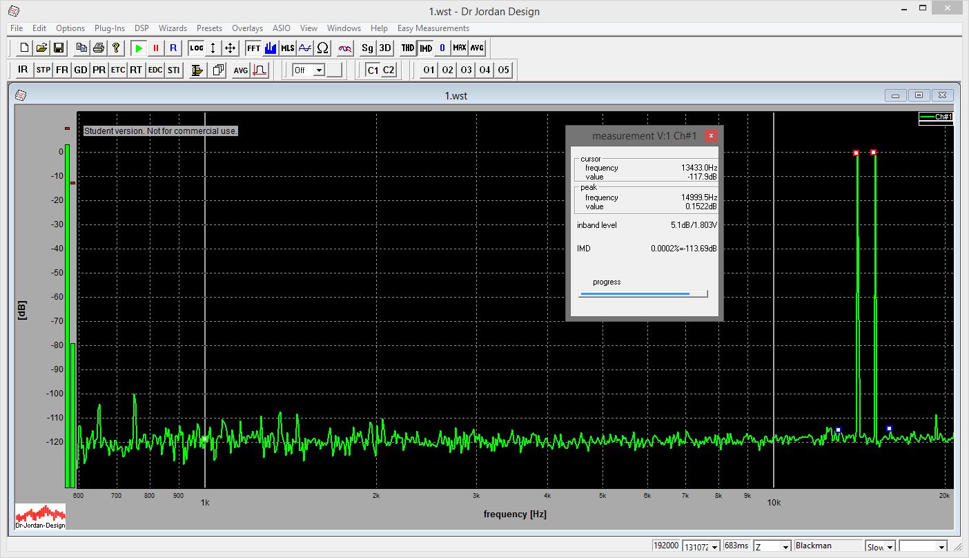

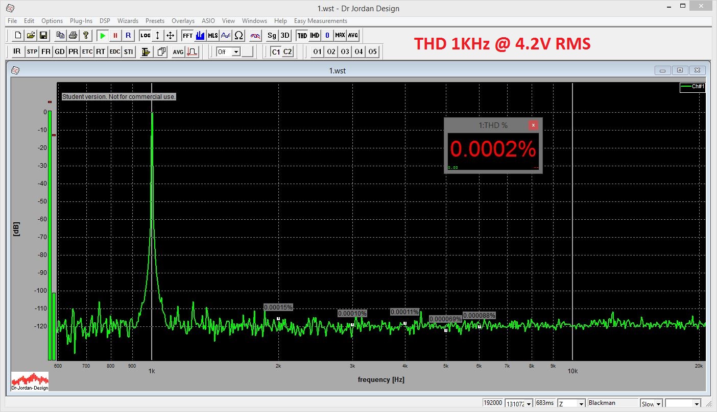

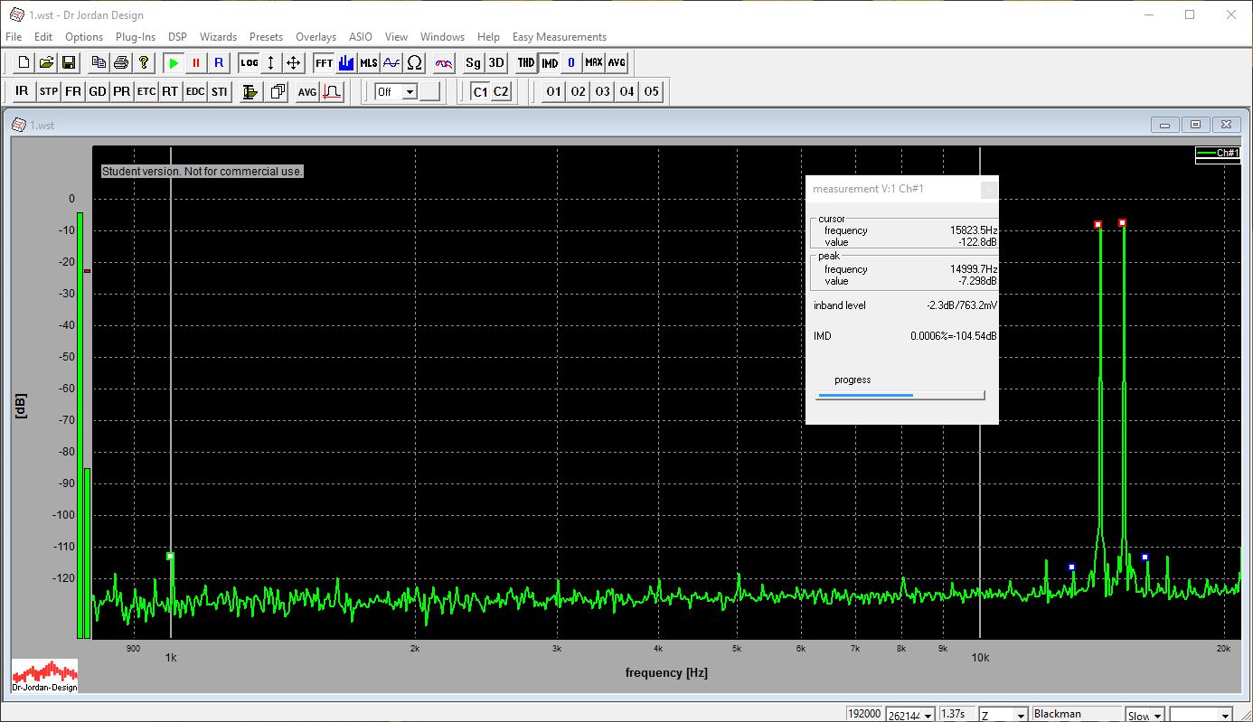

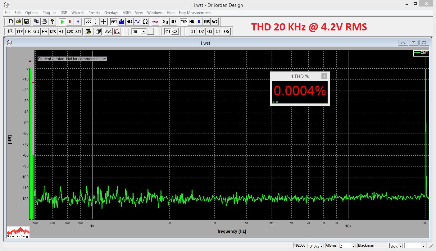

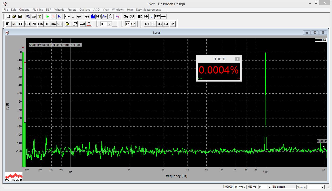

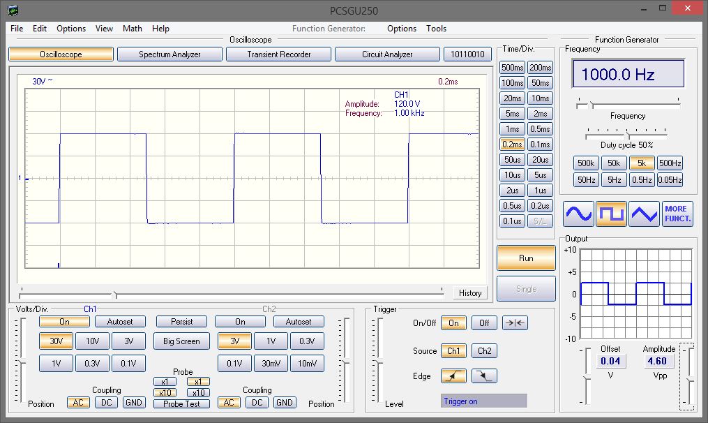

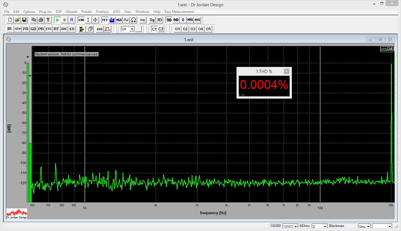

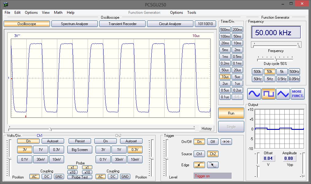

XHS - refined, IPS measurements (v3) - many pictures

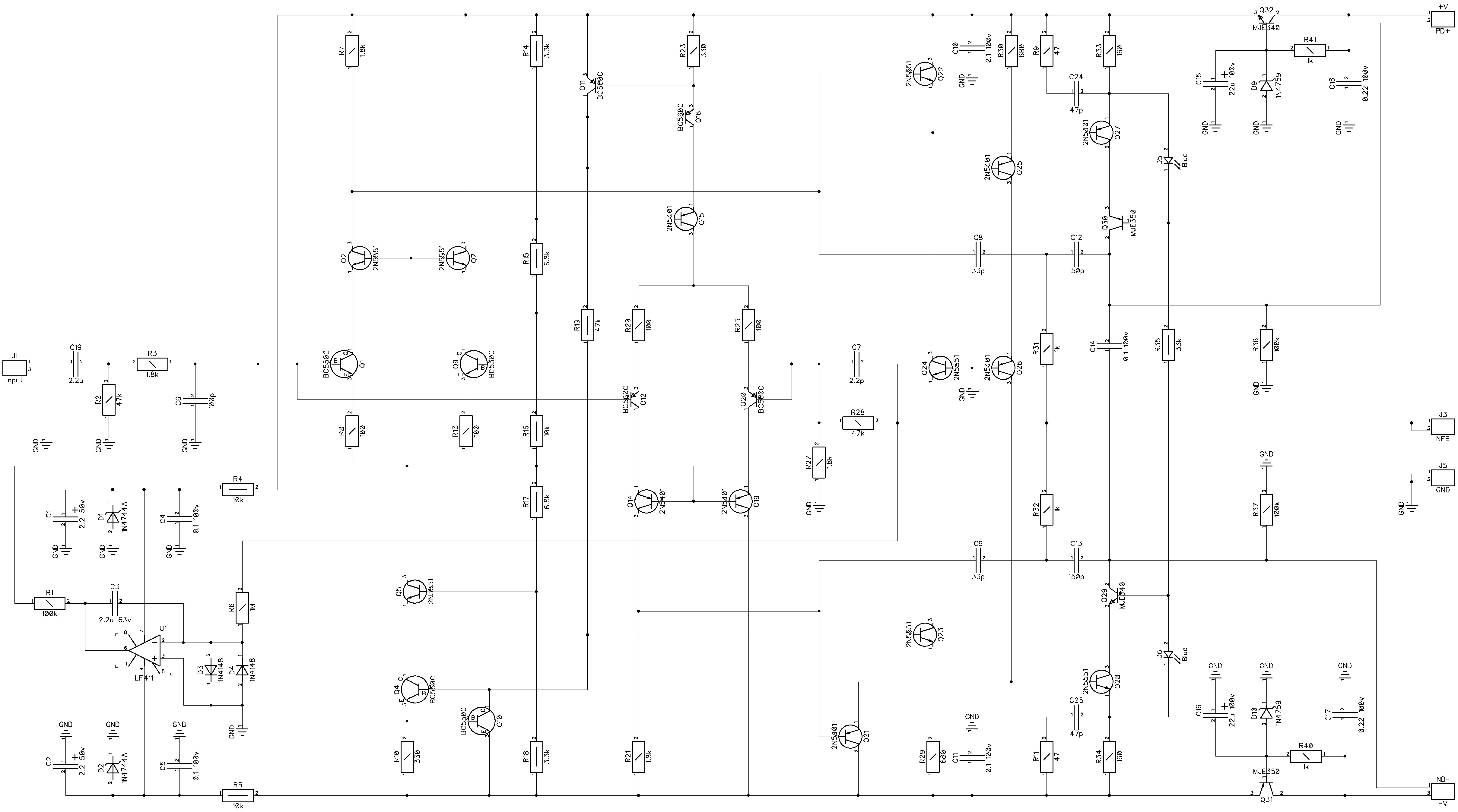

Coming back for a minute to my relatively old 🙂p) super-symmetric design (January 2014).
Slightly refined schematic and some values - more common mode stability, fine-tuned square wave response.
I was thinking about adding a real CMCL here, but after some practical testing it is clear that helper transistors in LTPs keep the VAS quiescent current stable enough (at around 6.5 mA) - very light fluctuation exists, but at the scale nothing to worry about.
Measurements are performed with IPS only - OPS is temporarily disassembled some time ago.

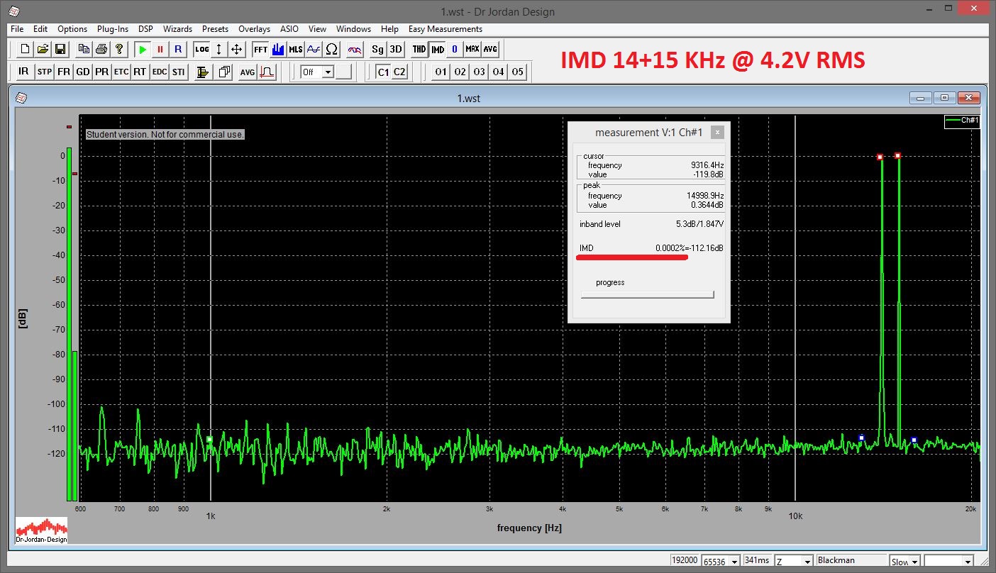

THD and - more important - IMD are close to my measurement system limits.
Harmonic components are practically masked by noise at around -110db level - this is a virtually "no distortion" IPS.
I will re-assemble OPS soon and re-measure and run listening tests in the nearest future. FUN! 😉

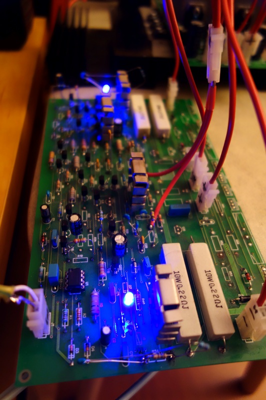

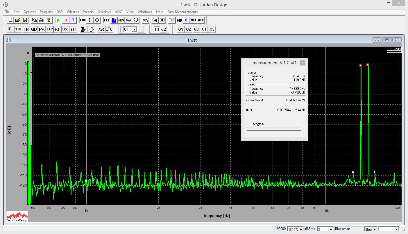

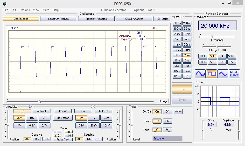

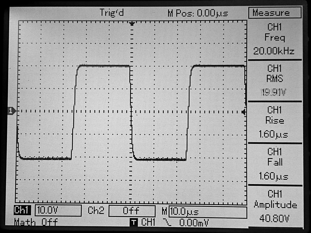

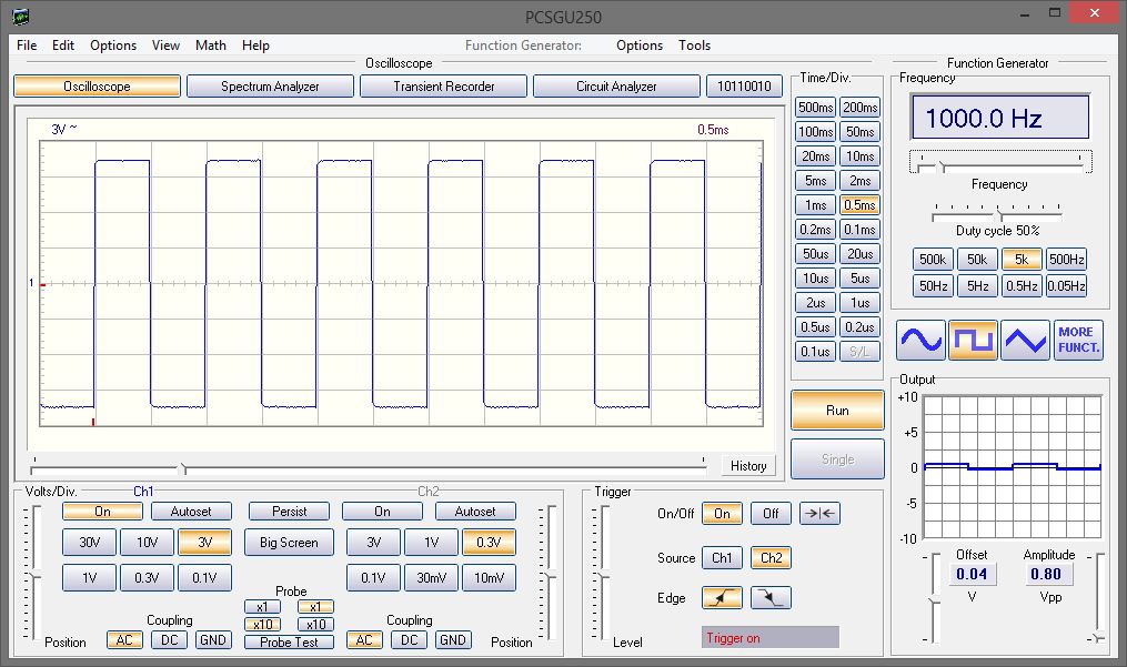

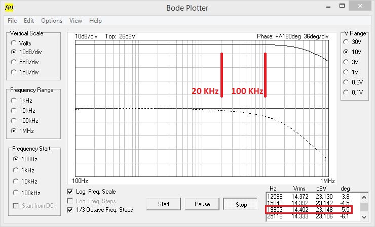

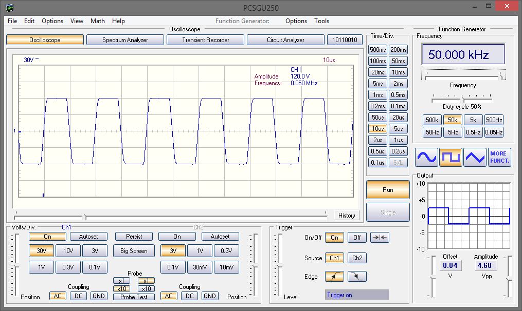

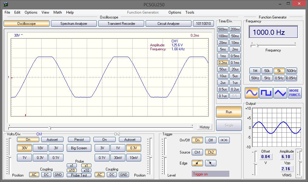

Final version - v4
Final update. Removed LTP mirrors, improved compensation.
Measurements are still at the edge of my measurement system capabilities.
Excellent, rock stable, virtually "no distortion" symmetric front-end, using very simple, widely available components.
Very good clipping at 125V p-to-p (see attached).
PCB at standard 4"x3" size will follow soon.
Valery

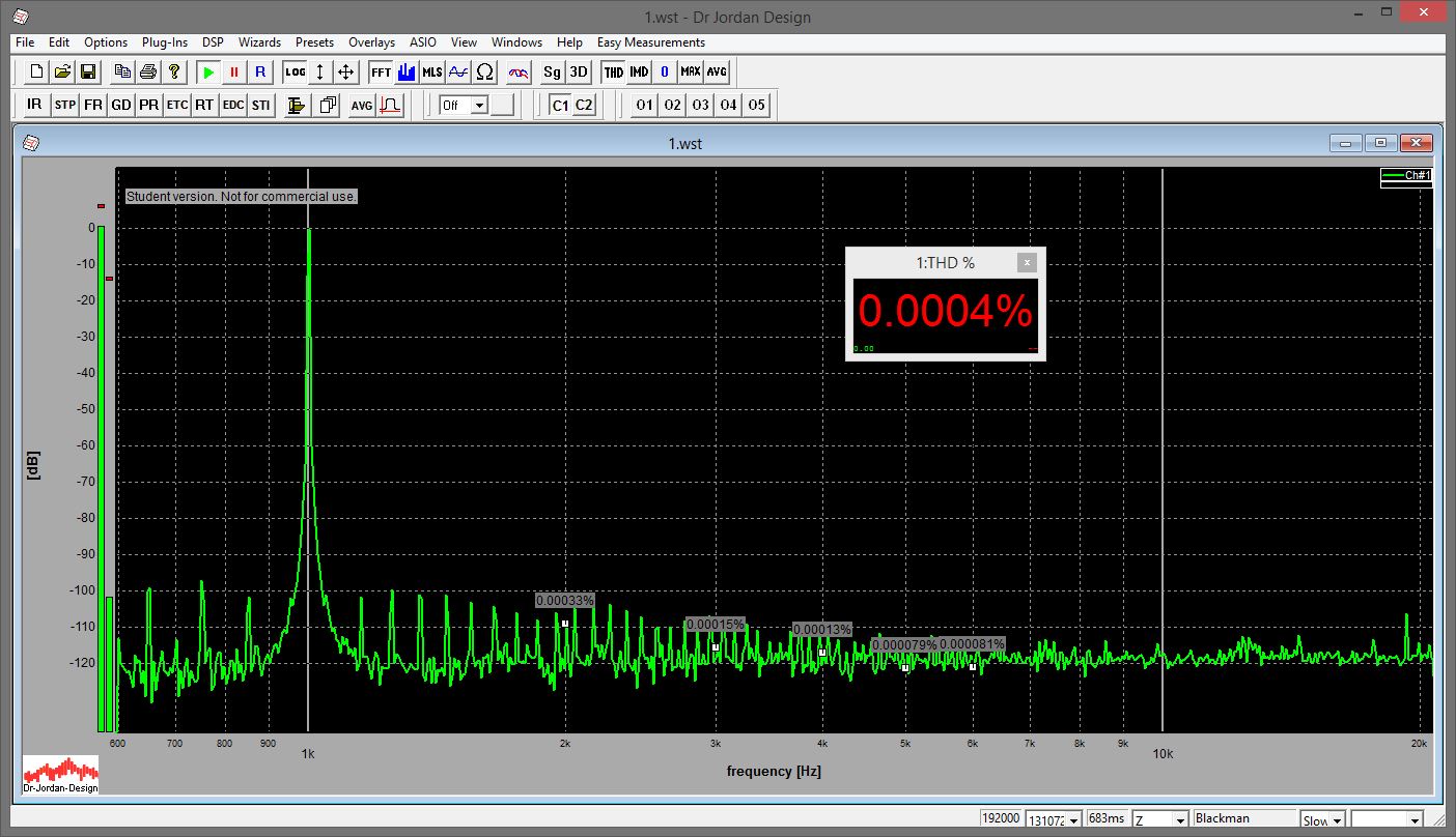

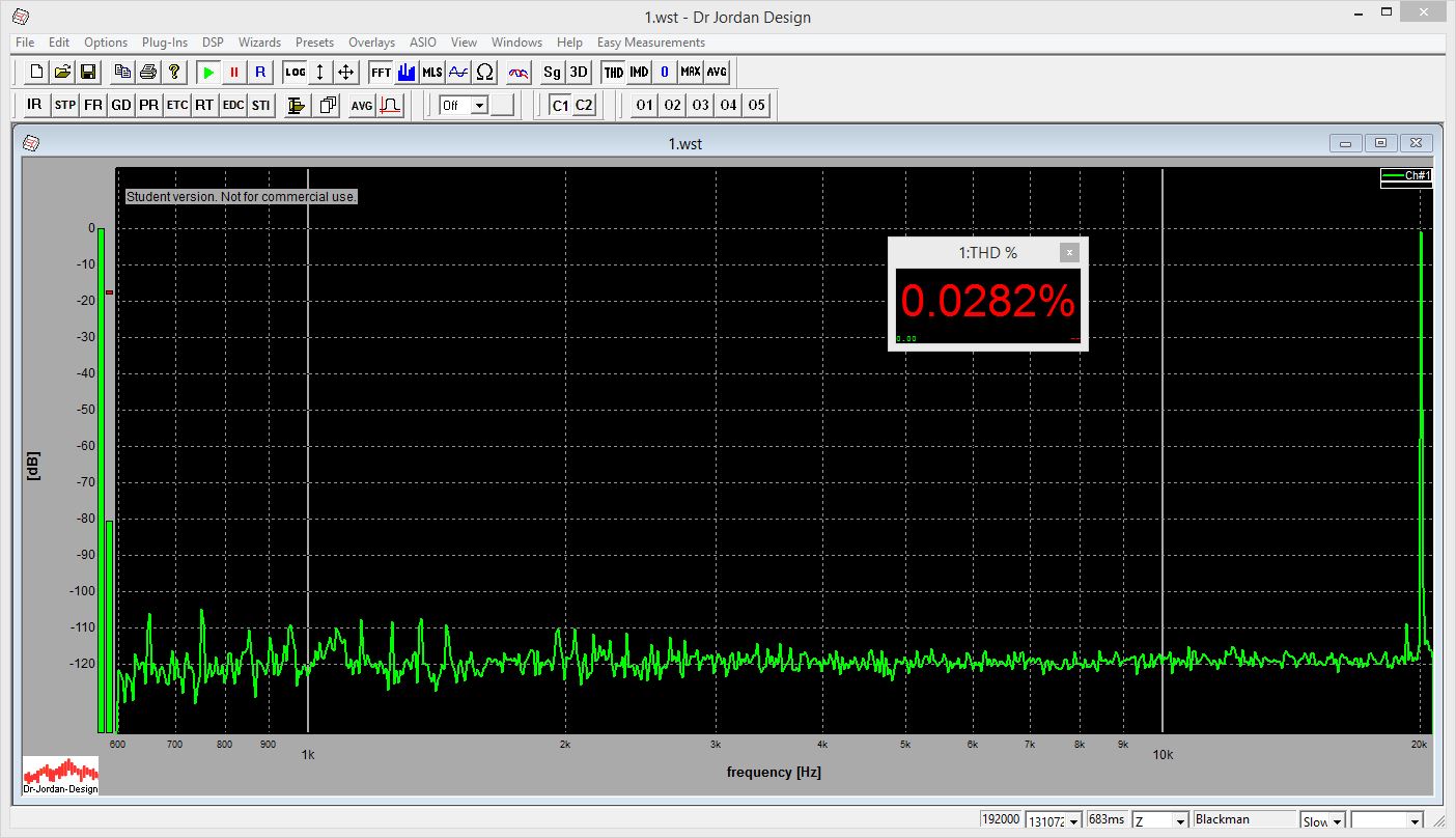

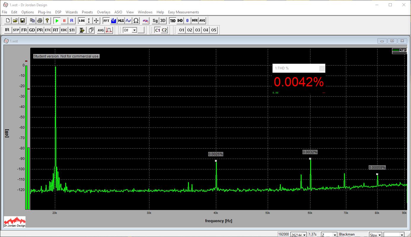

Test with 2 x Lat-FET pairs OPS (from TubSuMo)
One of the possible combinations. Very natural sound. Excellent stability. 8 ohm load.

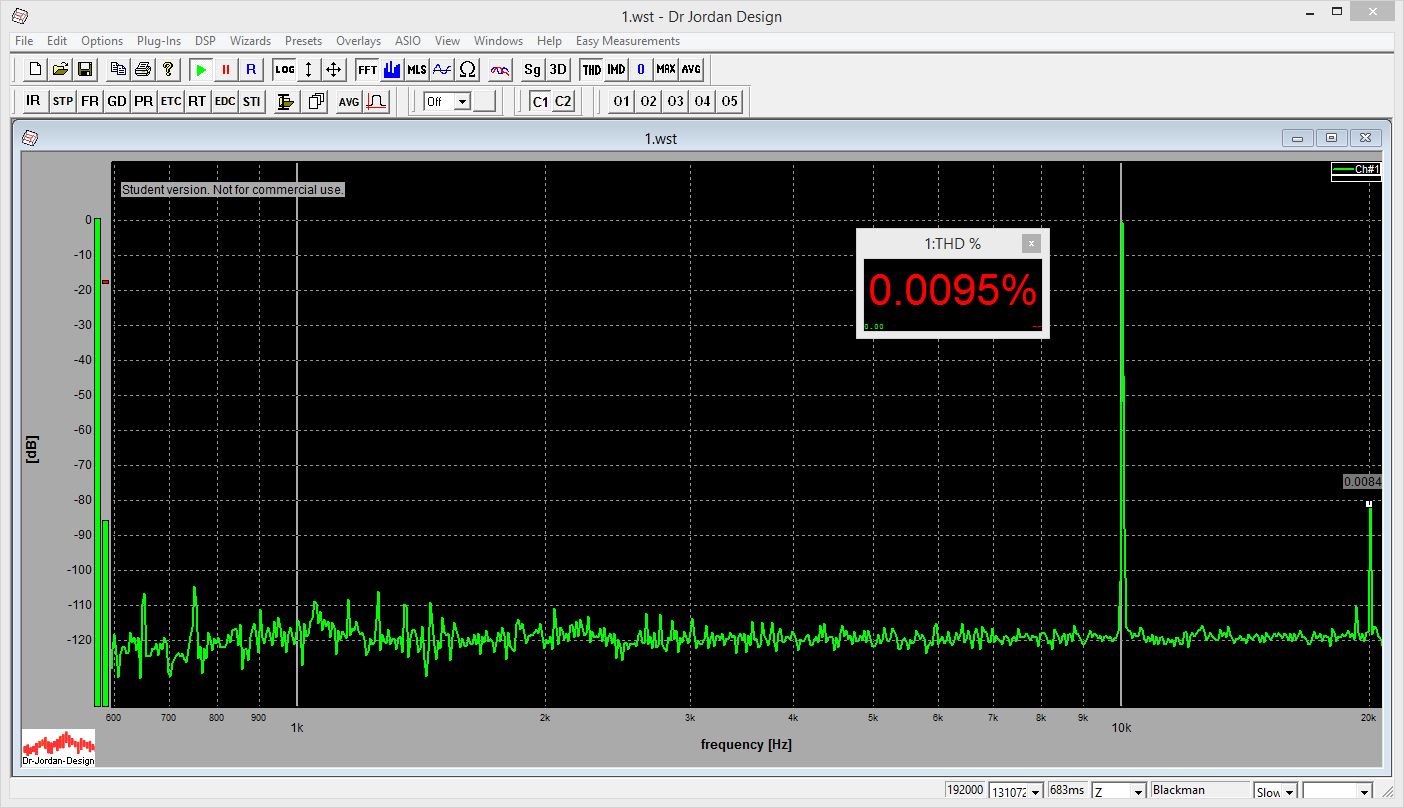

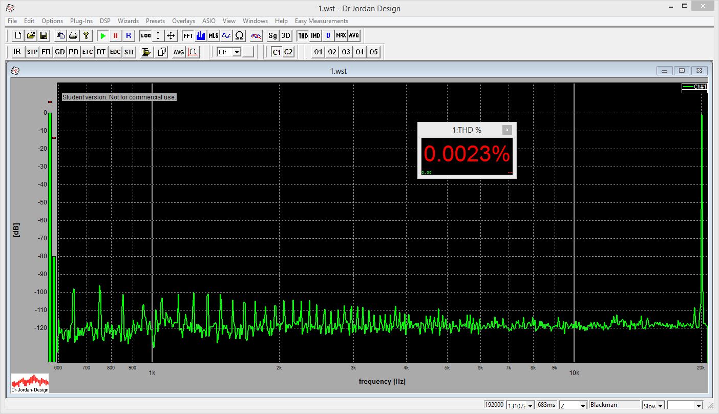

Test with EF + 3 x IRFP pairs OPS (based on SlewMonster PCBs)
Another combination with OPS I have in hand now.
Lower distortion, sounding very close to the previous one.
With all 5 pairs installed, forms a monster-power low distortion amplifier. Distortion growth with amplitude growth - very low dependency.
Still going to re-assemble the original BJT OPS...

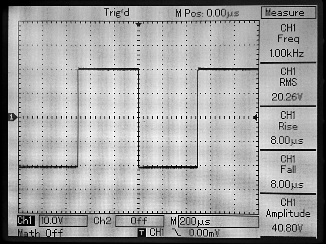

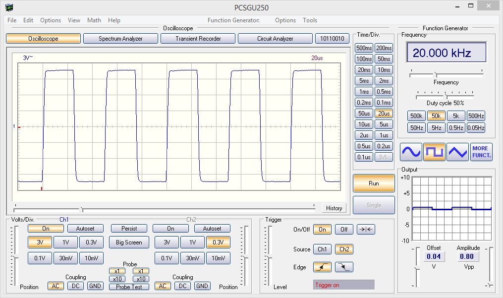

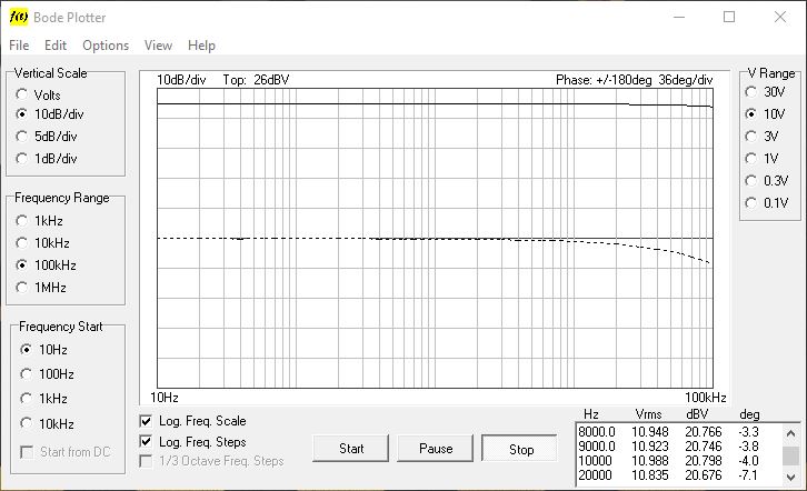

Hi!
I did test it with the new non-switching OPS - this one:
http://www.diyaudio.com/forums/soli...e-old-ideas-1970s-ips-ops-35.html#post4554894
Measurement results are attached - bode, spectrums 50W @ 8 ohm and square wave responses at 40V p-p.

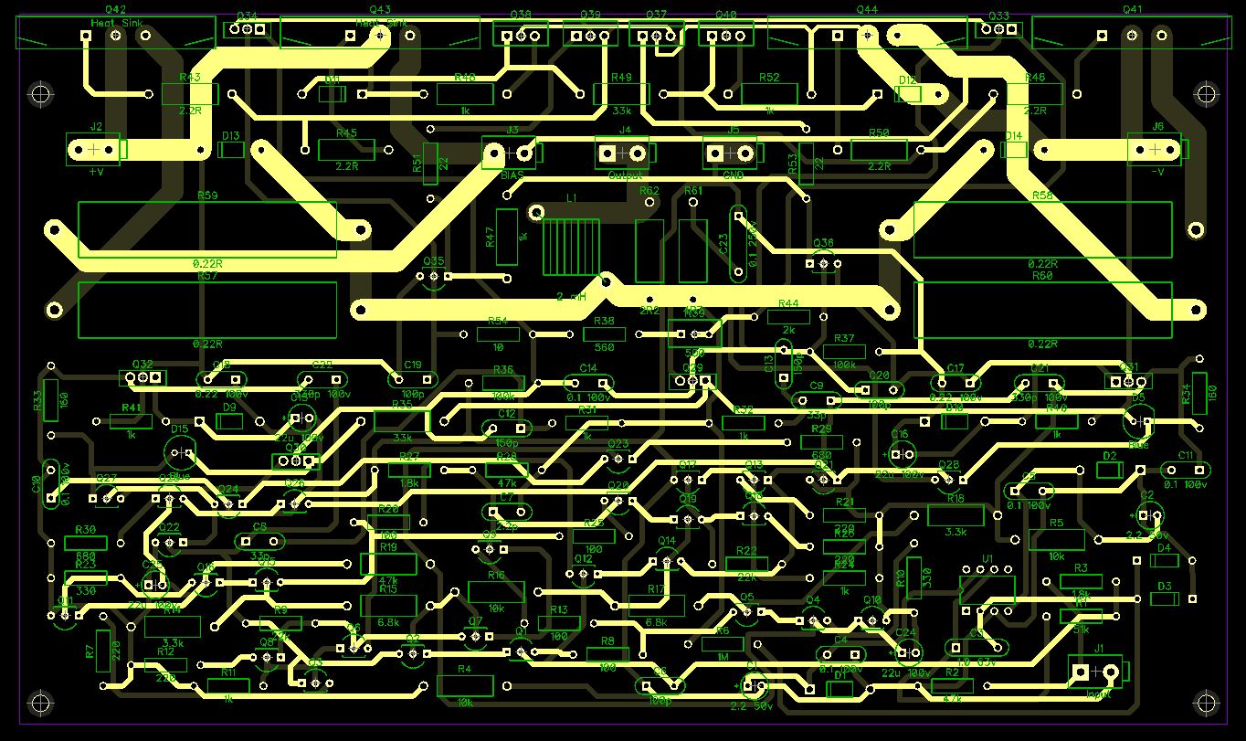

This front-end needs a new layout - more compact and "standardized" in terms of dimensions and connections. I'm a bit surprised with relatively low interest to it - it's very good. Well - many transistors, but all of them are cheap and easy to buy.
Valery

Do you want that i take a look? I just need the schematic with parts rating details...
Marc
Could it be possible to create a ips boards that could match with a slewmaster board like a kypton c or ND does?Do you want that i take a look? I just need the schematic with parts rating details...
Marc
Marc
Hi Marc, it would be great!
Schematic will be very similar to the one, shown here:
http://www.diyaudio.com/forums/solid-state/248689-xhs-xtra-high-speed-design-5.html#post4098539
I will add/edit a few caps/resistors according to the latest tested prototype and publish the final version here today.
Let's call it XHS 1.1 😉
Valery
That's waht i understand when Valery wrote "Standardized"...
Marc

Here we go!
Resistors' power ratings:
- diagonal line "/" means 0.25W (like R2);
- horizontal line "|" means 1W (like R4).
Here we go!

Do you have any advice on transistors heatsinking or coupling?
Marc
