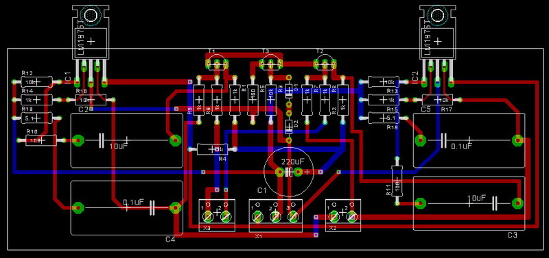

So i can continue the XGC project. I ended tomorow the preamp. It will symetrise the signal to use full potential of SuSy structure.
The "X" diff. pair
The out buffer
All details (In french 😀 )
Marc
The "X" diff. pair
The out buffer
Marc
The XGC mono bloc right to be put together
- In front : soft start with little 12V régulated PSU.
- 300Va 2x25V tranfo
- Heatsink with XGC board and CalorsFm regulated/snubberised PSU. I use Mur1560 diode than 15000µF and 6800µF. Each LM338K have there own heatsink (black one)
Marc
