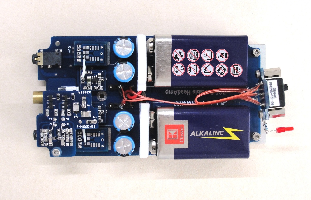

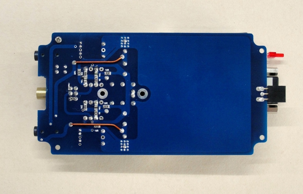

XEN ZGF Portable Headphone Amplifier
The final version finished today.
This has discrete LH0033 output buffer with 23mA bias, Danyuk crossfeed, and DC servo.
Has no difficulties driving my AKG K701.
Patrick
The schematics is same as before except for a discrete LH0033 replacing the BUF634s.
But the discrete LH0033 is a difficult thing to DIY requiring manual DC trimming.
The schematics of the LH0033 is widely published.
I just use 2SK208, 2SC3324 and 2SA1813, all BL grade and all matched.
What measurement do you want to see ?
THD ?
You might as well just use any opamp like OPA627 or LME49xxx, or the new OPA1622.
They will certainly win that contest.
Bandwidth and square wave response is determined by the AD844.
The LH0033 has bandwidth >> 1MHz.
Patrick

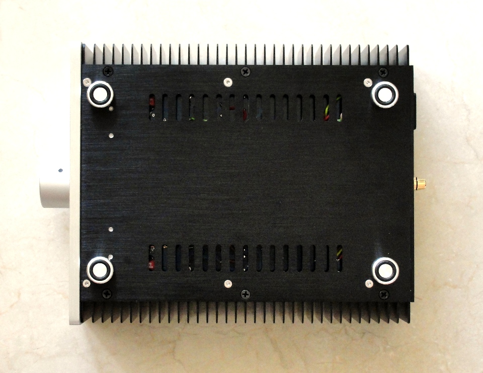

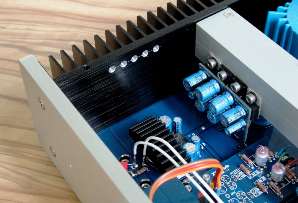

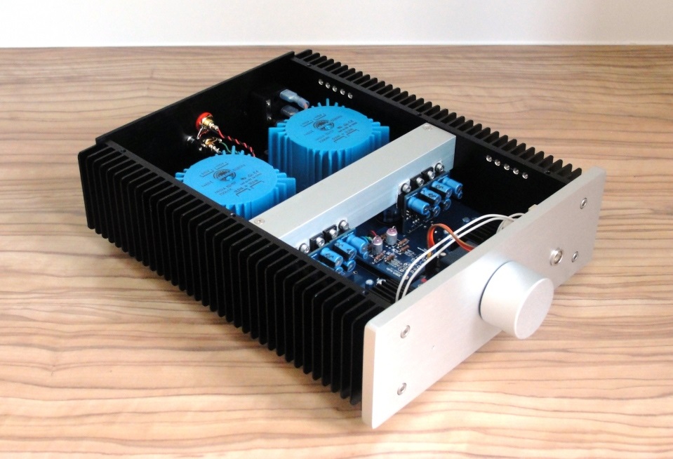

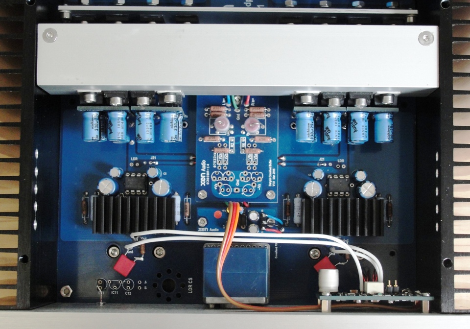

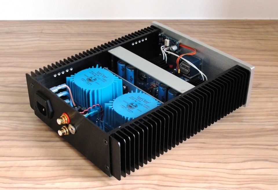

Now the desktop version also (95%) finished.
It is a standard 2107 case but using the top plate as vented bottom.
The bottom plate acts as top for now, but will be replaced eventually by a 3mm anti-static tinted plexiglass.
The knob also needs chopping to half the length.
Purely passive Danyuk Cross Feed, XEN modified ALP RK27 Ladder Attenuator, SHPP Protection board.
Bias is stable to 10% in an hour. DC offset < 10mV, without servo.
More details in an article, but later. 🙂
Patrick

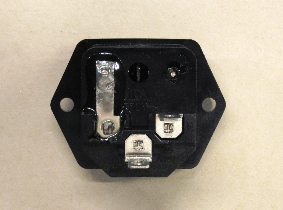

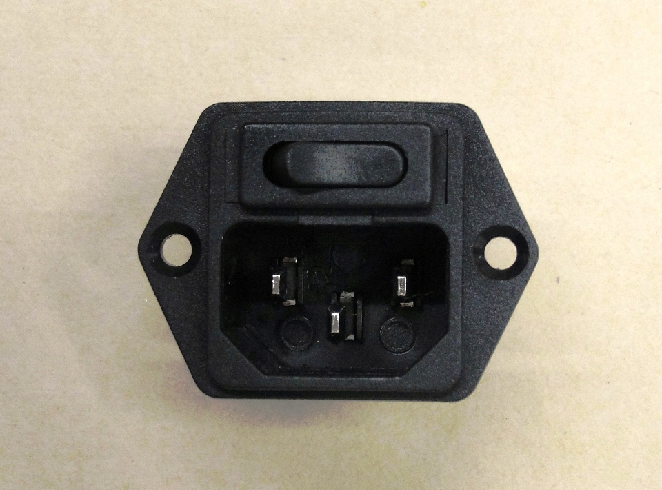

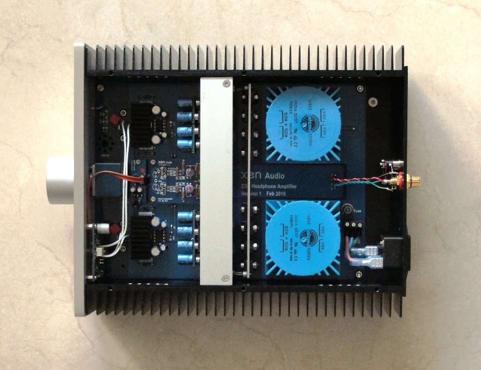

The power socket that comes with the 2107 case has a fuse holder.
But we already have one on the PCB.
So I want to replace that with a switch.
You could get a new one with a switch from Mouser for 10 Euros (Schurter 4302.0001).
Or you can build a Marquart 1901.1102 toggle switch into the fuse holder.
And I do not like the exposed life conductor, so I encapulated it with epoxy as well.
Patrick

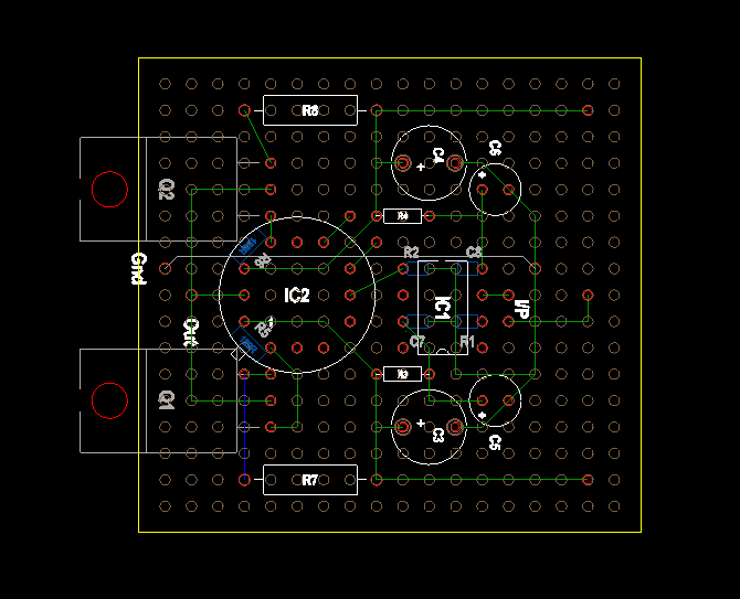

In fact, i have built a discrete version of the LH0033 according to your schematic but the lower ccs jfet is substitute with a npn transistor and led voltage reference and a trimpot to adjust dc offset, the input jfet is 2sk246 10ma idss, output transistor is 2sa1015/2sc1815, i dont have ad844 so i make a headphone amp using simple opamp gain stage then follow by the buffer, it work just fine but not impress me.
In the discrete DPAK version, we used 4 pairs of output BJTs with a total bias of 24mA.
Using the same AD844 gain stage, it beats 5x BUF634 in parallel with ease.
To my ears, with a 70 ohm load, that is.
Patrick
I will try your buffer with your decision of component, hope it will sound good, btw can you explain for me the use of diode dc1? Thanks!
