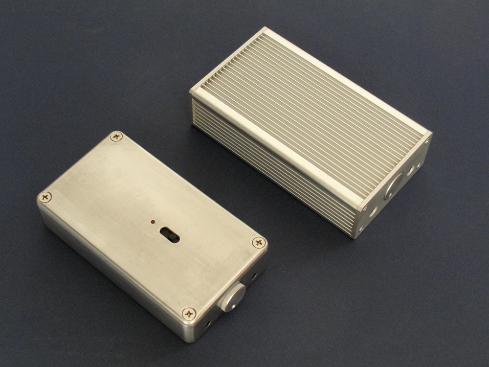

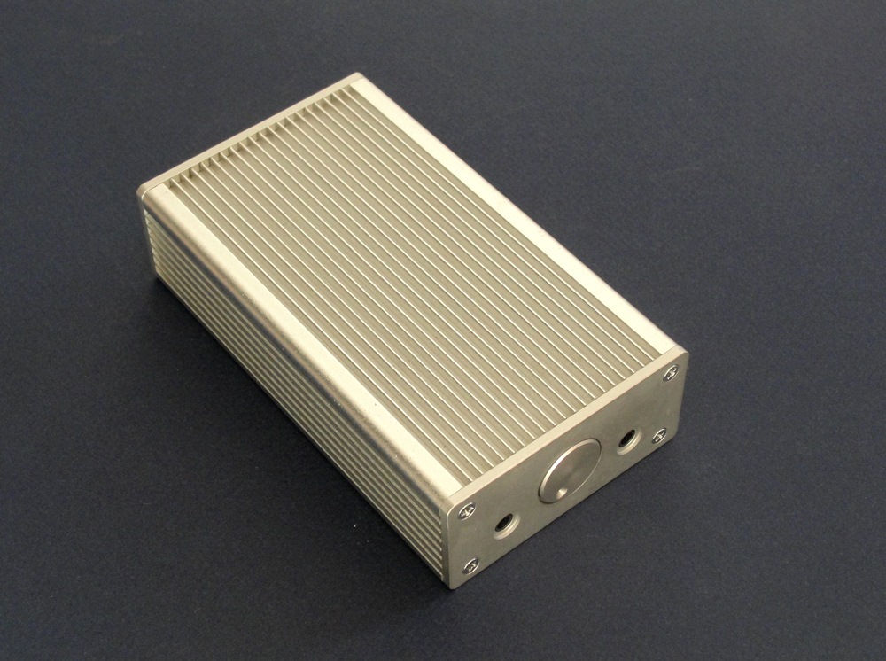

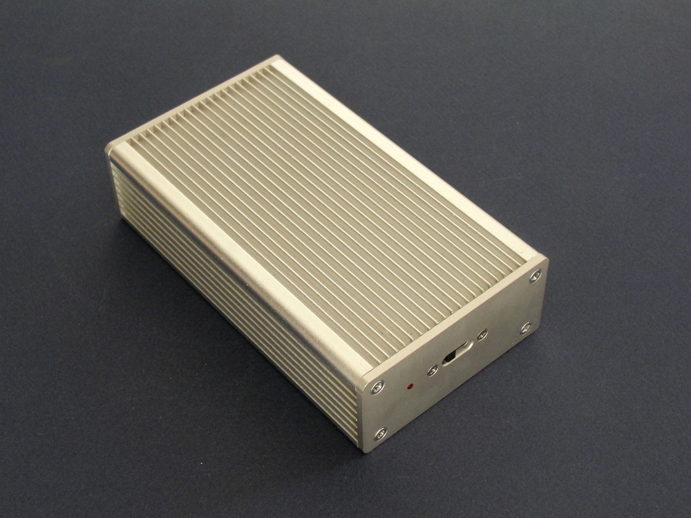

The first prototype was build using a Hammond 1550 die cast box, which was shortened by 4mm.
It also has no servo (only R trim) and no cross feed, and a gain of 5.
The DC offset was adjusted to < 5mV.
For the second prototype, we found a heatsink extrusion, and CNC machined the front and rear panels.
It is however slightly larger, and somewhat heavier (by the weight of two batteries).
It has full features -- servo, cross feed, and a gain of 10.
Patrick

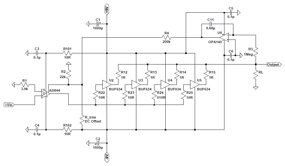

I so much like the schematic of this headamp; 4xBUF634 means 1A which is great. I wonder how it will work with +/-15V on rails...I'm pretty sure it should drive all headphones out there, planars included.
By looking at the graphs it has quite a flat response up to 100KHz, but is there any chance of A/B comparing it with a well known neutral amp perhaps?
BTW, wouldn't be cheaper to parallel 2xLM4900 or 2xOPA633/ch. and to get the same output impedance as well?
Thanks,
Raul.
P.S.: I really liked your transistors (miss)matched article from your website. Thank you for the info!

The R_trim is essentially for offset correction at Pin 5 (Tz).
The same applies to the servo, which in this case acts as a <1Hz current source to create a voltage offset through the 20k resistor at Tz.
We have an alternative version, including an extension to desk top, on the drawing board which is very interesting.
But it either uses an NOS LH0033, or a discrete version of the same.
So we did not want to publish this as the standard version, which should be with currently available parts.
Patrick
Jan kindly reminded me that I had a stupid mistake in the schematics in the pdf document.
Sorry for that, and well spotted Jan.
Here is the corrected one.
The pdf document will be revised in the next few days.
Thanks,
Patrick

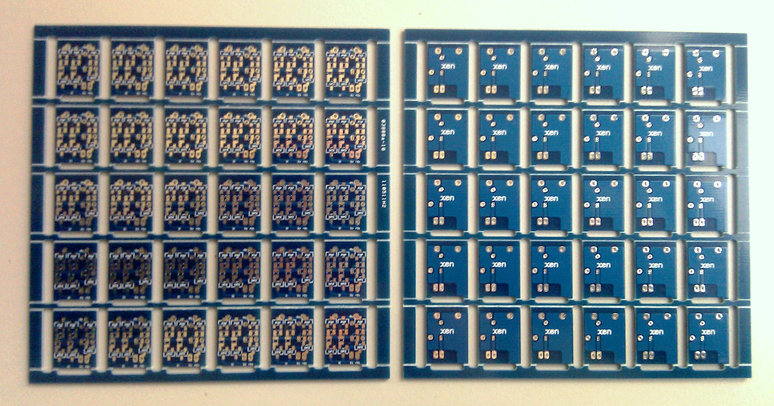

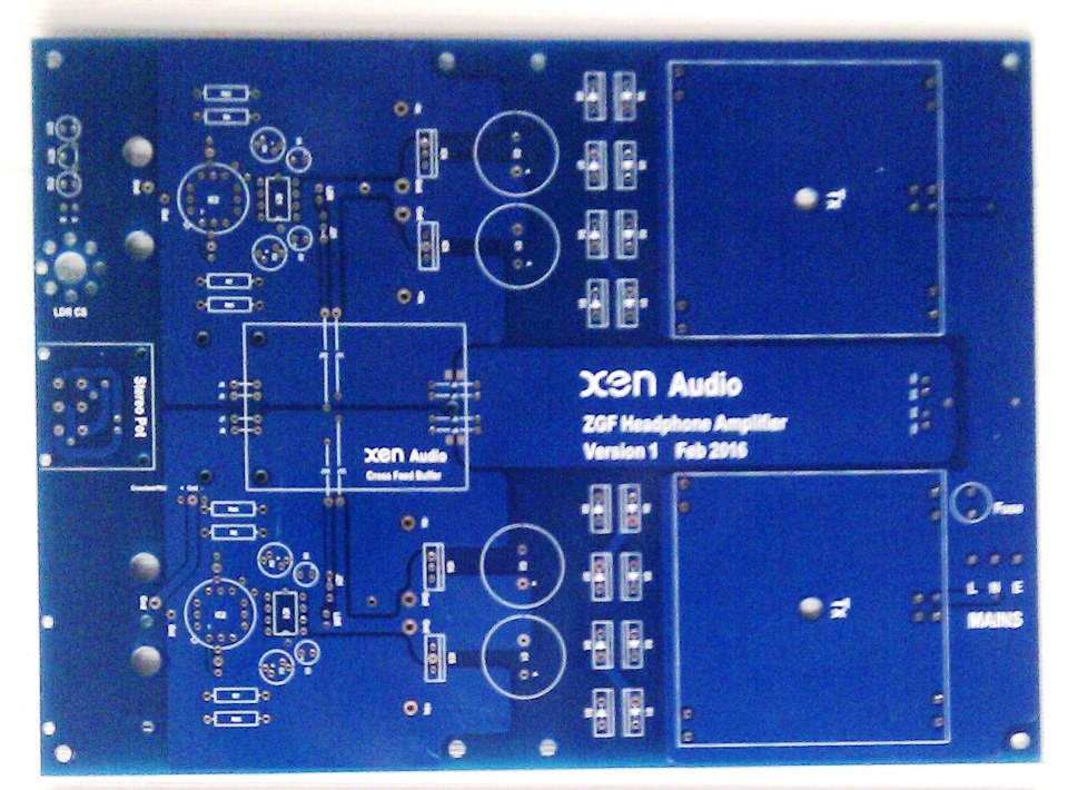

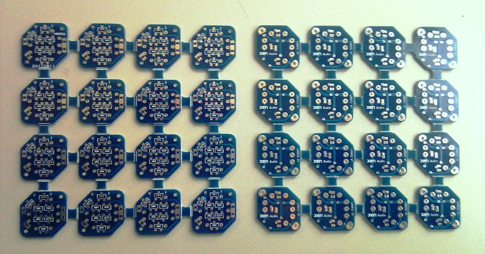

Just received PCBs for the desktop version, based largely on the F5-HA layout.
It uses a pair of LH0033 combined with Sanken complementary BJTs to form a Sziklai output stage.
And to make sure anyone can build this without NOS devices, I also designed a LH0033 replacement PCB of the same footprint.
This uses 2SK208GR and 2SC3324BL / 2SA1312BL to resemble the original circuit.
Patrick

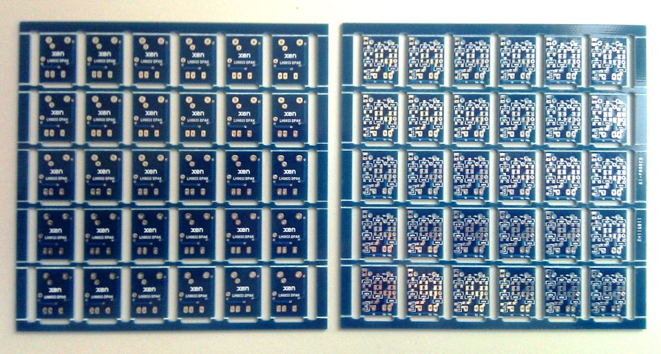

And for the portable amp, also a DPAK version of the discrete LH0033.
This has 3 additional pairs of output transistors in parallel on a daughter board to enable 20mA bias.
Patrick

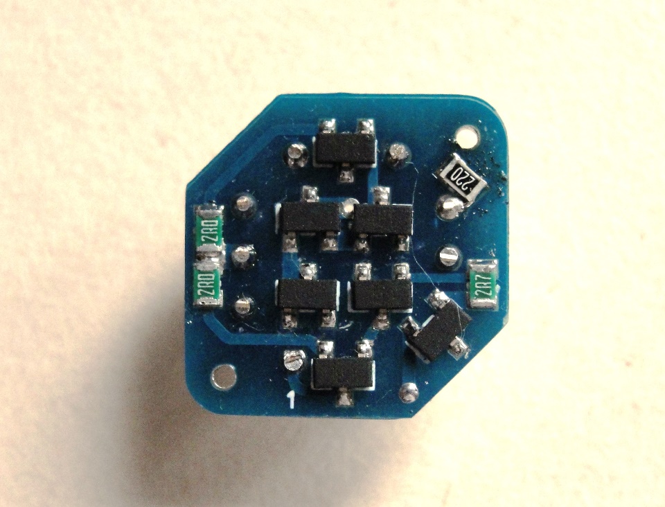

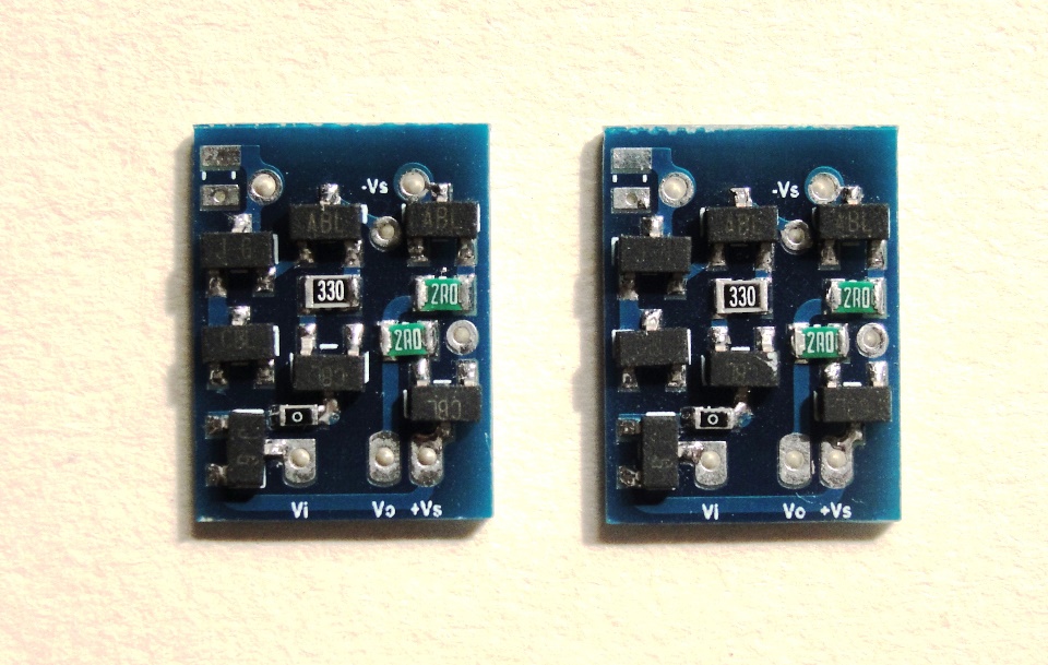

The first prototype of a discrete LH0033 works first time. 😉
It uses low noise transistors 2SK208GR, 2SC3324BL and 2SA1812BL, all matched.
The offset can be easily trimmed to below 1mV.
The foot pin is identical to the original device, without saying.
A 16x16mm IC heat sink can be stacked on top for thermal coupling between devices.
Patrick
