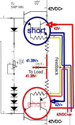

looks to me like the shorted emitter resistors no longer make a contribution to bias stability.
if that's by design, ok. 😱
but i'm guessing it's not ...

Hi mlloyd1,
You are right. It was simply a case of me over thinking something and missing the obvious. I am seeing the wisdom of simply taking the feedback from the load (between emitter resistors). Consider me convinced.
I will revise the schematic tomorrow. I have a few other little tweaks I made. I will likely lay the PCB out so that one can use the built in emittter resistors on the SAP16 or use their own.

tiltedhalo said:
Its a mute point now man, but in any case the short you show there is still not able to get to the load unless it goes through at least one emitter resistor.
See my post above. 😎

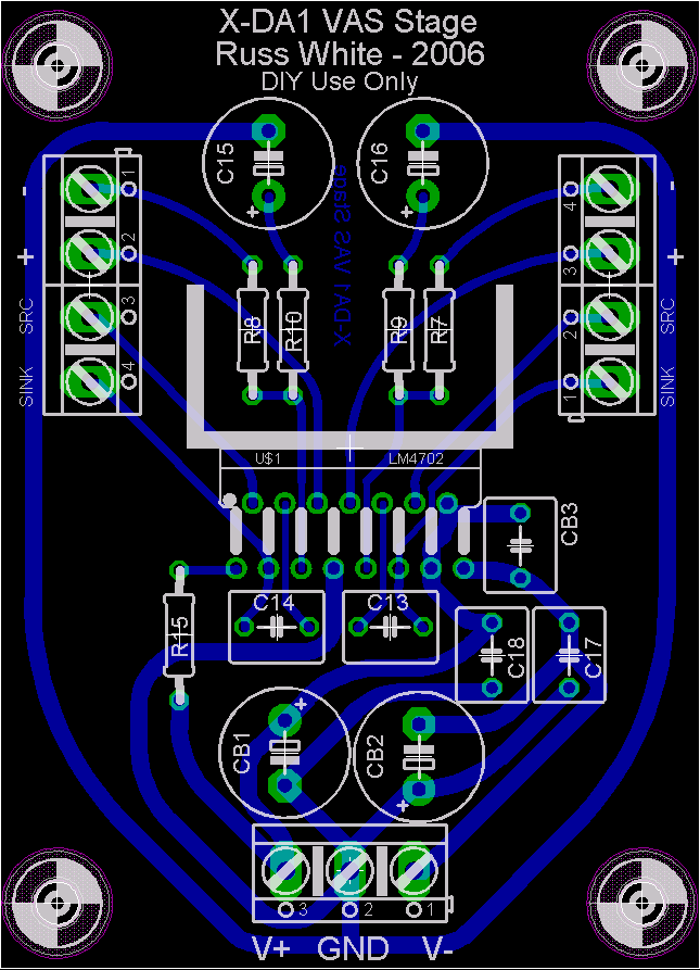

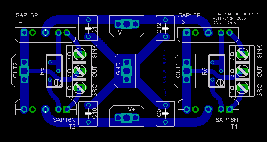

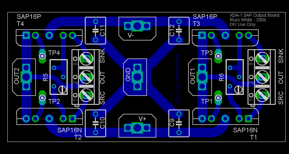

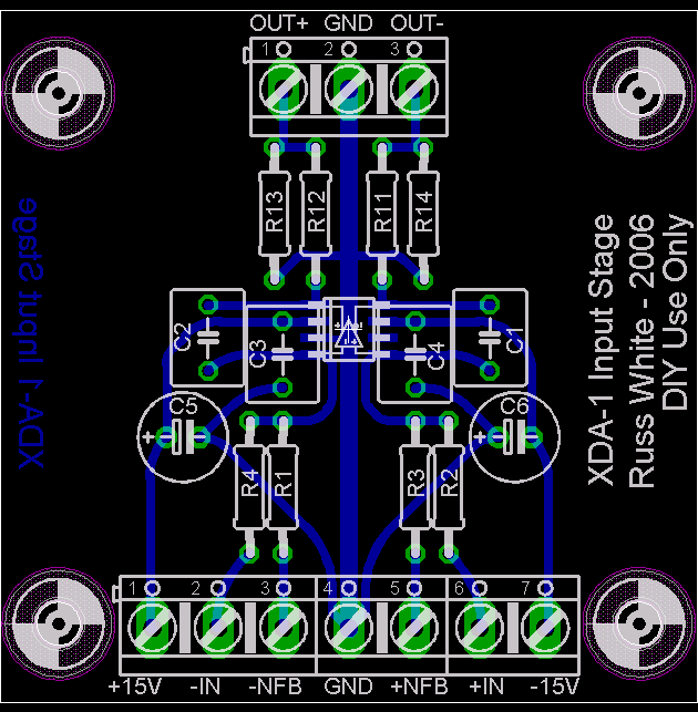

I will be providing here on the thread PDFs for PCB layouts shorty which should allow people to play with the circuit. I may not have time to actually build the circuit do to the fact I am in the midst of a move. So one of you may get to be the guinea pig. 🙂
The set will consist of 3 PCBs(or more if you plan on paralleling output devices) per channel. One will be a the differential PCB (THS4131). One will be the VAS stage (4702 but could also be discrete). One will be the SAP16 output stage, which could be substituted for another PCB or even P2P wired FETs or something.

XELB said:Russ, can you tell me the Bias current in the output stage ?
The SAP16 datasheet say to adjust the VR between the "D" pins for 40ma which should be 2.5ma or so through the VR.
