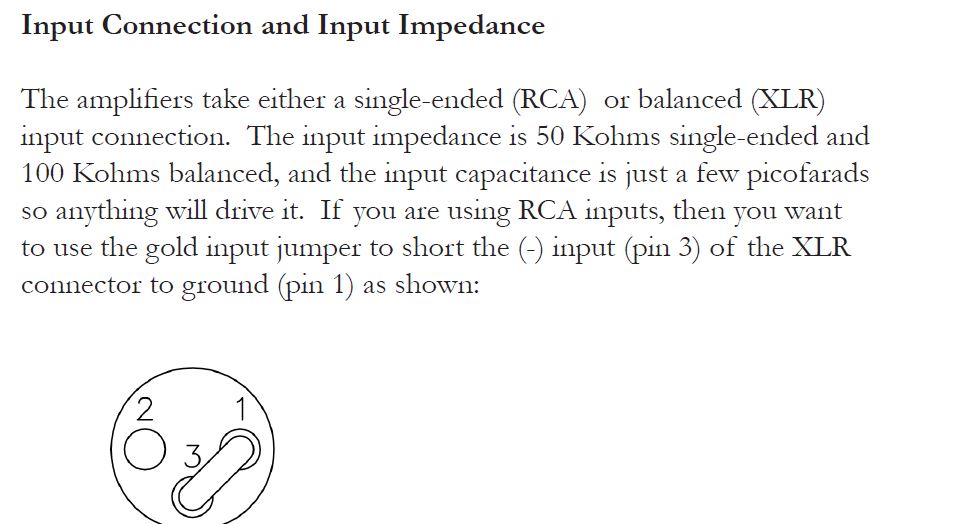

My friend is planning to drive his new XA100.8 from a single-ended preamp. Is it better to convert this signal to balanced with an external converter (eg. trafo-coupled) to feed the XA100.8 with a balanced signal? Or how does the XA100.8 deal with single-ended inputs?

feeding XA with SE signal - step back (lesser amount of SUSY)
inserting xformer prior to XA , for SE to BAL conversion , also step back (involving one more element in signal chain)
which step back is smaller , depends primary of xformer quality
so , try it and decide
It will measure slightly better balanced maybe 50 uV less noise but these levels start to be really system dependent. Sound wise try it with current pre and decide yourself probably very good. Of course we prefer one of our preamps but we play well with others many fine products out there.
