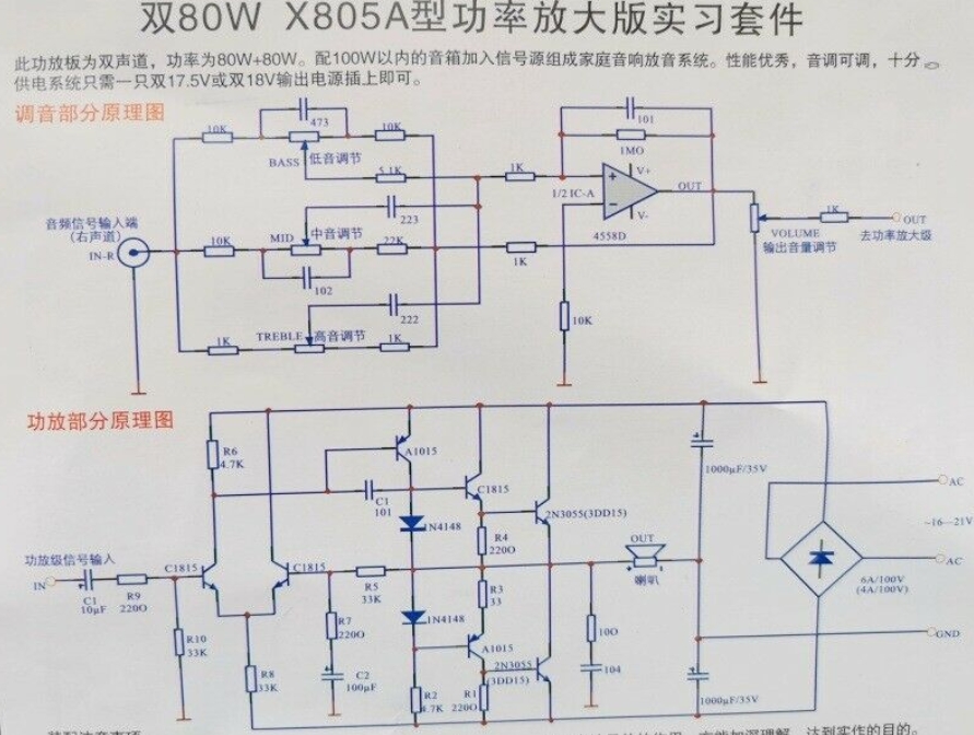

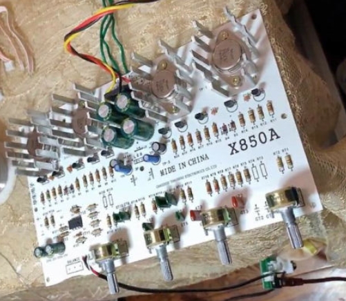

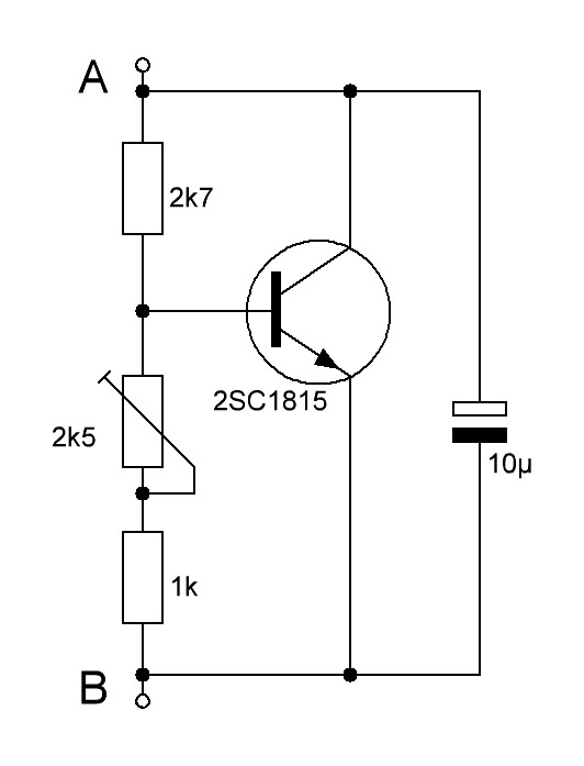

Hi! Did anyone tried this kit? It is a cheap quasi complementary class AB amplifier from China with tone controls. With some build in problems, which you must solve by yourself. There is no or bad quiescent current supply which results in bad cross over distortions. I came up with a transistor as adjustable Zener diode for the bias voltage, which I attached to a finger of the heat sinks, this works so far good,
since 2 years I have this amp in use for my 2 channel TV audio. And I used 4 old 2n3055, and not the shipped transistors which came in the kit.
I mean, it is something from which you can learn a little about amp circuit design. If you be successful, the result is better than expected for such a kit.

If there is no bias then its a class B amplifier.
Those heatsink dont look like they will take a lot of power.

a class B amplifier also needs bias, if there is no bias, or to less bias, crossover distortions appear. This x850 kit had to less bias, even for class B. True, for a real class AB amp the heatsinks are to small.

Other than that, from the values at a quick glance.
DC offset would be very high. And what little bias there is, would mainly be on the positive output rail device. around 1 to 3 ma of idle current
The second gain stage could at least use a boot strap, and a basic zener for the input pair.
Being Quasi Output, Baxandall diode would help as well.
As is, most the current for output comes from the positive side output transistor.
Around 1 amp for 8 to 12 watts.

as I wrote, I use a transistor to generate a proper bias voltage, and attached it to a finger of a heat sink for temperature compensation.
Then I watched the sine output signal with a oscilloscope for full crossover distortion elimination, and then I give a little more bias, but not so much that the heat sinks get to warm. This transistor replaces the 2 diodes.
