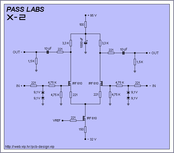

X2_Preamp quetion
Ok this is just a output stage
I agree with your fun. But you should try to get the best-sounding solution for you. And this is the "UGS-version", which sounds more dynamic compared to the "Aleph-version", imho.
Or: do you think that Pass Labs has changed from the Aleph-series to the UGS/X-series only for commercial reasons?
No - that´s not Nelson-like!
