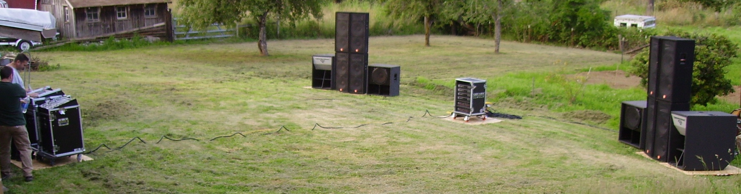

Hey Chris, thanks for the reply. Whats wrong with using the Sonic Maximiser? When I play classic rock cd's (Boston, Yes, Led Zeppelin, ect) the sound is very full and clean. When playing outdoors, it sounds close to a live band. I haven't used this system for a live band though, so thats when I probably wouldn't use the Sonic.
