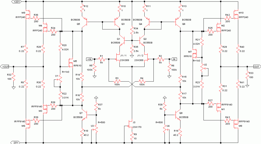

Nelson wrote: "...so on the X350 we used a current mirror for a level shifter."
Could anyone explain how to do it on X100?
Well, you know what a current mirror is - there are plenty of
examples on this site. You source a certain amount of current
into it and you get a certain proportional amount out. The
ratio between input and output are arbitrary, and when the
ratio is unity, it's a level shifter.
Uhmm, could be something like this?
The frontend in this thread is single ended, so I drew it this way. Could also be complementary I guess.
Not sure if it would work.
But it's more a conceptual schematic anyway. All this resistor values guessing...
Ciao, Tino

Hi Marc,
I can just say for myself, that my design (LBHajdu mentioned few posts before) is working very well and currently I'm working on new 4 chanel version for active speakers. There are no radical improvements, just added cascode on differential stage, removed current limiters and removed temperature compensation. Bias is 3A, previously it was 1.5A.
You can find measurement on this page
Thats all
Regards, Robo

The schematic is pretty accurate. I would use a Vbe multiplier or equivalent on each side to reduce risk of thermal runaway though. There is also the small concern that you might end up with your input at 1 Vgs drop above ground unless you are careful, and that could cost you some output voltage swing since the unit is no longer symmetrical around zero (symmetrical around 1 Vgs drop above zero. As far as your speakers, that should not matter since most speakers are floating anyway and you are driving phase to phase rather than phase to ground.
The other thing to note is that it can be quite hard to figure out if your unit is actually working since you need the balance .... Next time around I will use slow servos to set up the current sources, but for now, it is convenient for me to set up partial circuits and tune them independently (a pain in the you know what)

DarkOne said:
I have to say that I could not hear difference between 1.5A and 3A bias on my current gear. Maybe with higher grade components, especialy loudspeakers, there's very little difference.
Setting aside the issue of what you can hear, there is a
real measurable difference. There isn't a lot of feedback on
these designs, and the performance depends quite a but on
the linearity (=bias) of the output stage. My rule of thumb for
Class AB X amps is that the idle dissipation should approach the
rated output at 8 ohms.
