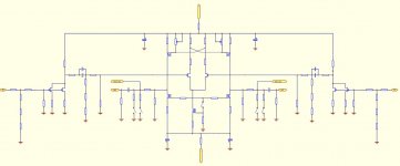

Simmilar to X0.2 you say?
Well, you can try this ...
http://choky.diyaudio.rs/downloads/The Pumpkin & Shunty.pdf
and the thread is here ...
http://www.diyaudio.com/forums/pass-labs/119070-pumpkin-preamp-more-boring-making-thread.html
Highly regarded design thx to Zen Mod.

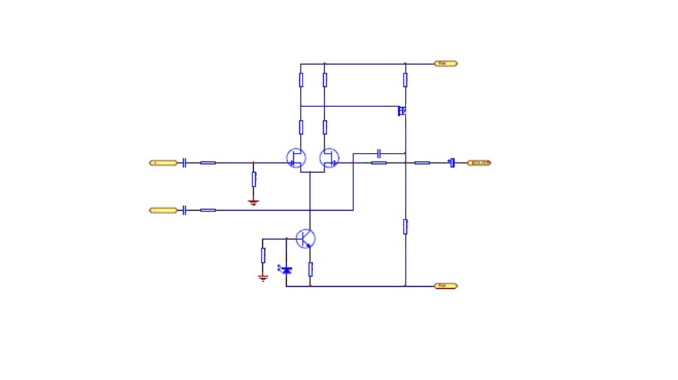

Try it
🙂 Zen Mods Pumpkin can be driven with no input caps and with 10uF at the output.😀
It is my favorite pre and it is constructed very close to X0.🙂

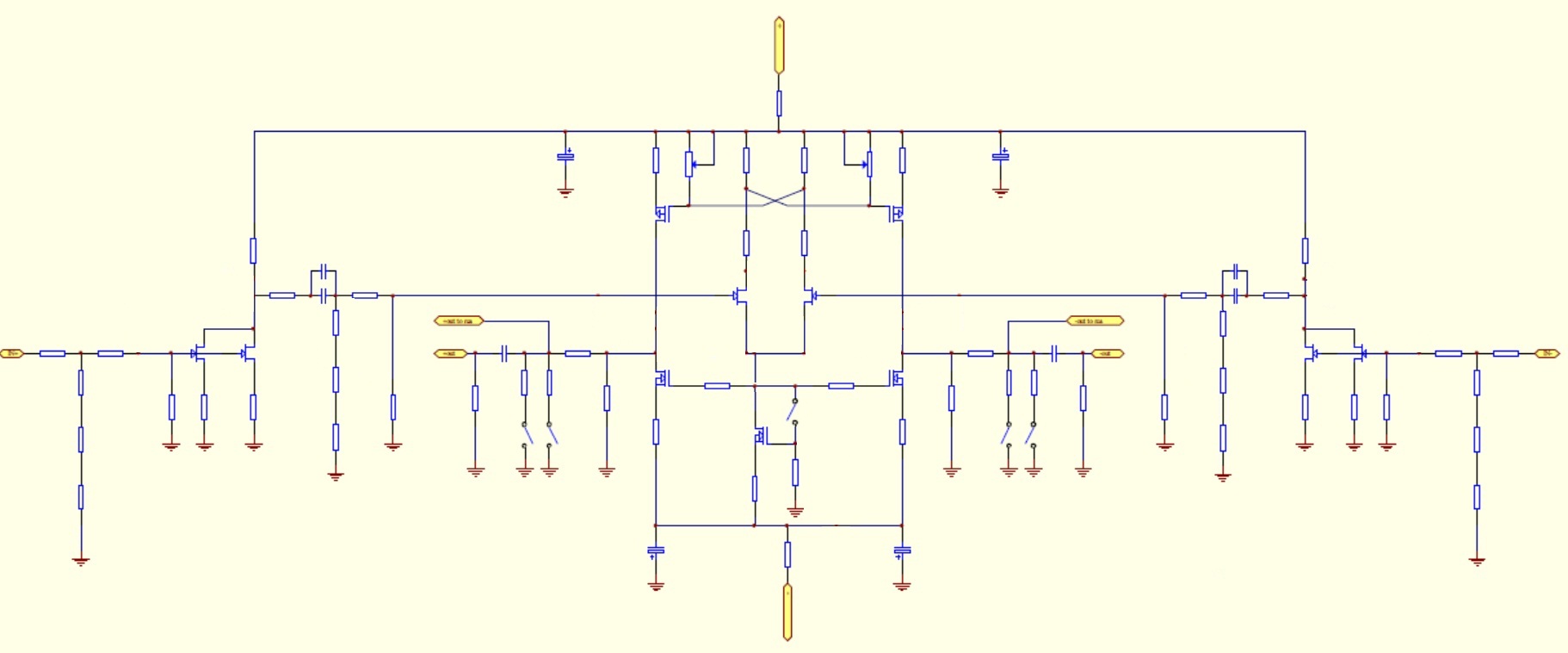

I saw too many different between X0.2 & Pumpkin but there're no problem I need only any advice for 10uF CAP, Where can I find AEON CAP ?
X0.2 used additional gain stage above Pumpkin and used X-CIRCUIT only buffer stage not suitable for gain stage !
Anadigit
Anadigit

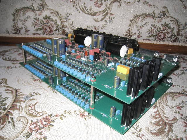

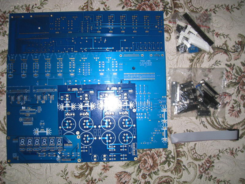

Controller
Semi completed preamp.
66 Steps attenuator.
6 Inputs and 2 Outputs.
30 second muting.
Stereo/Mono
Balance/Single End
Next step I'll change 7-Segment display to VFD Display.
Anadigit

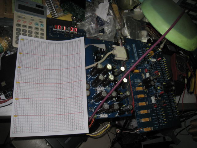

30 second muting.
Stereo/Mono
Balance/Single End
Anadigit
I saw it at the Chinese DIY community......
A bit too complicated for me, the attenuation circuit must be really good, one of the treasures of Nelson.
You do not forget that the circuit is still not given free by Nelson?
I don't have any schematic onhand.
I applied it from top overlay print screened only 🙂
Anadigit
Anadigit
yes I did the same..... and saw the great similarity to the original X0 concerning the core of the circuit.
But I think origina Pass used a great matched and better quality more than me 🙂

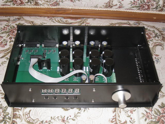

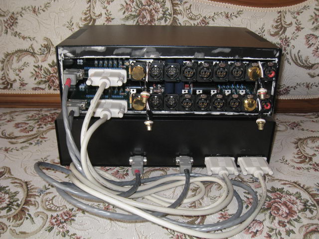

Semi complete !
These're my semi complete preamp, I used 20uF AEON and 10uF Panasonic.
Goal of this preamp is Unbalance Output because it's hard to select matched resistor and current LED for CCS control. I prgram Atmega MCU only volume and selector control also display shut down function. I can't find hard to obtain 20*1 VFD display as original designed.
Anadigit
Anadigit

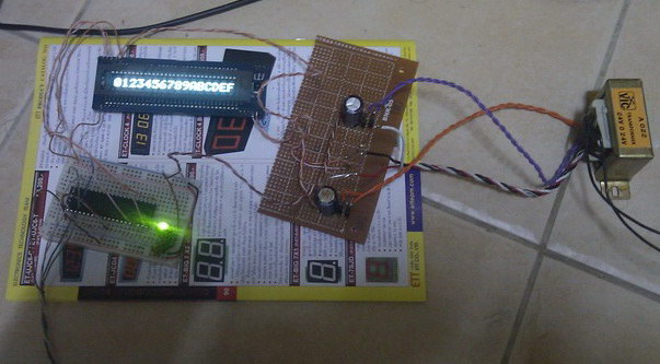

VFD display
Now I try to change 7-segment to 20x1 VFD display. it's almost completed 🙂
I bought this display from OEM factory of NAD S500 cd player display as spare parts.
I have many idea to use them and apply to other function of input/output and volume control.
