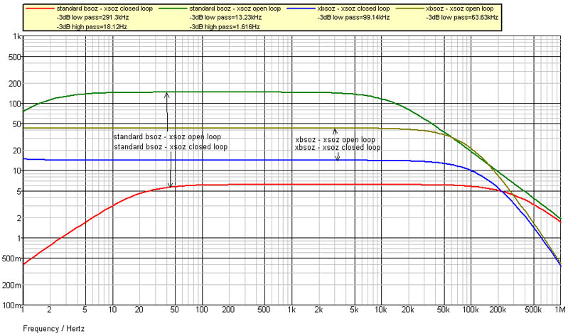

But if you are driving it with standard bsoz two diffrent things happens.
1) Too much (IMO) x-feedback because of the higher outputimpedance in the standard bsoz.
2) If you have 10 uF at the output of your bsoz, you will be down -3db at 18Hz. You need at least 100uF, then you will be down -3db at 1.5 Hz.
If this is the case you still haven´t got the full potential from the xsoz. I have been there.

x-bosoz gain
Henrik:
I know the formula for original bosoz's gain is 20*log(R1+R2/R15). Is the gain for x-bosoz's gain calculated in this way:
gain=20*log[R1+R2/(R120+R121)//(R122+R123)] ?
Thanks,
Thomas
The gain at the original BSOZ an SOZ was controlled by R115 and R207, now it is by R120, R121, R122, R123, and R212, R213, R214, R215, all resistors in the X-feedbackloop.
I have kept the original gainlevel, and also this gave the best frequency responce.

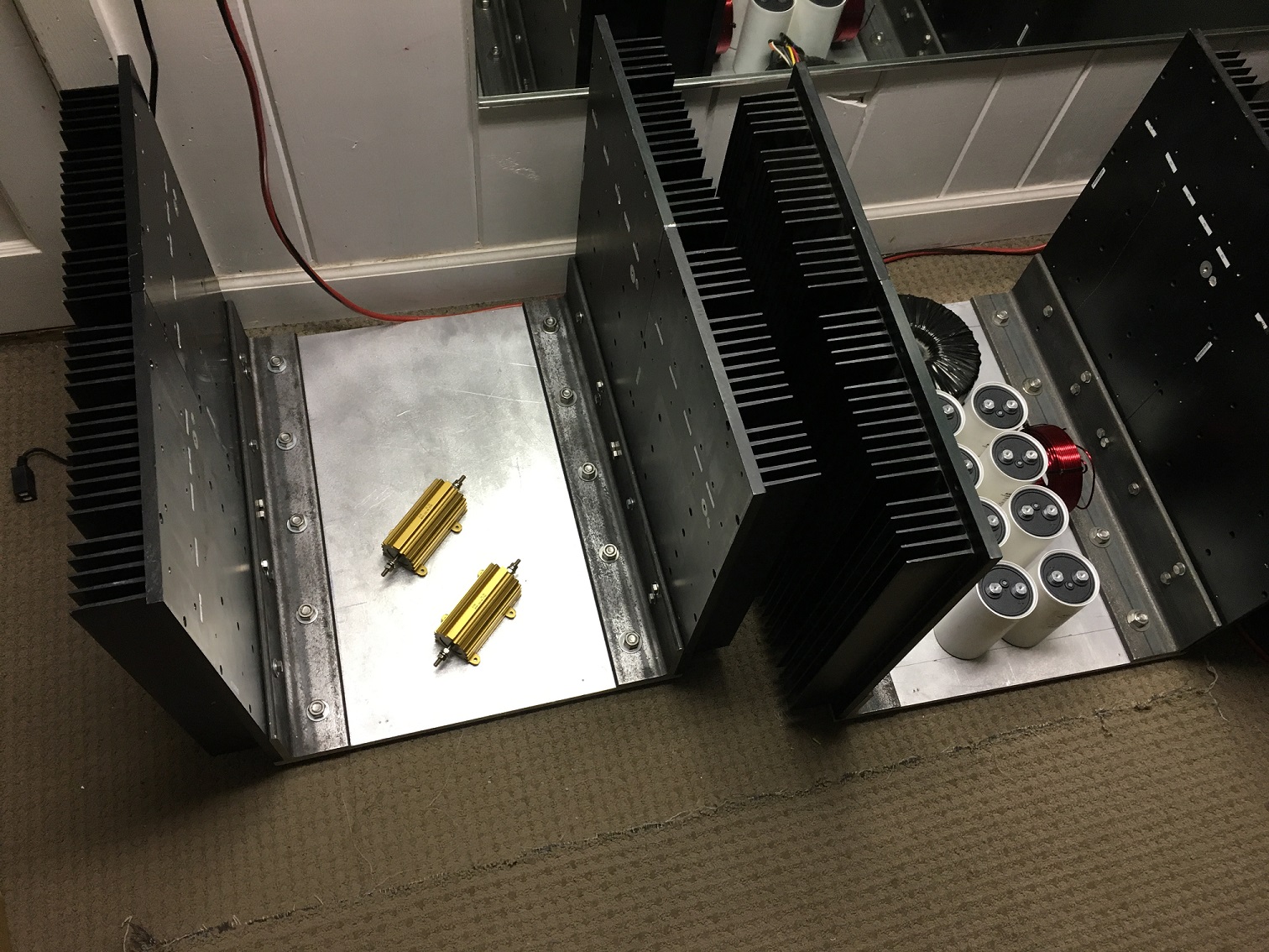

I'm actually in the (sort of) middle of building an XSOZ/X-BOSOZ and a monster Aleph. I even bought a Dact CT2-10k-4 attenuator for my X-BOSOZ that I've been tryin to build for years. If NP would just take a break from churning out projects for us, I'd actually finish something 😀. I have Aleph P1.7 pcbs, but they've been collecting dust. I had a custom 3000VA 35V toroid made for just the occasion, to be able to build both Aleph and XSOZ, which will be driven by the X-BOSOZ. I'd probably go with the XSOZ/XBOSOZ first. I listened to a 15W SOZ for a few months, it's excellent. But I feel I haven't listened to it properly with a proper preamp, was using a DRV134 to convert to balanced, being driven by a NAD 1155. Build it, and build it big!

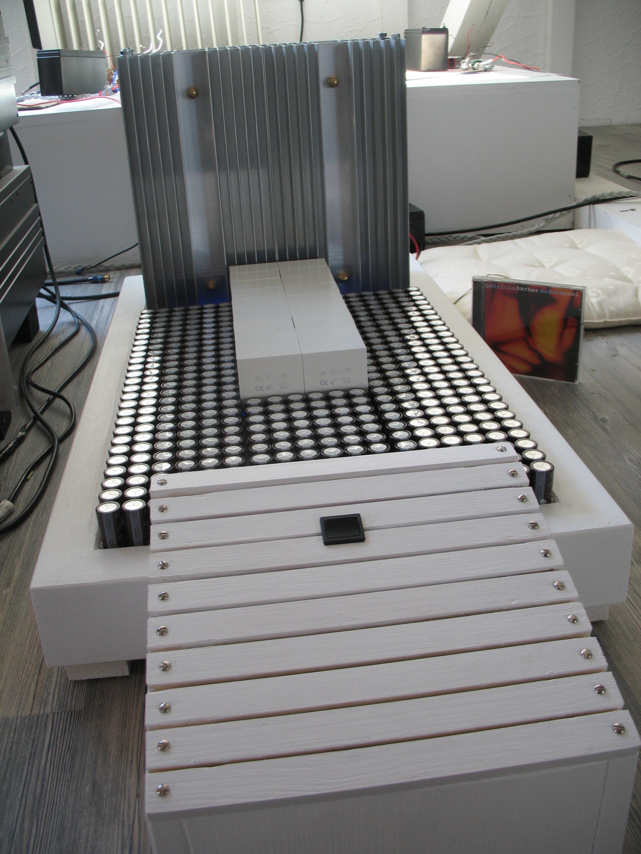

Holy capacitors! Did I count right 660 electrolytic's per channel? Wow that's impressive. Are they 100uf each or more? And are there more pictures of these wonderful amps I can look at for further inspiration?
@MEGAamp I am starting to get an idea of where your screen name came from, I guess it's better than "Dude with tons of GIANT heatsinks"🙂 I am eagerly awaiting your Aleph X progress.
Jeffrey
Jeffrey
Is it to get a low profile amp that so many small caps are used?
I am not sure it is a technical advantage to get let us say lower ESR / inductance compared to use the "big bottles"?
