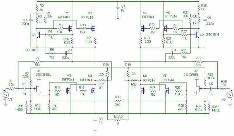

A new candidate for X-SOZ
Check this one out...
While this circuit looks like it would work fine, It doesn't
qualify as an X circuit as there is incomplete symmetrical
communication of the error signal from one side to the other.
To do this, M3,4,7,8 would have to have their Sources
attached to a current source of some sort, not a voltage
source.
Looks interesting and is somewhat similar to something I had in mind. However, I was going to include the 'tail' current source and I would omit the input buffers. I believe I understand the purpose behind the buffers: presumably to achieve decent high frequency response without a murderously low imput impedance. I'm a little reluctant to include them though for two reasons: 1. I with them I am not the circuit qualifies as a Zen (it is now two stage) and 2) if you are going to add an extra stage, why not build an Aleph-X?
A small word of caution, if you do add the 'tail' current source then something will need to be done to achieve DC stability...
Nice to see some interest at last 🙂
Ian.
