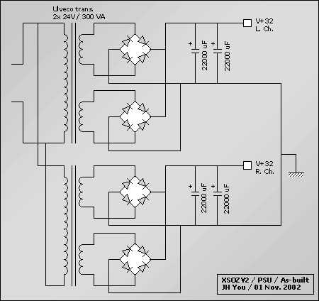

would you describe the power supplies of the XSoz, how big are the transformers, the caps, etc..
the psu seems to be not symmetrical, only 32 volts against ground? but the picture of your amp shows two Caps, which tell me that the psu is symmetrical.
or do you use two psu`s in your amp and one cap for each channel?

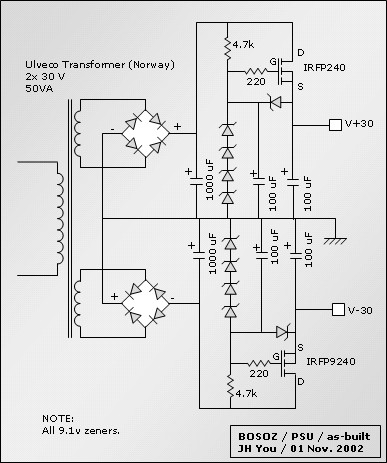

Here is the PSU for BOSOZ.
You may use IRF610 for IRFP240 and IRF9610 for IRFP9240.
All matching pairs of MOSFETs are applied for both BOSOZ and XSOZV2.
Hi, Ralf
Here is PSU as built for XSOZV2.

What about the heat dissipation of one channel. 100 Watt?
Could you say something about the damping factor?
Is it possible to use IRFP 040. I have some laying arroud.

Hi Gunter
Yes, 100W per channel is a safe estimation.
It is pity. I have no idea about the DF figure. However, as variation of R16 (1.5k) value makes us possible to adjust DF during the final listening test, I recommend you to install it in the convenient place for an easy replacement of R16. I could co-operate to find what value of R16 makes approximately how much of the AC current percentage in the active current source.
Nelson Pass always prefers IRFP040. I expect the 040 will be a good choice. Please do not forget to prepare the matching pairs.
