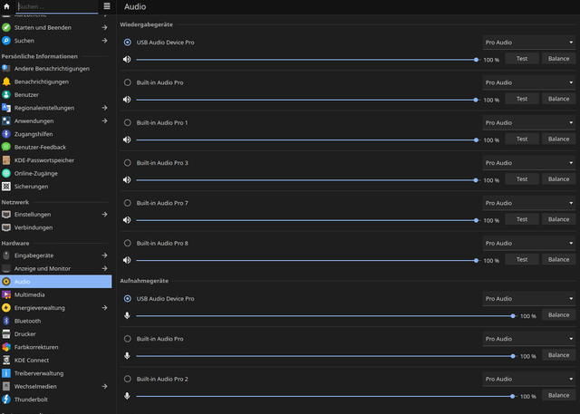

3. set all playback devices to "Pro Audio" in the audio - system settings

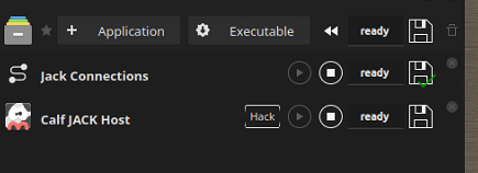

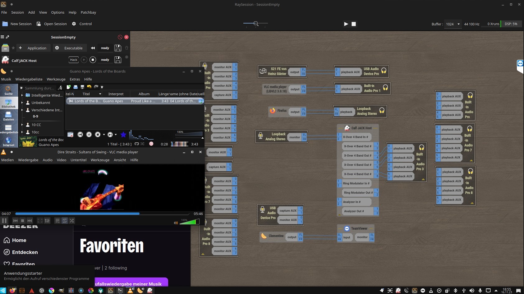

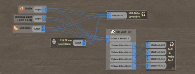

4. start RaySession, create new session, add Calf Jack Host as applicant

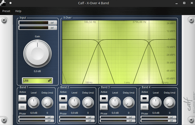

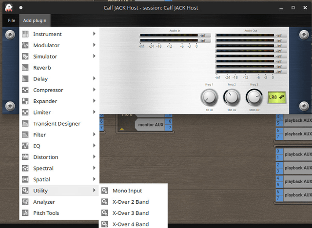

5. load "X-Over 4 Band" in Calf Host
6. open X-Over and define the frequency bands. For the Quadral I choose180 / 3800 and quite steep LR8.

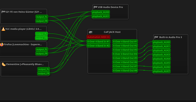

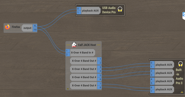

7. do the virtual "wiring" in RaySession.
--- In this example Firefox outputs the sound over my USB interface AND over the chain crossover->HDMI->AVReceiver->speakers.
--- Any "cabling" can be realized with different programs (here Firefox, VLC, Clementine). All my outputs are wired to the crossover AND the USB interface (for my headphones).
8. also a BT connection to my cell phone is possible and works wonderfully.
9. finally save the setup. All settings (including the settings in Calf) are saved and can be loaded again.

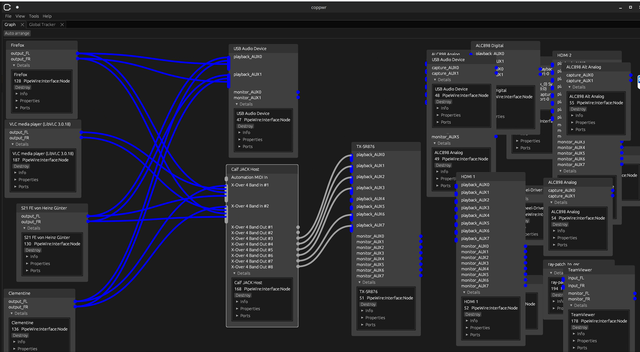

10. in qpwgraph the whole thing looks similar. But I didn't manage to load CALF with it.

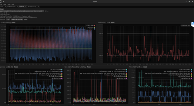

11. here are the views from coppwr. Here you can get a lot of additional information.
Maybe someone is interested.

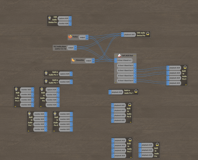

I connect several different devices with different streams
Cell phone S21 via BT with the USB interface
VLC with build in AUDIO 1
Firefox with ASLA Loopback
Loopback monitor with X-Over
X-Over with HDMI
Clementine with Teamviewer

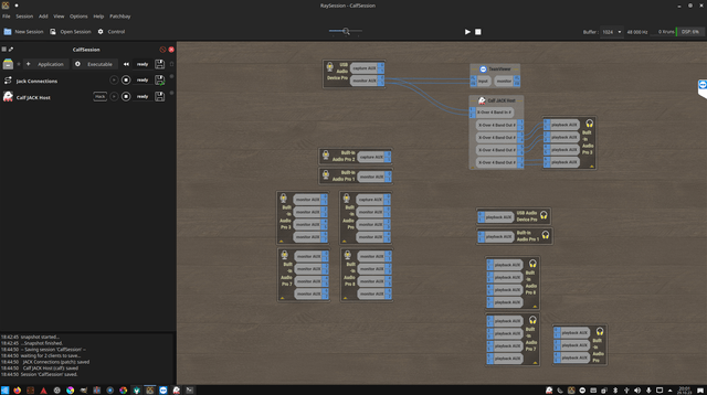

The corresponding Raysession connections here:
The audio streams run simultaneously everywhere without errors

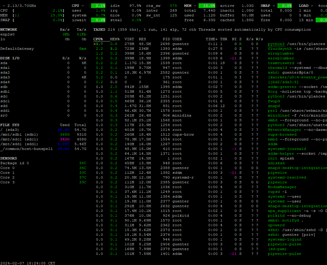

DSP fluctuates between 5% and 7%
No X-runs

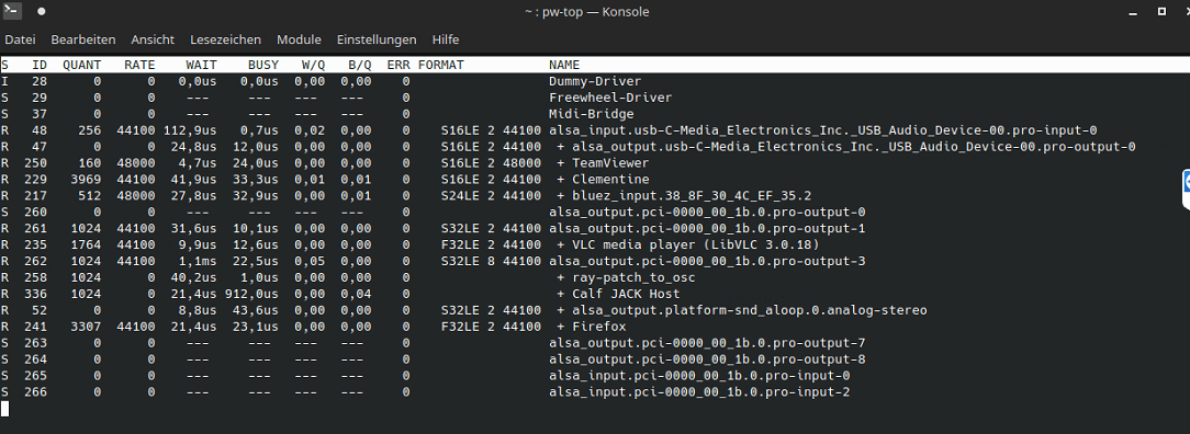

Output from pw-top here:
All streams have a sample rate of 44100 except for the stream to Teamviewer (48000). I don't know why.

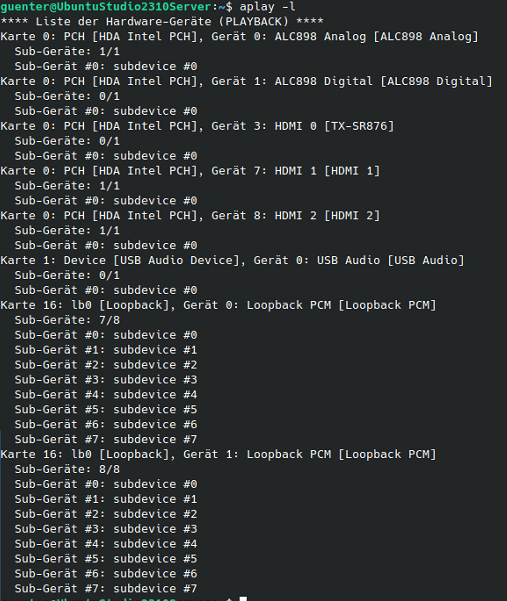

Therefore I have chosen the way via the ALSA Loopback devive.
This is loaded at boot time and can be set as the default devive.
Good description e.g. here: https://www.sdrutah.org/info/high_rate_loopback_websdr.html
Output aplay -l here:
Perhaps there are better solutions here too?
