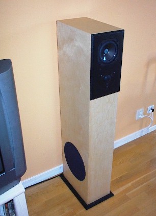

I have built myself a pair of really nice looking speakers...., but they sounds like some cheap crap from the supermarket.
tweeter: Morel mdt32s
Midwoofer: Audax hm130z12
Woofer: Peerless 260swr
The tweeter and mid in a 6 liter closed chamber in top and The woofer sidemount in a 55 liter enclosure reflex.
The problem is the upper midrange, maybe lower highs...
I have rebuilt the crossover 4 times,but it still sounds bad.
If someone wants to help, you are welcome....

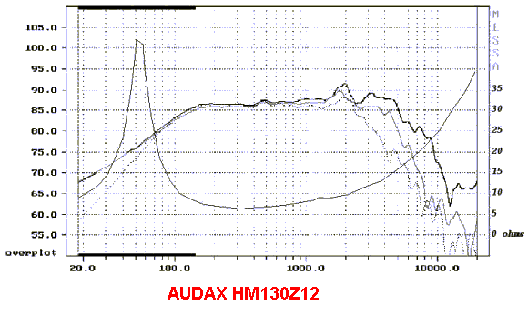

And here is the frequency response and impedance curve:

As for crossover point and order, I'll check some of the Audax kits to see if they have crossed this woofer over before. I'll put up a graph of the tweeter tomorrow, then throw it open to the forum, yourself included of course, for ideas about crossover points and order.

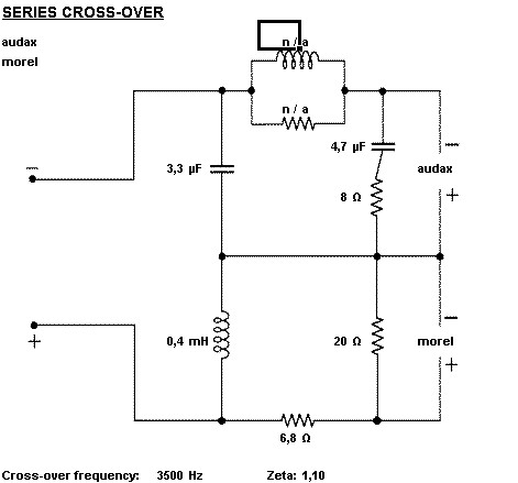

Surfing thru internet, i found an article about series crossover.
Can i combine this with a ordinary filter fx. a series filter to mid/tweeter and an ordinary to the woofer?
I don`t know how to work it out if i still wants to go with my biamping.
Her you can see my first try on a series filter.
