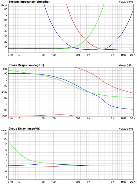

3-way Transfer
Gowa-
Very cool three way -- have you built it yet?
I used the same order crossovers in my last 3-way 2/2-2/3 -- and ended up with the same driver polarities. It was a really great sounding design. If you haven't built that design, I would highly recommend doing so.
I am guessing that it is intended to be a large bookshelf design?
JJ
3-way
I'll be using the PE .75 cu. ft. box. I have the older style, not the curved ones. I've just been so busy at work that it is hard to get started. That's why I've been tweeking and tweeking the designs with the software first. Almost listening with my eyes. (doesn't sound as good that way) This one does look good and should produce some decent sound. I should have it ready for testing in 2 weeks.
