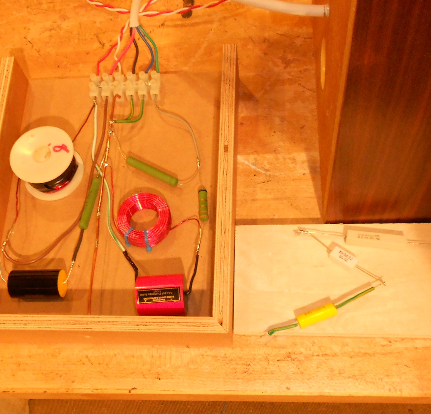

One mans results
I made two pairs of these with, this was the worst pair (sour)....well until I replaced 3 components (now on bottom right).
This is now the best pair, it was more than a slight change.
This was only a $15 upgrade.
(values are the same)
