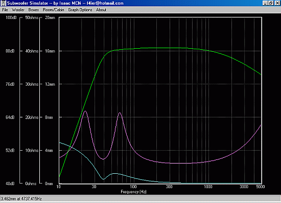

I ran Subwoofer Simulator on 1 P17WJ to see what happens to one Vifa. Remember, a parallel pair will have half the impedance. Shown is frequency response, impedance and cone excursion. This is for a 56 liter box tuned to 39 Hz. Incidentally, the calculated frequency response shows the VC indictance with a perfect cone-real response will be higher above 1K Hz.
The impedance dip at 39 can be helped by stuffing the ports a little. That will raise the impedance to perhaps 12 ohms.
But the big problem seems to be from 150 HZ to 1500 Hz. In that band, you seem to vary between 8 ohms and 6 ohms. In a prallel pair, that means 4 ohms and 3 ohms. No hope of bringing the parallel pair up to 6 ohm load here.
I wish I could be more helpful as to a solution. It looks like hook them up in series, or hook them up to an audio transformer-the second being a cumbersome, little-used solution.
BTW, Subwoofer Simulator is a freeware program written by a member here. It models your choice of any of 18 different curves on any of 7 different box configurations.

If you friend is stuck with using the Pioneer, it appears that you’re stuck with series drivers. You make a zobel circuit to tame the impedance above 1kHz so it doesn’t get too ridiculous at the xover point to the tweeter. If the amp has trouble with <8ohms, it should be able to handle 12 to 16ohms.
