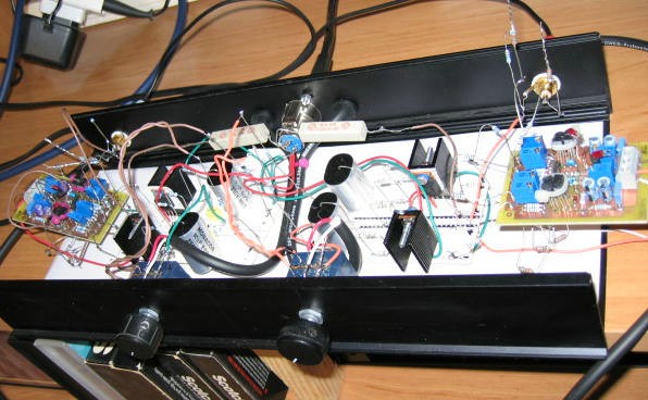

Hi to everybody !
This is my attempt to use the X modul as a real life preamp .
I would like to thank Uli very much for his wonderful thoughts and help in making this sound damn good ... crazy but it works ! And fine .
The 4 * magical resistors are now 22k1 🙂
Yes the offset drifts but within a safety marge ( +/- 2V )
The output followers ( basic structure of X amps ) are 610/9610 i pure class A , 40mA bias at 25 V rails .
Sound is .....
Here is the pic :
