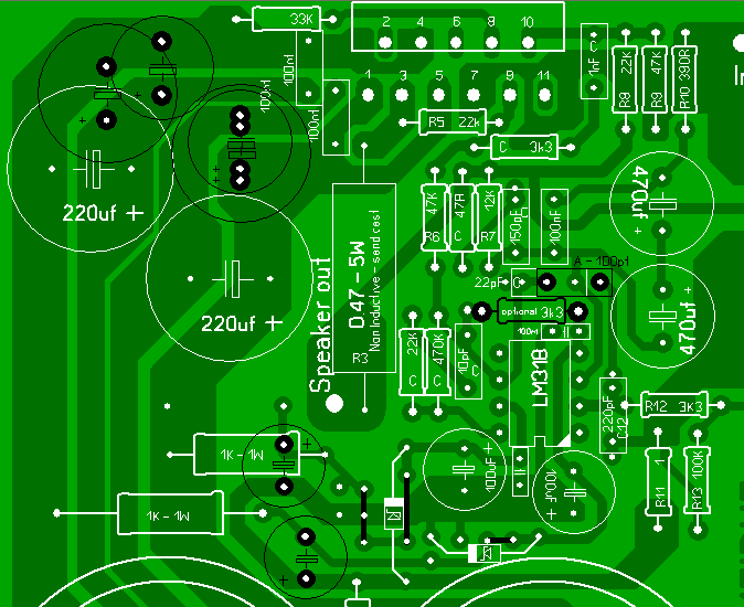

I'm planning to build this amp but i dont know what kind of caps/voltage I should use for each one. I dont have enough knowledge to decide myself.
can anyone help me ?

for the main caps 10 000 and the 220uf you can use anything above 40V 50 v would be better
the caps 100uf on the supply for th eLM318 you can use 25v and 35-50v for the speaker protection. the 470uf you can use anything above 25v but above 35v would be better

Ok I have been doing some work on this and made some changes. I can't see myself changing more than this,
you still have the option of regulators or just Zeners. i dumped the idea of having both
you have a semi-split ground plane for the Lm3886
and you also have various cap options for the Lm3886 supply and then you can also put a RC filter on the LM318 supply. all caps have been moved closer to the pins and tracks are as short as possible
there is now two LED on the board, speaker on and speaker off
PDF is A4 and the board should measure 175mm x 150mm
Enjoy

rudi, dumb question here. 175mm X 150mm for each board or both? I presume they are dual mono. Sorry if I am asking a silly question. Not good at this. 😀
rudi said:Here is the Copper view from the component side
board measures 175 mm x 150 mm
print out on A4
😉 it is 175 x 150 for dual mono. the centers of the chips are approx 88mm apart, you will see small lines next to the relay and input cap indicating the cutting line, (if you want to cut)
hope this helps.

I have a few questions regarding this design:
The BOM calls for 1n4007 and the silkscreen calls 1n4001. In this application, is there a functional (or sonic) difference? Any preference?
Also, the BOM specs a JQX-14fc1-c for the relay. I'm a newbie regarding relays, what equivalent parts would replace this part in form, fit, and function? A Mouser available part would be very helpful.
