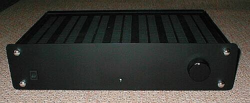

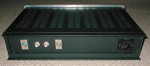

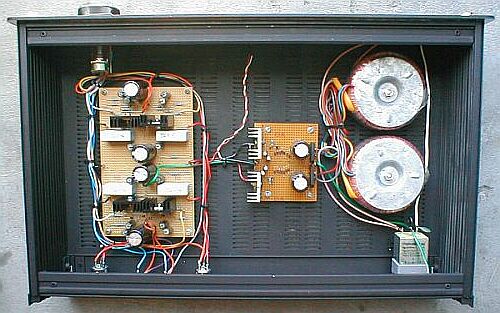

I just completed and fired up my X-BoSoZ - which is now the proud bride of Mr.Aleph30 😉 [BoA] ??
http://www.diyaudio.com/forums/showthread.php?s=&threadid=7610&highlight=jdev
Unfortunately I did not 1st build std. BoSoZ as planned because of using stripboard and the hassle of removing and rerouting jumpers (always a pain with stripboard). Anyway I did compare to org. setup which was CD player direct to A30. I use unbal. IN, bal. OUT. Only deffinate differance I can tell is that A30 got more - deeper base now and are sligthly more crisp - if you can imagine crisp 😎 , and now I have full range vol. control - loud enough at least.
Here are couple of pics.
Well done,
Is that a TDK attenuator?,
Does it have an active current source (simple FET type)?

Thanx for all the compliments.
I use 2 x stereo pots, Alpha - 10kohm, which I ganged for 1 axis. This was the best I could do with local components. After reading the tests done by Henrik, (http://www.diyaudio.com/forums/show...=15&highlight=xbosoz and henrik&pagenumber=28) , I decided not to use any CCS, but just ground -IN on the earth lug of the input RCA plug. My PSU gives a nice 60.5V on the rails, as recommended by the
himself.
Thanx again to Henrik, Ralf and the other X-BoSoZ developers for all your time, effort and advice on designing this circuit. Guys like you and the others with the same abilitys , give guys like myself and others with the same disabilities realy alot of pleasure and fun
