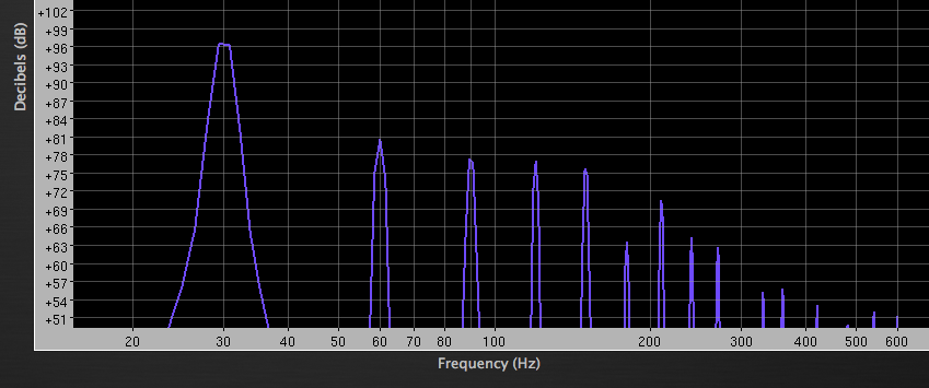

Here is an example of a low distortion sub driven past Xmax, (it's linear excursion capability) with a 30Hz sine wave:
The 30 Hz fundamental is at 96dB, the 60Hz second harmonic is 81dB, -15dB below the fundamental, about 18% distortion.
The 90Hz third harmonic is 78dB, about 12% distortion, 120Hz fourth harmonic about the same, the harmonics continue upward in frequency at multiples of the fundamental.

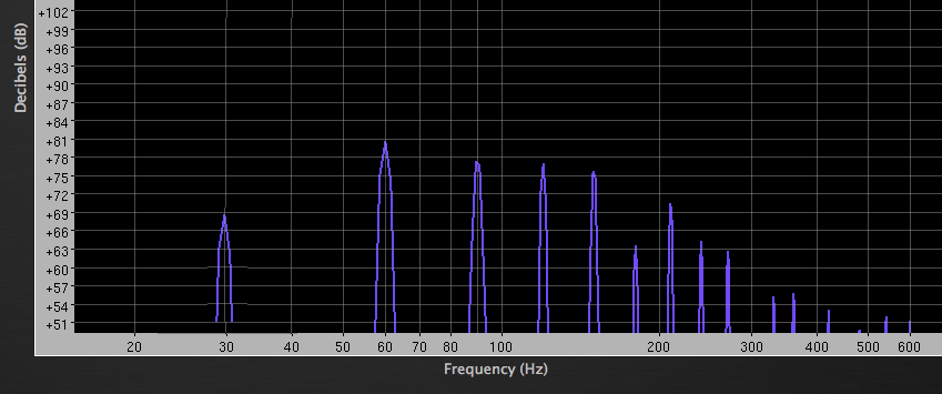

If the speaker has little output at 30Hz ("little or no interest") to begin with, the distortion may be louder than the fundamental (over 100% distortion), but you will still hear the even order harmonics as the same "note" (around the low B on a five string bass):
In a sealed enclosure, four times the displacement (excursion) is required for each halving of frequency to maintain the same level.
12dB more power is required to achieve the same level at 30Hz as 60Hz, if the speaker has the linear excursion capability.
Distortion may increase to over 100% with as little as 3dB increase in power over what is required to reach Xmax.
A "bass enhancer" like Microlab's proprietary X-Bass can selectively add harmonics over a limited range, (perhaps adding only 2nd and 4th harmonics to frequencies below ~60Hz, so can give the impression of a speaker that would require over ten times the power and four times the displacement.
The added cost of the proprietary X-Bass harmonic generator could be under $1, adding real bass down to 30Hz could easily double or triple the cost of the sub.

The second graph was an illustration of what the harmonic distortion of a speaker with little output at the fundamental would look like, the 30Hz figure was "transplanted" from the second harmonic in the first graph.

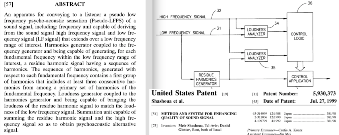

"MaxxBass extends the perceived bass response of a speaker by up to one and a half octaves below the speaker’s cutoff. This is
achieved by utilizing the psycho-acoustic effect of the missing fundamental. MaxxBass process generates higher harmonics
from the low fundamental frequencies below the (set) MaxxBass Frequency, and adds them back into the signal. Additionally,
MaxxBass process removes energy below the (set) MaxxBass Frequency from the input signal, thus reducing peak power and
speaker excursions requirements."
https://patentimages.storage.googleapis.com/10/ff/ec/5f7e3834111993/US5930373.pdf
MaxxBass patented their technology to do that in 1999, there have been many other patents granted that also utilize the psycho-acoustic effect of the missing fundamental since.
Since increased processing power cost has dropped so much in the last 25 years, manufacturers of small powered speakers can cheaply build in their version (or a copied version of some other design) of the effect.
