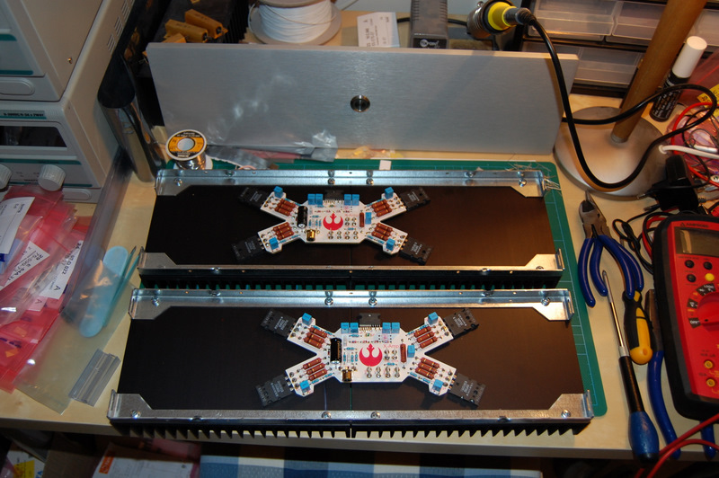

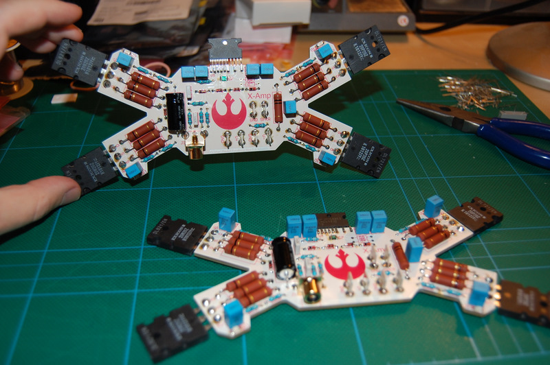

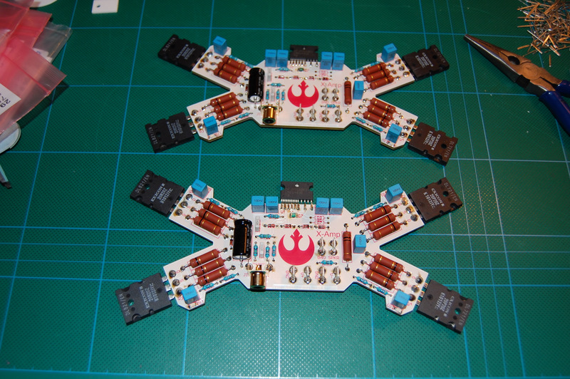

I've assembled two amplifiers now but I haven't powered them yet. First I need to figure out how much quiescent current I should bias the MOSFET's with and appropriate resistor values (R7 and R8). I'm thinking 40-50 mA per pair @ +- 60V.
Here are some pictures of the current progress.

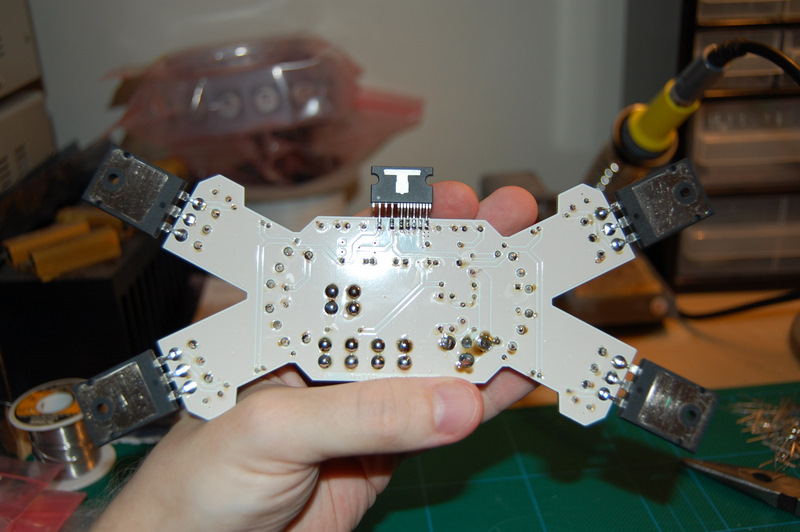

So I soldered on a 2k pot where R7 is supposed to go to find an appropriate value(s) for the biasing resistor(s). I preadjusted the pot to 300R which I figured would be safe (0.002*300=0.6V) and just to be extra safe I set the lab supplies current limit to 150mA/rail. I started turning the pot slowly and nothing happens and so I turn some more and nothing, I then measure the voltage across the pot to find it to be 2V and still nothing, no increase in current consumption and no voltage across the source resistors.
Hmm.. the voltage between POut and NOut is 2V and so the MOSFET's should start to turn on right.. after some headscratching I measure the voltages on the N-channel gates relative to ground to find them to be -1V and of course the voltages on the P-channel gates are +1V... curses!
So I managed to mix up pin 13 and 14 on the LME chip schematic symbol, I guess I was thinking POut - positive rail and NOut - negative rail not POut - P-channel and NOut - N-channel as I should have been...
Desoldering pin 13 and 14 and switching them around was pretty easy though. Luckily the mixed up pins are next to each other it would have been uglier if they were on opposite sides of the chip.
With the pins soldered in the correct places I got 45mA per pair with the pot set to 510R so no need to use R8 (the purpose of R8 is to be able to fine tune the quiescent current by parallelling two resistors to get a wider range of possible values).
