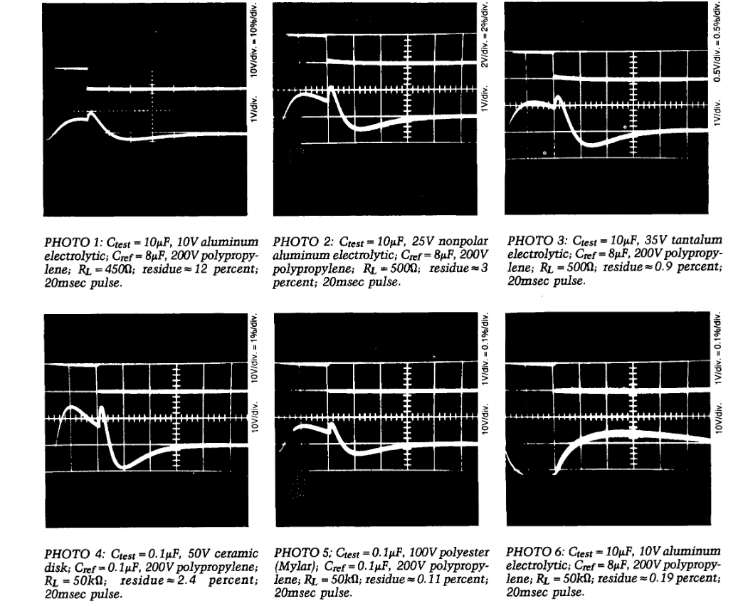

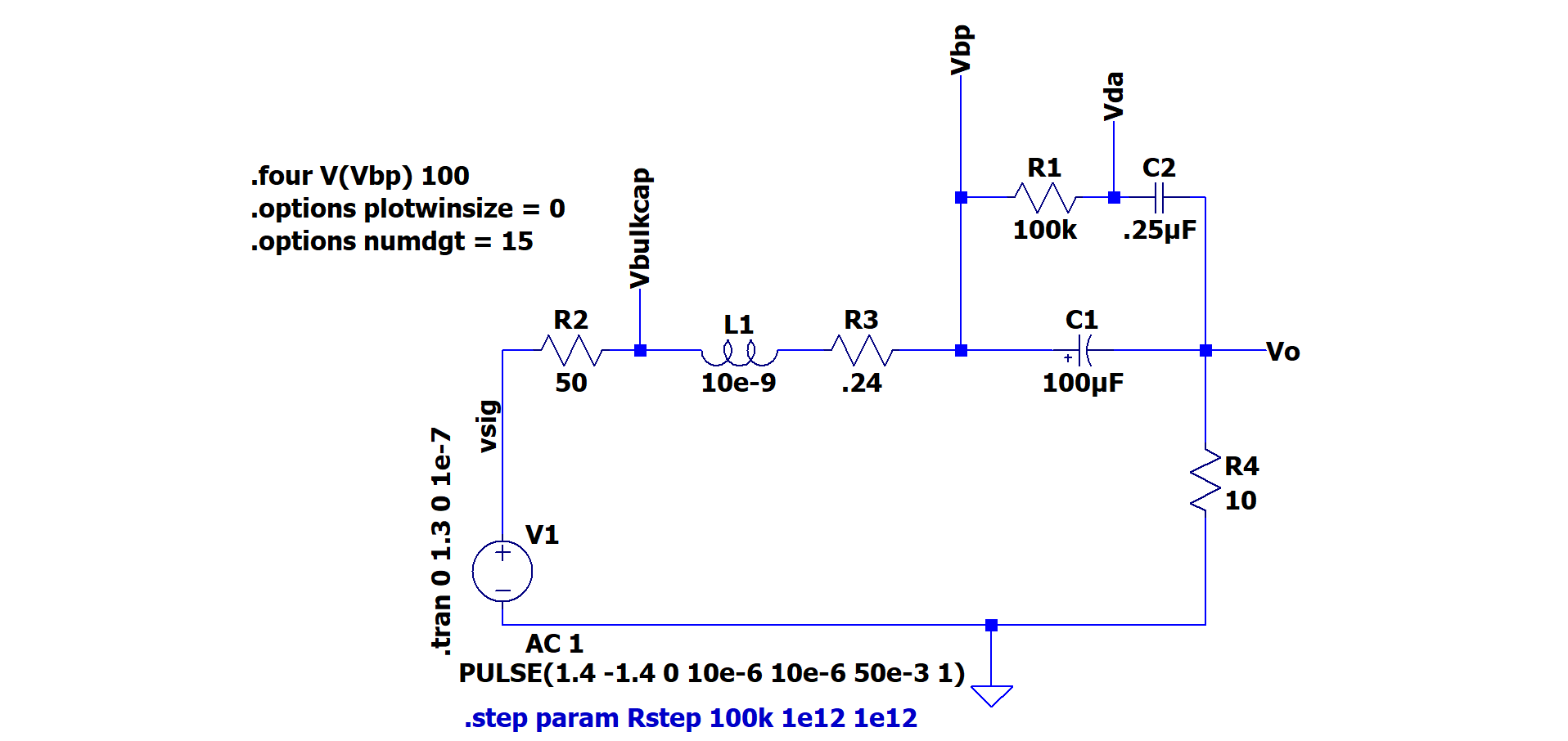

All of these phenomena are displaced down in frequency well below the stimulus. Look at the top left photo in your post where the 1 to 0 square wave stimulus is shown. Depending upon the fall time, the fundamental and harmonics are orders of magnitude higher than the DA-attributed photo below it which is what I was referring to earlier in this thread. The bottom plot below shows a stimulus with a 10ms on time and a 1 sec off time with a 10us fall time for a 100uF capacitor. V(vda) is the DA part of the capacitor and I(R1) is the current flowing in the series resistance part of the DA model. The kind of stimulus used to expose the DA component is highly unlikely with a real-world music signal, but it does show that DA components are shifted many orders of magnitude down in frequency and I'd add shows a remarkable correlation with Richard Marsh's photo. For normal bandwidth-limited audio signals with rise times measured in 10's of us (and especially now with digital audio where the real music signal is bandwidth limited to a shade over 20 kHz), DA is not an issue. So, the proposition that DA charge is released post the stimulus event in a manner that can introduce non-stimulus related harmonics that would smear the audio signal but not be measurable is unfounded in my view - and that's exactly what Richard Marsh's photos show, but his interpretation on these matters differs of course. There was quite some debate on this on the Blowtorch thread if you recall, and those making the smearing claim could not point to measurements or DBT in support of their hypothesis. If you run the analysis with 5 kHz square wave, the down-shifting of the DA component is even more clearly visible.
The photo below is with a 10uF electrolytic, and the DA component reduced by a factor of 10 as well

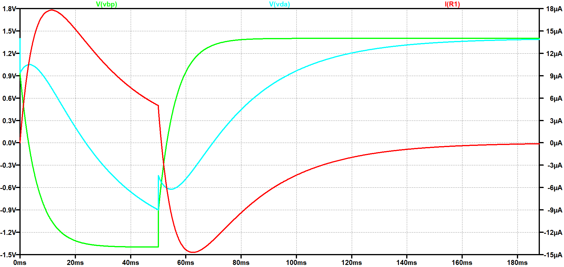

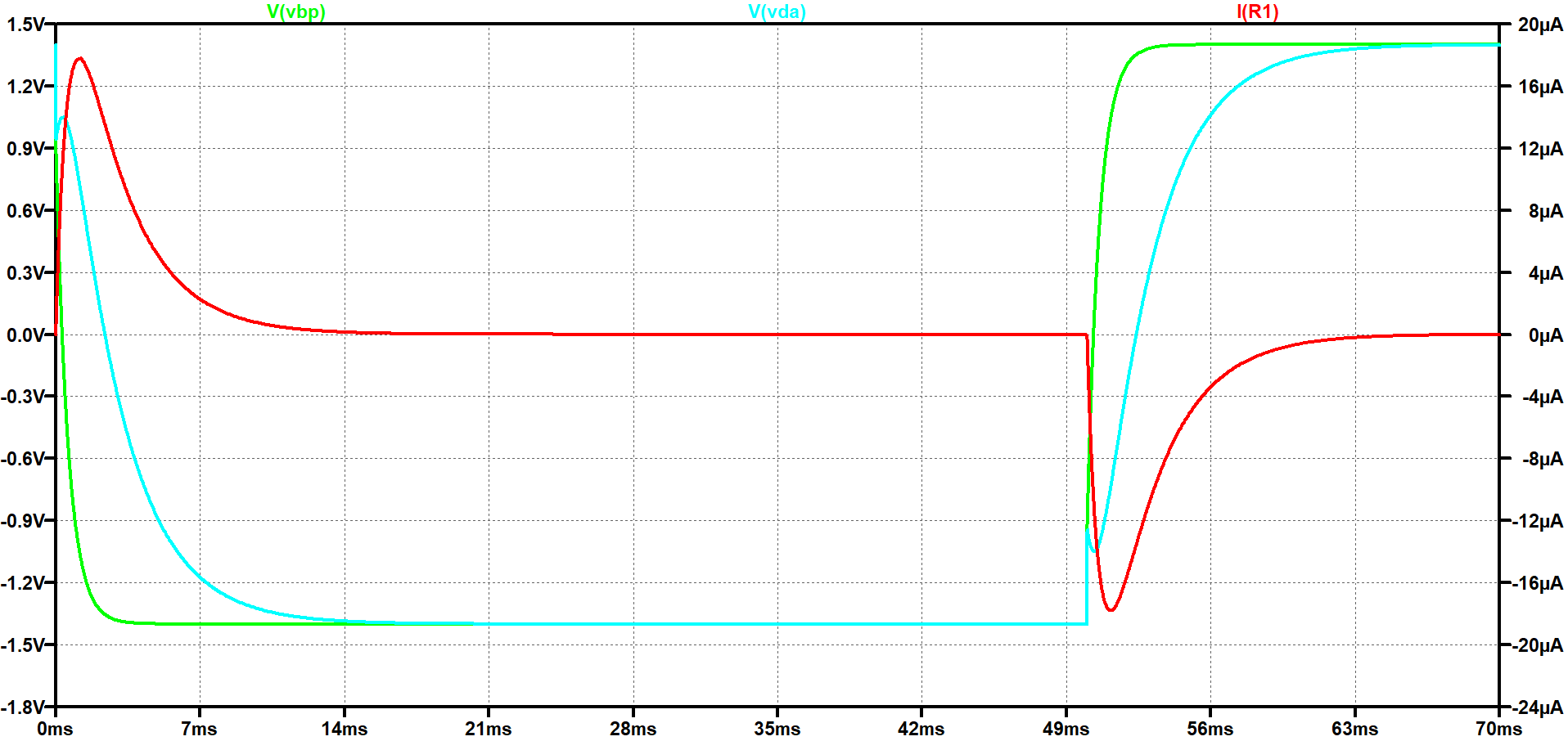

Here is a DA model

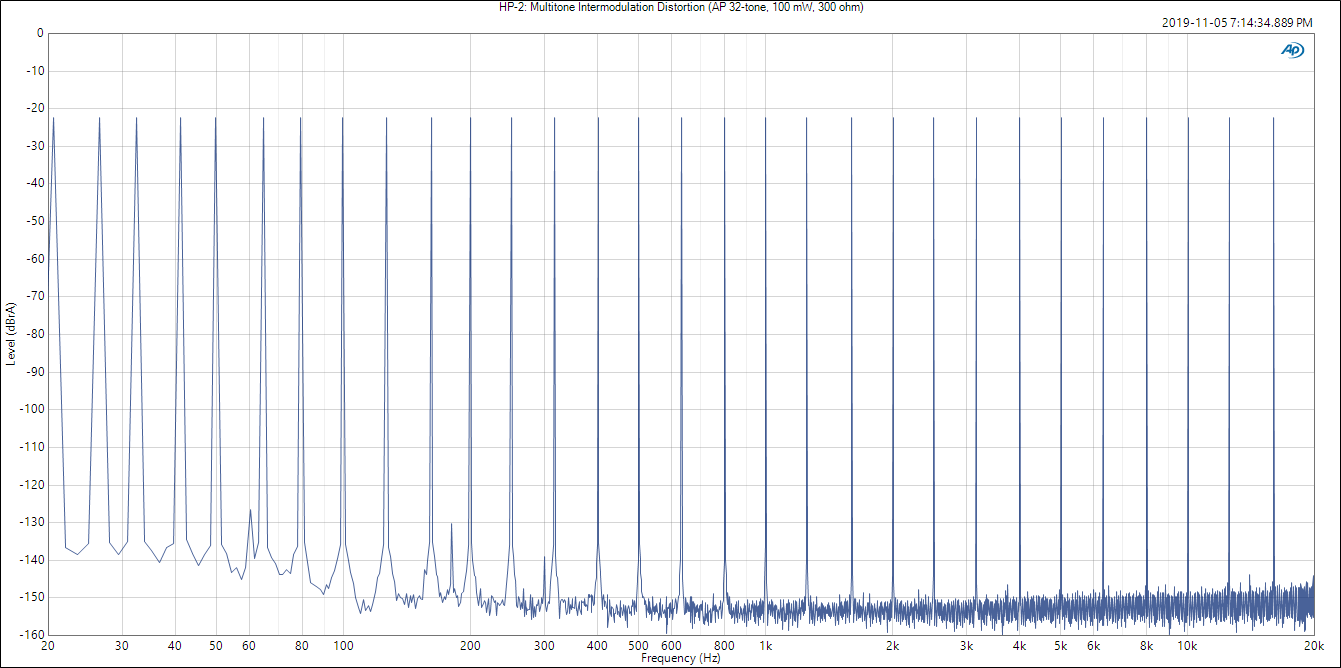

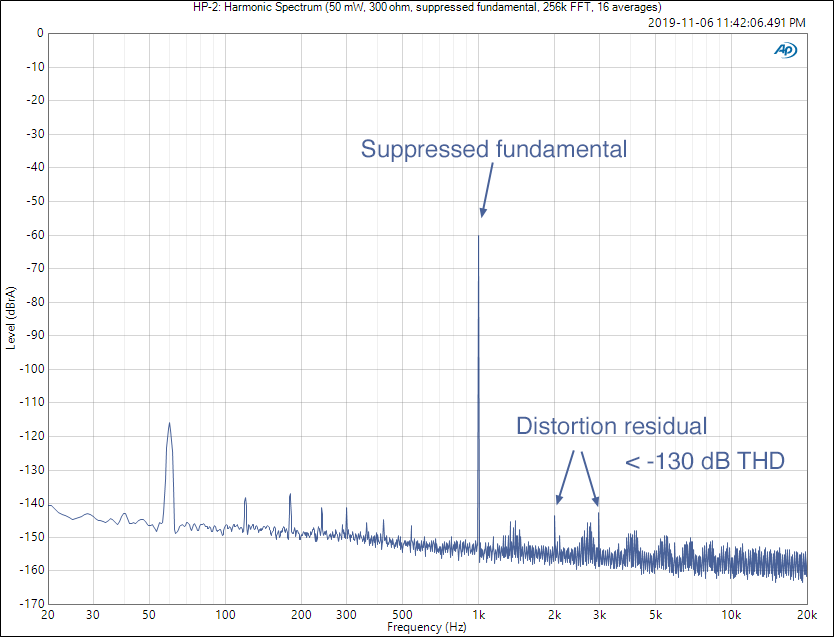

The distortion of the completed amp is so low that I had to resort to some tricks to even measure it. I did not have the APx555 at the time. "Only" the APx525 which bottoms out around -125 dBc on the analyzer (and -113 dBc on the source). So I designed a low-distortion notch filter and a 5th order elliptical filter to clean up the source. The resulting measurement is below with annotation added. The IMD products are from the measurement setup (SMPS powering the filters).
It's hard to argue that this isn't low distortion. Here's the multi-tone measurement:
The 60 Hz (and harmonics) are from my bench top DMM, which sits on top of the AP. If I forget to turn it off, there's enough mains hum that radiates into the input stage of the AP to show up around -130 dBV @ 60 Hz. That's one of my (very few) disappointments with the AP. It took me a very long time to find that. Ahhh... Life in precision audio. 🙂
In case you're wondering: If you're a frequent reader of ASR you'll notice that Amir places the peaks of the test tones at 0 dB, whereas in my tests they're at about -22 dB. That's because when you add up all the tones (and account for their relative phases) you get to the 0 dB point. I.e., 0 dB in my test is the RMS sum of all the tones, thus representative of the overall signal amplitude, where as Amir uses the RMS value of a single tone.
I believe the proper way to look at this is to measure the IMD 'grass' relative to the RMS value of the overall test signal, not the amplitude of one of the tones.

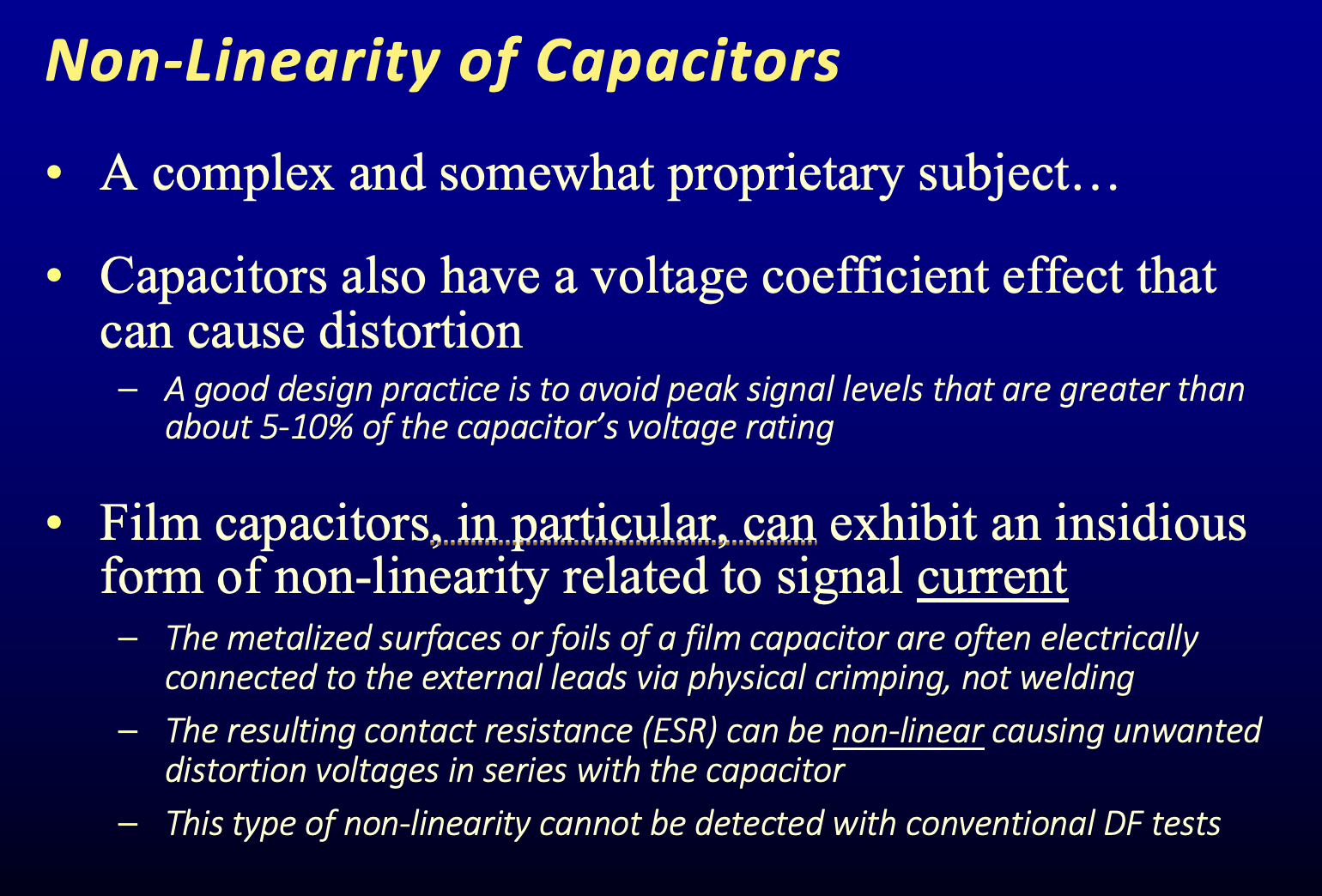

There's a slide deck by Bruce Hofer (AP) floating around in cyberspace. It shows that C0G/NP0 provides even better performance than PP film. I'll see if I can dig that up.

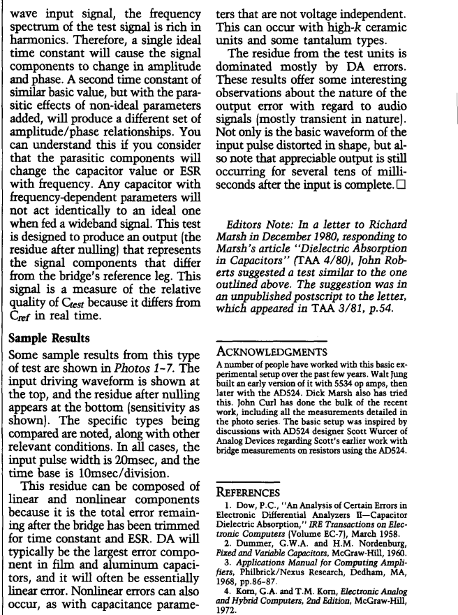

By coincidence I came across the original reference: Walt Jung & John Curl (1985) A Real-Time Signal Test for Capacitor Quality. Audio Amateur 4/85.Okay, test circuit? Equipment?
@nicoch58 would you please post the full reference (like I just did) or a link to the article instead of context-less blurbs? That way the rest of us can better relate to what you're trying to convey and you also credit the original authors.

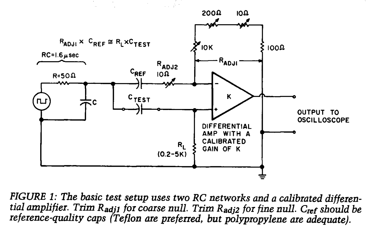

Jung & Curl set up a bridge using a known good reference capacitor and the capacitor under test. They then applied a step input and measured the resulting output.
That's an interesting test and it would likely be very relevant for something like S&H amplifiers as we discussed earlier in the thread. Whether the conclusion also applies for sine wave testing remains to be seen. It would have been easy for Jung & Curl to push the sine wave button on the signal generator and measure, but sadly their article only shows the results of step response testing.

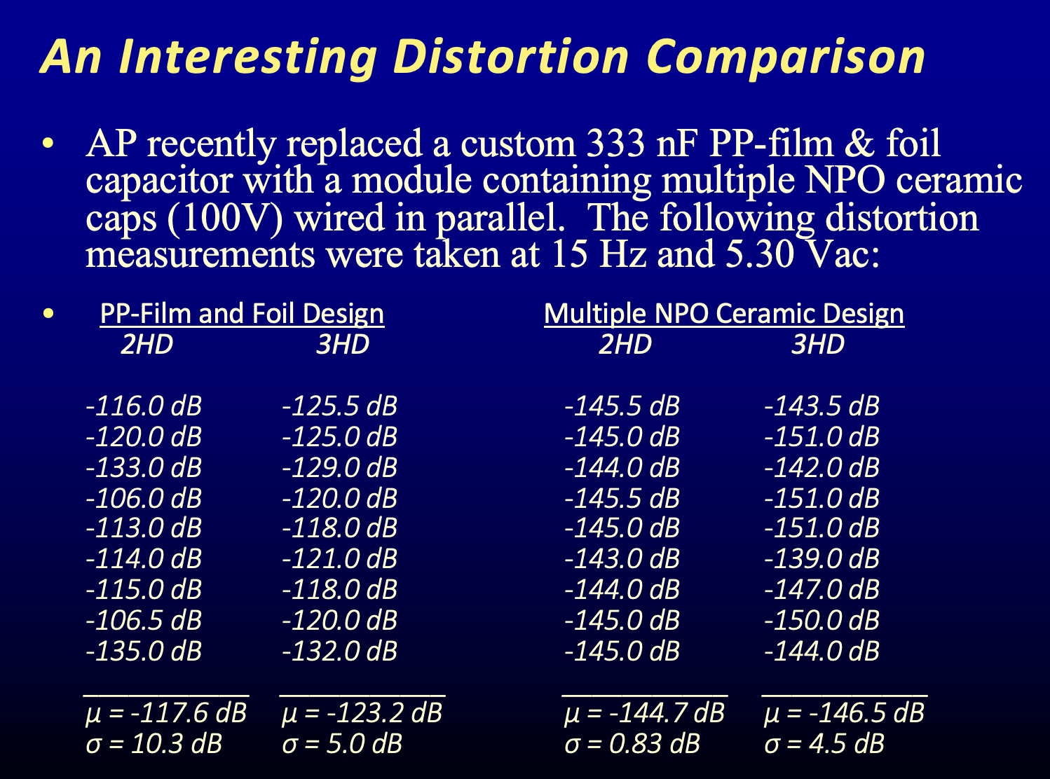

Found it!! Bruce Hofer's talk is from the 139th AES Convention in 2015. Here're some relevant excerpts regarding ceramic vs film caps.
From what I understand, the APx555 uses many capacitors (and resistors) in parallel to drive the distortion down. For the ~$20k cost adder of the 555 relative to the 525 there should be room in the parts budget for quite a few NP0 capacitors. 🙂
Tom
Tom
It would be interesting to see if there was a difference between film and foil construction. They indicate a mix, which would be odd.
Anyway, I can believe that data.
Oh, I agree. The article is from 1985, so the body of knowledge is larger now. You have to start somewhere. Also, their end application might not have been audio.I think the Jung / Curl tests were done in a way to show something.

"PP-film and foil" refers to polypropylene film and metal foil. Think Wima FKP. It's not a mix of different capacitor types.It would be interesting to see if there was a difference between film and foil construction. They indicate a mix, which would be odd.
Tom
