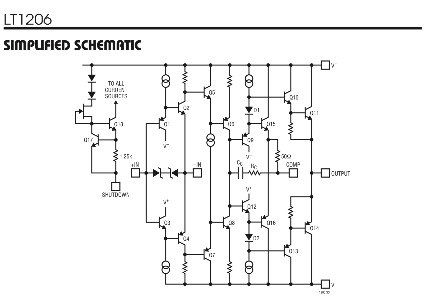

To be more "on topic" specific to capacitors/capacitance I am currently designing an I/V using the LT1206 CFA. It supports varying the quiescent current to higher values as seeming used of advantage in the AD811, a CFA that appears gaining some favour. This allows for more control over the slew rate and high frequency performance, being useful in stabilizing the drive into higher capacitance loads, specifically interconnect cables, etc.
https://www.analog.com/media/en/technical-documentation/data-sheets/1206fb.pdf
Looking first at page 13, it shows a couple of examples a "Precision ×10 Hi Current Amplifier" and "Low Noise ×10 Buffered Line Driver" that both show a dual operational amplifier network with "an output stage configured with amplification", using an CFA LT1206. Being used as an "output stage" does not deny the LT1206 is still a CFA, notwithstanding what Self and Cordell might otherwise have concluded.
Looking at page 8 shows the simplified schematic of the LT1206. The schematic does not contain a current mirror, rather instead contains a current magnifier of unknown multiplication, being dependant upon two resistors of undisclosed value, the resistor in the collector of Q2 and the resistor in the emitter of Q6. The base/emitter drop across Q5 approximately equals the reverse base/emitter drop across Q6, meaning that the volt drop across the two resistors is approx. equal. It isn't necessary that these values be equal, and are unlikely to be so. The implication is that CFA designations are not reliant upon the currents being equally mirrored, rather can be magnified by the hfe of bipolar transistor as well.
As far as the diamond buffer goes (as being conditional upon its use to be identifiable as a CFA), does Pedja's implementation of an I/V using an AD844 CFA without implementing that buffer turn it into a VFA?
There are numerous ways to configure the 2nd stage (same applies to VFA). However, the majority use either a current mirror (typically IC types although the 1206 is a bit different) or a more conventional VAS (discrete power amps especially ). The 1206 is a bit unusual, but I think that’s primarily so it can drive very capacitive loads Looking at the feed forward/bootstrap circuit around Q15 and 16.

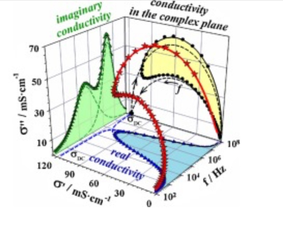

I’ve been doing a lot of rooting around on electrolyte conducticity - unfortunately most of the papers are behind paywalls. The behavior of electrolytes with frequency, current and concentration looks to be complex. It’s probably electrolyte behaviour at LF due to low current flow that causes distortion. There’s a lot of research going on into electrolys from what I can tell because of battery development and, separately, in the biological field. The plot below is for an electrolyte over 10^2 to 10^8 Hz - I’m looking for plots of frequency and current vs conductivity linearity. Anyway, digging continues.
