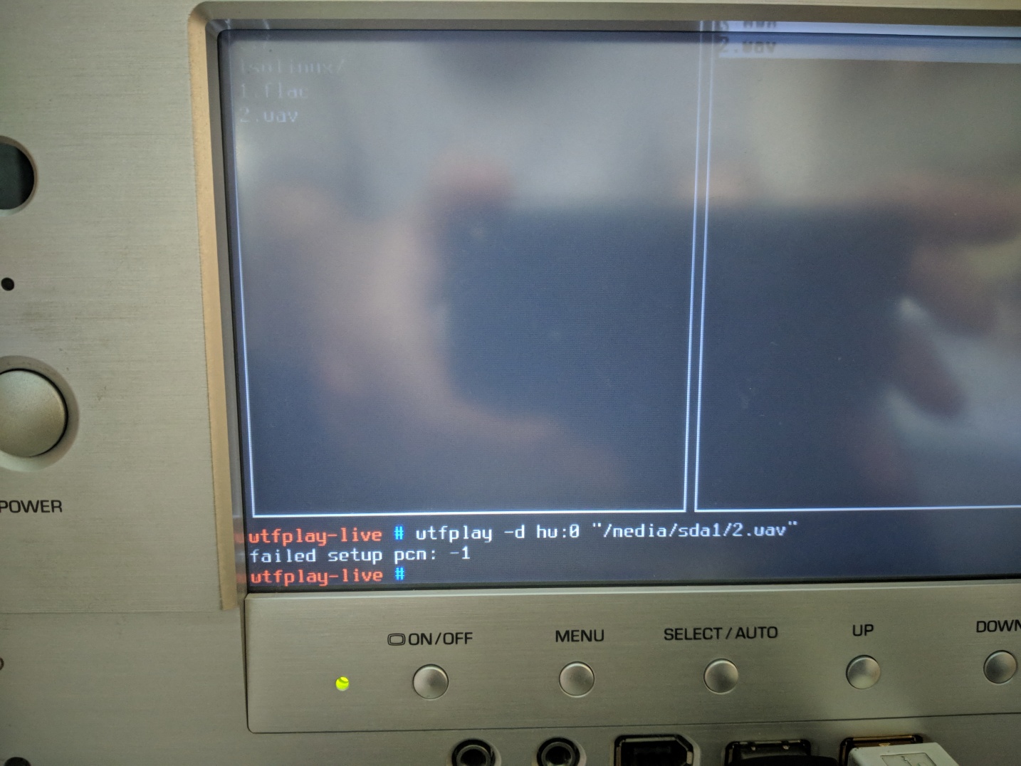

"Failed setup PCM" looks like the soundcard driver did not accept hw_params at snd_pcm_open. The driver linux/rme96.c at master * torvalds/linux * GitHub looks quite picky about supported values. Do you check all hw_params (with snd_set_xxx_near etc.) before requesting them in snd_pcm_open?

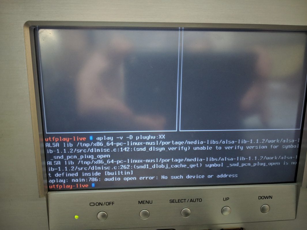

A good way to debug is running aplay -v -D plughw:XX with all the requested params - the plug plugin (via the verbose parameter of aplay) will report what changes to the params the plug had to do to satisfy the driver.
To eliminate the influence of the platform and processor launched wtfplay on the 775 platform (core2duo). The result has not changed. Problem in audio driver
This is is very interesting. It does not look like anything related to your CPU in particular.
The error message that you got happens after the file is fully loaded and prepared for playback. I do not see why WAV or FLAC would make any difference at that stage. Unless there is a very nasty bug in the software that manifests itself in a very special circumstances (software and hardware wise).
May I ask you to try a couple of other WAV and FLAC files? I am interested in determining if this is systematic, that is the player fails with always fails with FLAC and always succeeds with WAV.
You could also take a FLAC file that fails, unpack it with flac (flac -d <file>) and try playing the resulting WAV.
I apologise if this looks like a lot of work and thank you for your effort so far. If there is a bug there then I really want nail it. That is why I would like to to get to the bottom of this.

This is the launch of the wav file
Not the problem with the driver. Just as phofman says - the driver is it picky about the parameters.
Basically, it looks like RME96 requires parameters to match a fixed audio buffer of 64KB. Furthermore, the period size is limited to two values: 2KB and 8KB. Hopefully I am reading the code right.

Please try passing the above parameters player:
Please note that the default number of periods in wtfplay is 3. I still do not know how a WAV file could be played while FLAC could not.

With these parameters I heard a sound!
many thanks! I listen carefully and compare with the cmp2 project
frd__: Typically alsa players adjust the requested period/buffer values with the xxx_near alsalib calls to make sure the pcm device will accept the hw params. E.g. sox/alsa.c at master * jacksonh/sox * GitHub , mpv/ao_alsa.c at master * mpv-player/mpv * GitHub , MPD/HwSetup.cxx at 256cfc545ddf05ed72784922f3ec038da6747032 * MusicPlayerDaemon/MPD * GitHub
