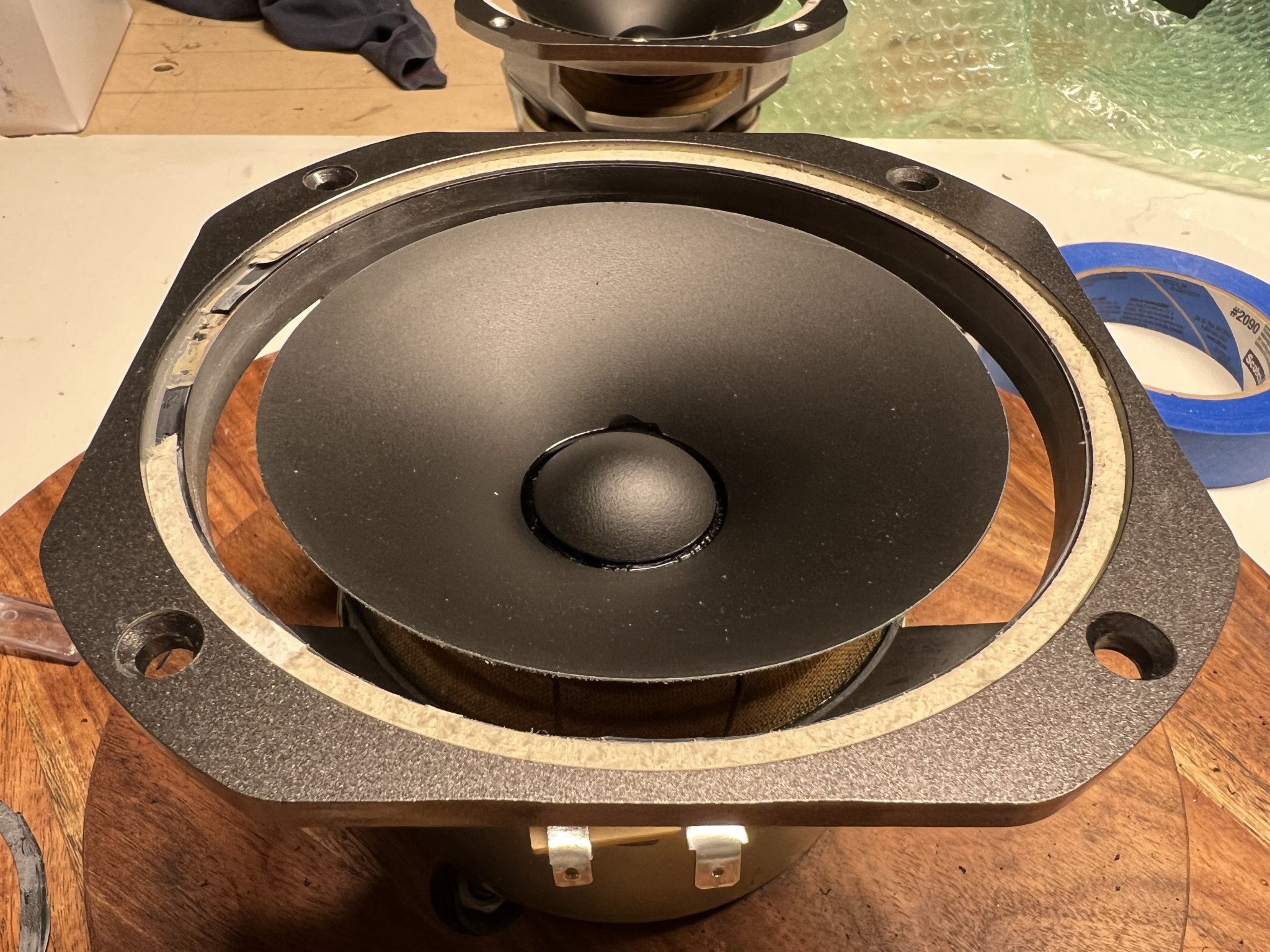

Hi Guys,
I have a pair of AST-S1 speakers I bought from ebay and the previuos owner did a dodgy repair on the rubber surrounds and shagged them 🙁
Does anyone have or know where to get a couple of replacement woofers?
I am open to refoaming them however the kits I have bought to date have been the wrong size (up to 3mm out of spec.....).
Cheers
Matthew

Replacement Foam on AST-S1
Thanks for the reply.
I could cut and join the foam surround I have to fit however it would be an extremely time consuming job cleaning the mess the last owner made (with what looks like Araldite).
Does anyone know whether these parts would be available? Is Yamaha Japan worth contacing?
Curious and desperate.
Matthew

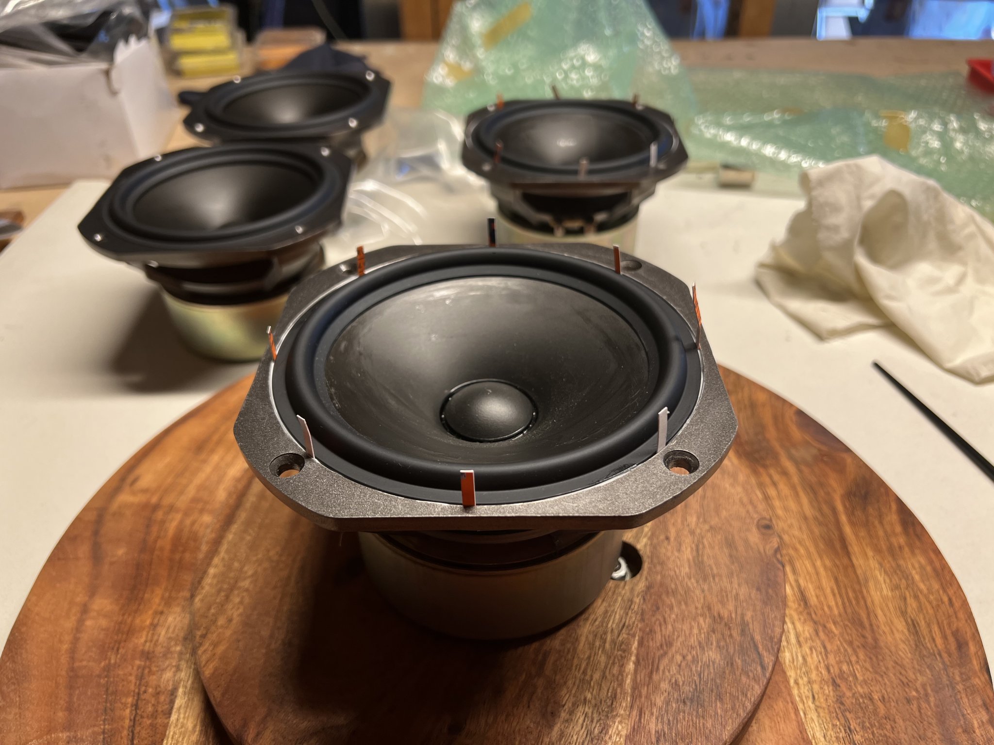

AST-S1 JA-1612 Rubber Surround
Well that took some time but I found a suitable replacement.
Turns out that the Dynaudio 17w75 is the same size 🙂
Dynaudio 17W75 - 1x Genuine RUBBER surround for repair
And done 🙂AST-S1 JA-1612 Rubber Surround
