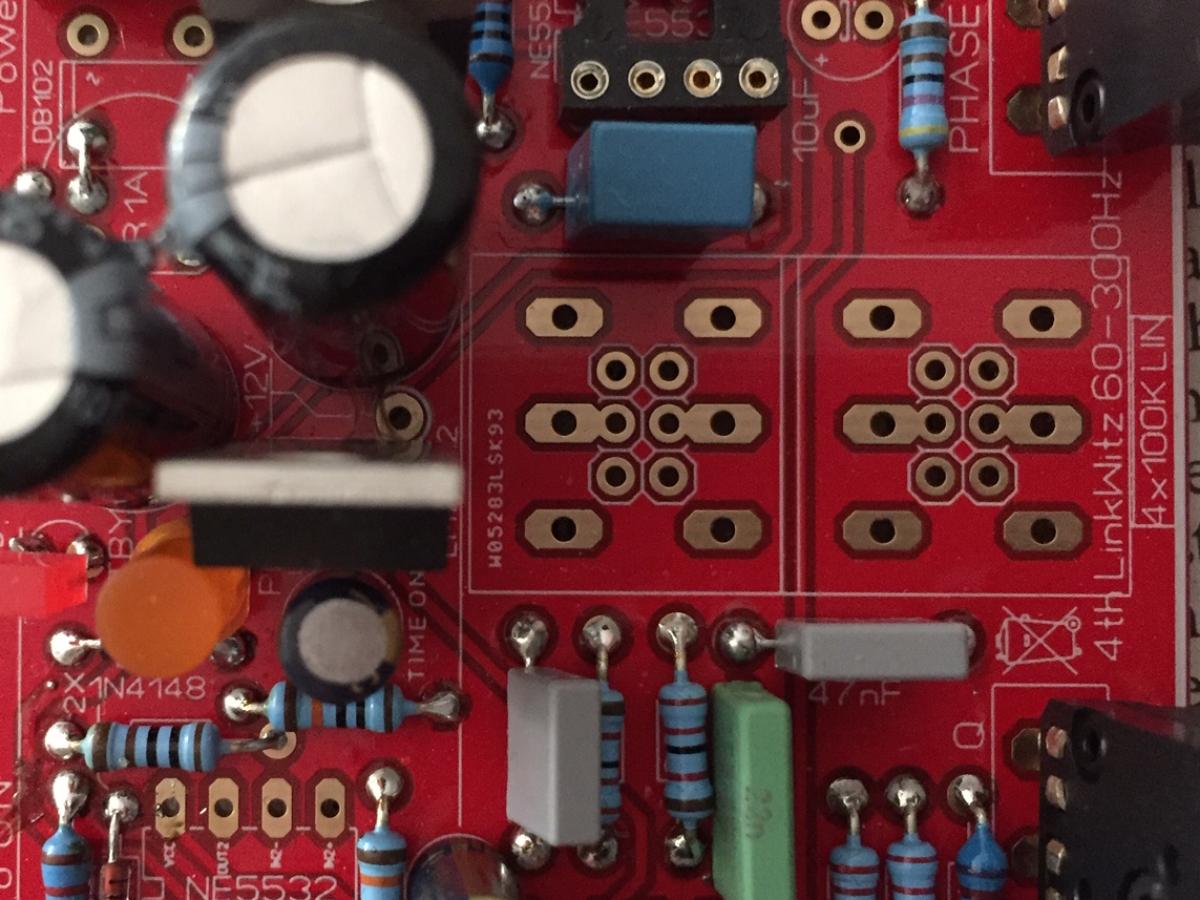

I'm looking for two 9 or 16 mm 100 quad potis in 100k ohms linear.
After browsing through all of the Mousers, Digikeys and known shops, I am a little perplexed because many producers have listed quad potis in their data sheets, but nobody has them in their inventory. I am currently building an LC audio subwoofer filter and need two of them.
Does someone perhaps have two quad potis in the home stock or does someone know a shop that still carries this versions?
Thank you in advance!

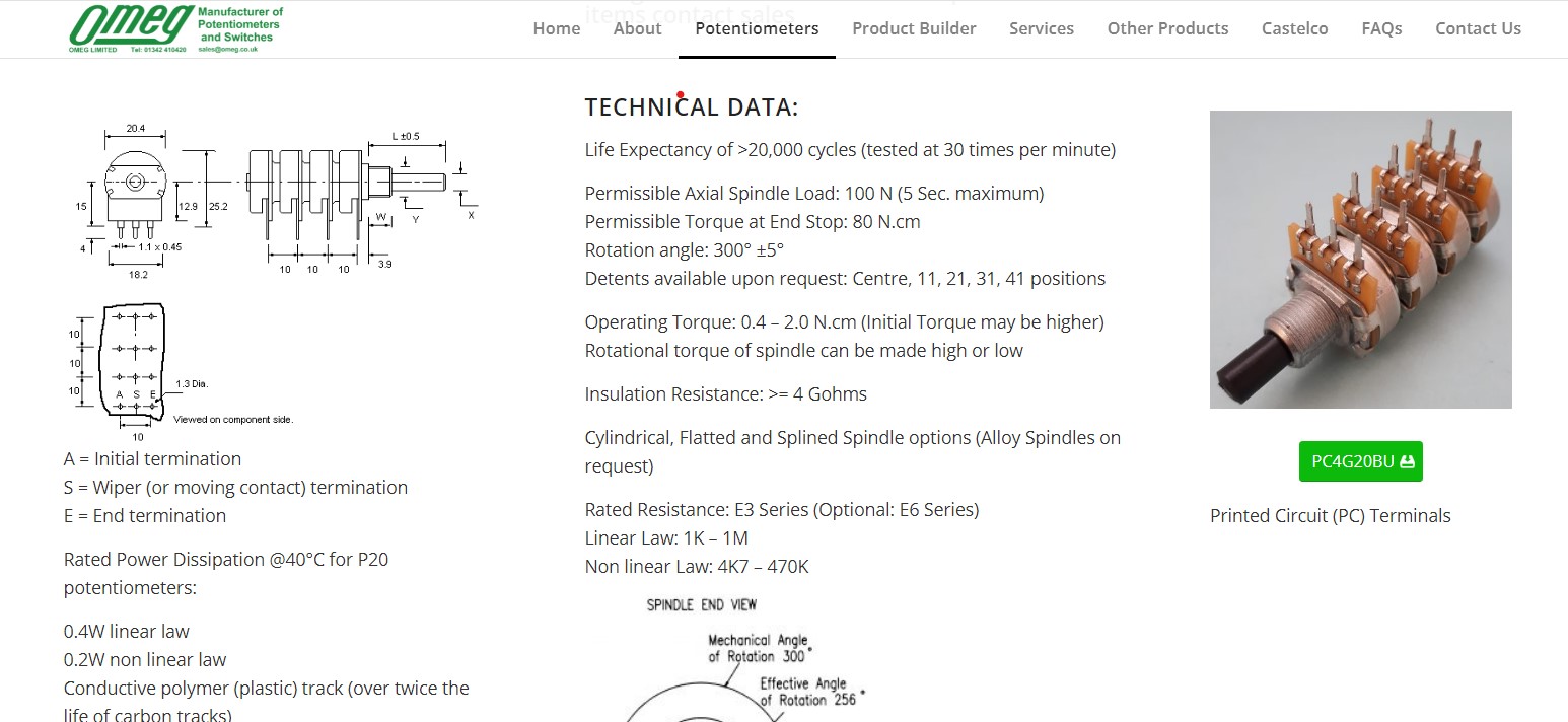

I've never seen them listed anywhere (usual suppliers) but they are available.
OMEG manufacture these. Might be worth approaching them if you can not turn anything up.

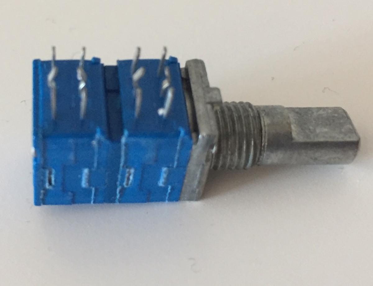

The only available quad poti is a 9 mm one from Bourns (PTD904-1015F-A104 ), it's logarithmic but better than no pot.
The miniature poti does not fit on the soldering points of the board and I thought about whether you can separate the two rear of the four levels and connect them with a coupling. Has someone made experience with the disassembly of such a poti?
Theoretically, you could also place four rotary trimmers one behind the other and connect them mechanically with one common axis. However, I have not yet located suitable trimmers
Thanks bOTL! Unfortunately, the RK27 quad poti is over-dimensioned in terms of quality and dimensions, there is only enough space for a 16 mm or smaller poti.
That's a good idea. There would be different conductor lines to be laid, the biggest problem is probably my holes, which would make the board Swiss cheese. I could use a breadboard as a drilling template, but it would be difficult to position it well on the assembled board. If I can't find a suitable potentiometer, I will probably wire the 9 mm poti freely.
