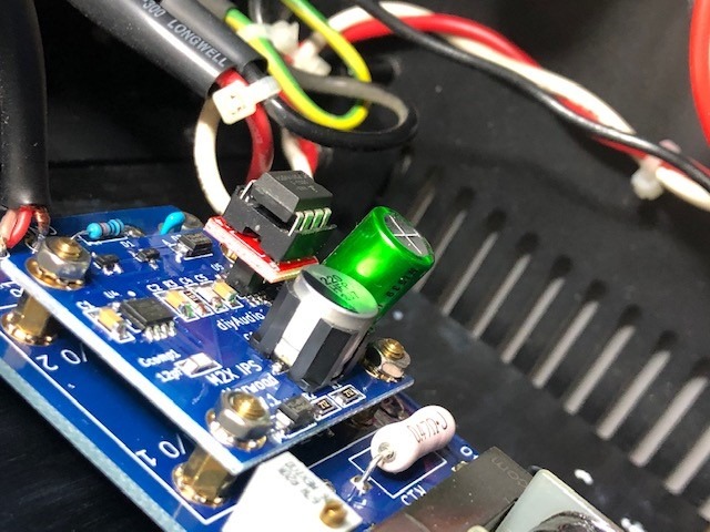

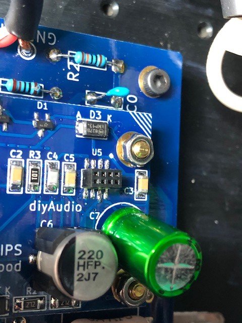

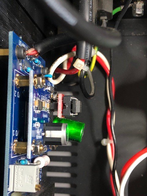

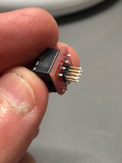

Reporting back on the DIP8 version of HA9P5002-5 - I cannot tell any difference to my SOIC boards. Did have to leave the input cap soldered high up off board, because the adapters I bought needed a 1/16" to clear, easy eough to just push that cap over a tiny bit. Also used plug-in sockets, otherwise would not have had access to one of the connecting bolts for the daughter board.
Very happy with the Norwood and also the DIP-8 op amps. Still have the SMD version on order, so we will see if I ever change them out when they finally arrive.
