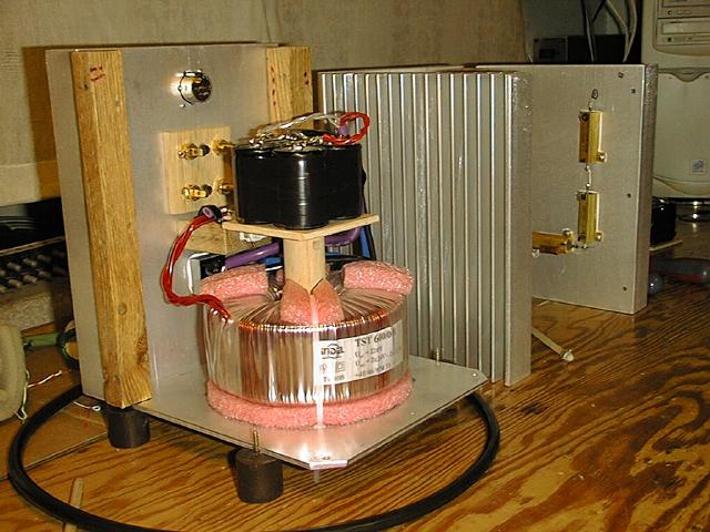

Re: Transformer noise
How big a transformer are you using? - 600 W per monoblock. See attached picture.
How hard are you loading it? - Power supply delivers +/-32V DC and acording to Mr. Nelson Pass SOZ power performance drawing I reach 300 W loading what results in max 16 W output power on 8 OHm speaker.
What brand are you using? - Brand is unknown, I bought transformers on the legendary electronic Sunday market known in Warsaw as Volumen. I hope now better transformers are available, I must go there some Sunday.
The transformer has to have at least twice the power rating of your amplifier - Yes of course - the power rating is approx 300 W, according to Mr. Pass advices. I remember at the beginning I had a problem with fuses delivering electricity to my flat - afterwards I applied thermistors on monoblock AC line.
I think my transformers have loose-fitting construction, what generates buzz; maybe the best idea is to flood them in synthetic resin in vacuum, but it is not available for me.

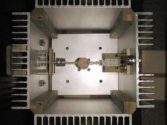

isolation technique
Hi Carpenter,
An isolation around transformer is very primitive, I know.
I had an idea to put isolation between all metal parts of housing, see attached foto. You can see an oak. This is because I afraid about distortions caused by rotary current which is potentially possible and unpredictible like thunderbolt. I remember I worked with people, who worked at projects of amplifiers, radio amplifiers and measuring devices. In one case, that was radio-amplifier, they discovered a strong rotary current generated by transformer at a closed loop created by metal parts, about 2 Amps. Such a current caused a very strong radio distortions. They cut a metal loop and phenomena dissapeared.
