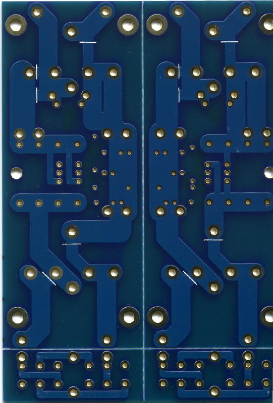

OK, I searched a little bit ,and I think that we are all clear that on Peter's boards, the Caps C5 and C6 are optional.
If we DON'T use C5 & C6 then should we run a short length of wire between the holes on the boards where terminals of the caps would be or not?

I just realized that if we don't use C5 and C6 capacitors, we cannot solder to two ground holes near them. They would be not connected to anything. Correct?
ipolyakov said:I just realized that if we don't use C5 and C6 capacitors, we cannot solder to two ground holes near them. They would be not connected to anything. Correct?
Not really, even if you install the caps, you still need to provide the ground connection: those two ground holes are optional too.
If you look at F4 amp schematic, you will notice that power ground is not there, only the input signal ground.
The power ground is located on PS board, and this is where speaker ground connects. Signal ground reference is taken from PS board, with a separate wire, and connects to GND point on amp board which is beside SG point (SG is used for ground connection from input RCA).
The GND on the opposite side of the board is only for C5/C6 and if those caps are being used you need another ground wire from PS board.

The traces to be cut are on PS board. The locations are marked with white lines in a bottom layer. You cut them only if you are using Jensen 4 pole caps, this way the potential 4 pole design offers can be fully utilized.
