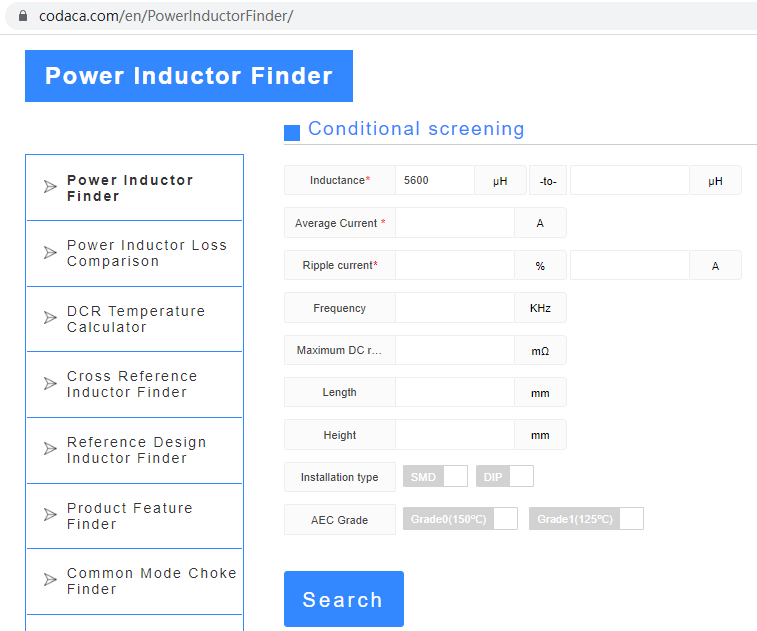

Hi dear, To select an inductor need to know that information.
L: inductance
Rdc: Max
Isat and Irms
Work temperature
Application

https://codaca.com/en/PowerInductorFinder/
Input your condition and search then easy to get what you want.
if you do not have the current, please send the circuit drawing for reference.

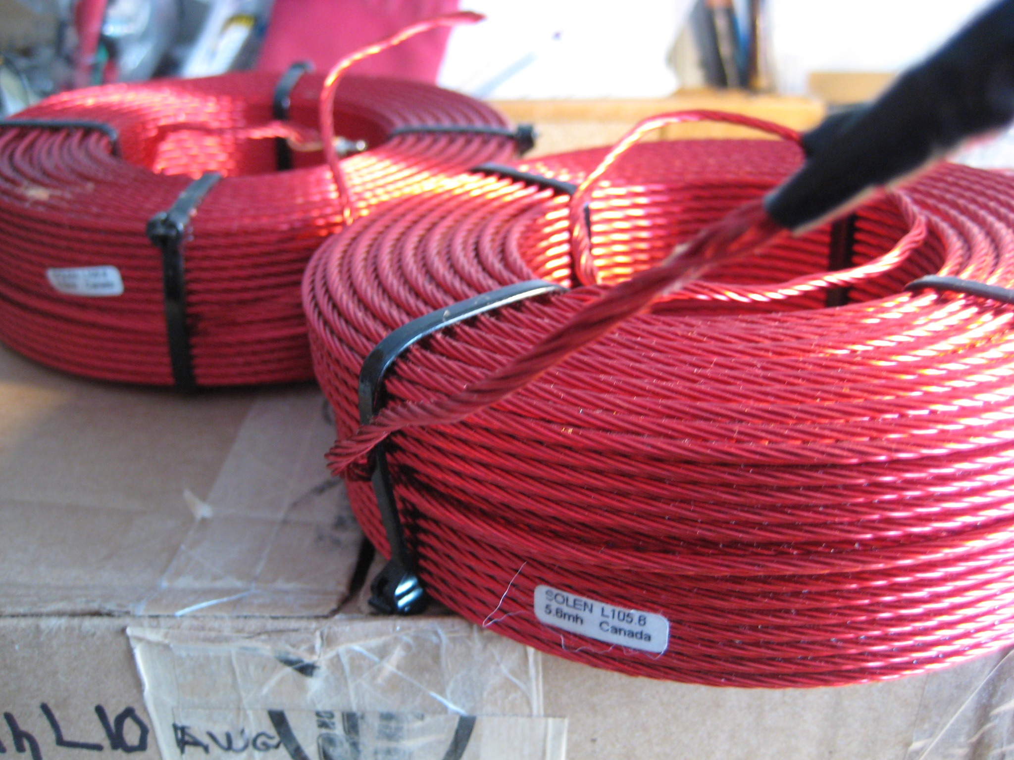

If you can't find anything on your side of the planet:Low pass for a pair of 6" woofers.
Would like Rdc under .5 ohms.
https://shop.speakerenco.nl/56-mh-095-mm-hq4345
Designed for loudspeaker crossover filters. 0.51 ohm, so just missing the spec.
https://shop.speakerenco.nl/56-mh-132-mm-hq5846
This one is 0.22 ohm, so well within spec, but it's considerably more expensive.
They have two in stock of each of these models.
I wonder how non-linear those are. It usually doesn't matter much for SMPS applications as long as the hysteresis losses are not too large, but it causes distortion in a loudspeaker crossover.https://codaca.com/en/PowerInductorFinder/
