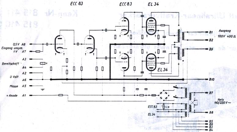

i just obtained two never used wsw siemens ultrallinear power amps, model 815 410 G from 1963!
They were made for rack mounting but the problem is the output transformer which is modeled for 100V lines!
How can i change that and use the amps with regular speakers??
The other question concerns the fact that there were no tubes in the amp (Ecc84 and El34), so it seems that i have to get new ones. Any suggestions?

Welcome to the forum.
I doubt that the amplifier used ECC84, ECC83 is far more likely.
The 100V line thing is more of a problem. Have a look at the connections on the output transformers to see if they can be set for conventional loudspeakers. If the transformers can't be connected differently, they will need to be replaced. Fortunately, transformers for EL34 amplifiers are very common. You need to know whether the transformer has ultra-linear taps. If it has five primary wires, with two going to each output valve, it's ultra-linear, but if there are only three, then the valves are probably operating as pentodes.

Surely you could simply place a cheaper matching transformer post-output pre-speaker?
Ailbeit it might be better off replacing the output trafos afterall they /are/ PA :\ which are usually of a lower quality.
I'd say your best bet is a Hammond replacement as you might be able to take measurements of the old one and give an exact match: Hammond
