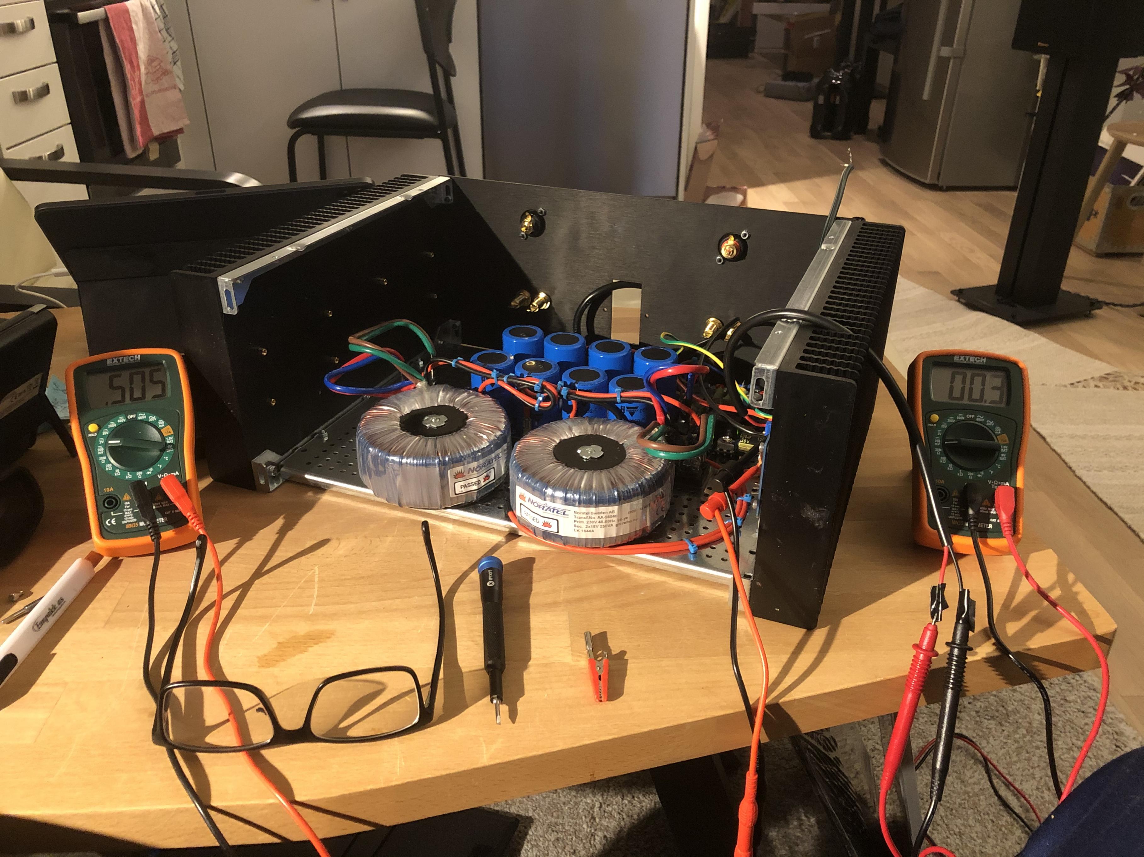

first watt f6.
i manage to connect wrong -+ voltage, is the transistors/ transformer/jfet destroyed ? smoke from resistor .47 and .56

first check them with buzzer/diode test
in case that you molested just one channel, compare it with unmolested one
report here
report here
thanks going to check in the morning when i am not tired ( tired=smoke from resistors)) going to report back
