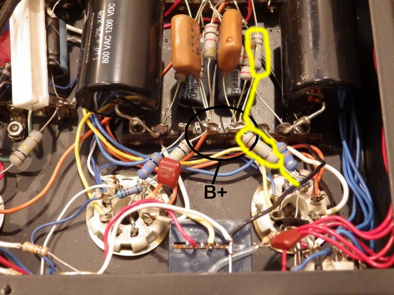

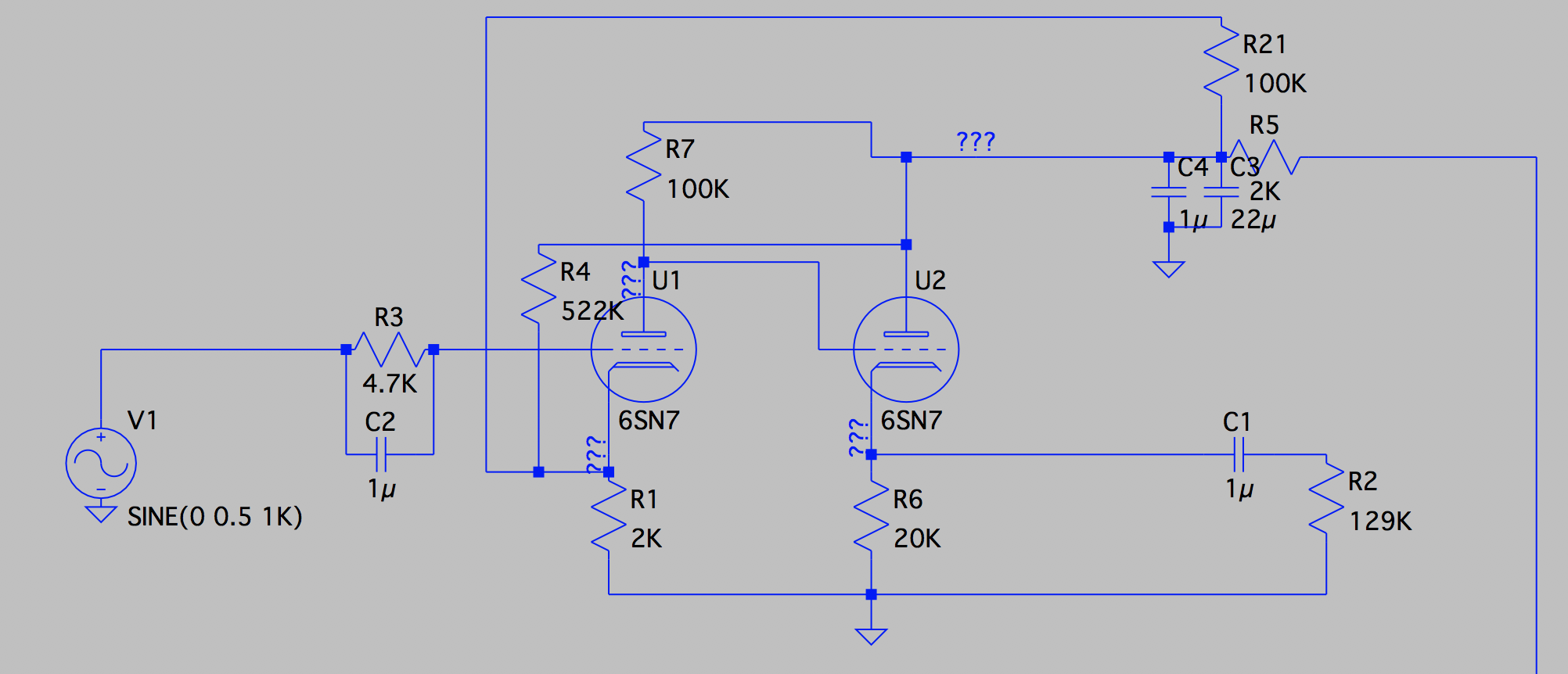

there's a 100K resistor that comes from 6SN7 cathode 1 and connects
to the top of the 100K plate resistor. I've seen no such technique in the
books and online articles I've consulted.
Sending DC current into the cathode resistor is a partial fixed bias.
It's a way to use a smaller cathode resistor than the DC bias point
would normally need, for higher AC gain without a bypass capacitor.
The diagram has the R21 (100k) in parallel with the R4 (522k). This is not likely.
Thanks, rayma.
R4 (522K) goes from pin 6 (K1) to pin 2 (P2).
R21 (100K) is weird. A wire goes from pin 6, to the "Lo" row of the Hi/Lo gain switch, to a tag strip where R21 connects to R7 (the other 100K). The components in the "Lo" row of the Hi/Lo gain switch are connected at all times. (The "Hi" row, when selected, adds a resistor of undeterminable value to a cathode bypass capacitor for K1.)
Looking more closely, technically speaking R21 also connects to the low end of dropping resistor R5 (2K) and its two capacitors (C3, C4) that go to ground, as in the revised attached schematic.
I also added an annotated picture inside the amp, where you can see the two 100K resistors in series outlined in yellow. The 2K resistor that shares the connection is R5.

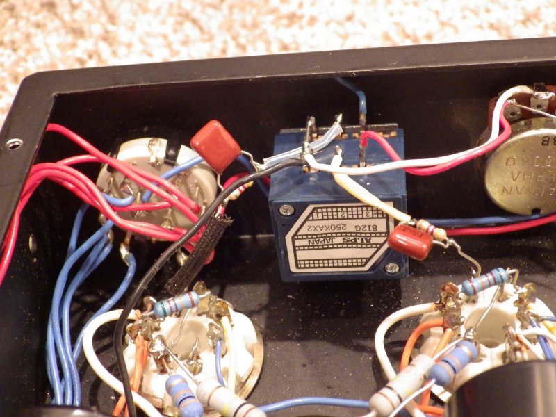

It is quite possible to have AC heat and low hum in a Line stage. Guitar amps do OK.
Your heater wires are untwisted and audio parts are really close to them.
Thanks, PRR.
Just FYI, all the pics in this thread are examples I found on the web. My heater wires are twisted tightly but they do follow the same path as the ones in the pictures. They pass between the PS filter section and the line of tubes, alongside a bunch of HT supply wires and across ground circuit wires, and under the right channel output capacitor.
I had thought it was more important to keep them away from input circuitry, but I’ll generally tidy up the amp and see how I can reroute things. Rehoming it in a new chassis with a different layout might be necessary.

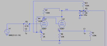

What would be a reasonable value for the input bypass capacitor in this amp (pictured between volume pot and input grid below)? There's a 4.7K stopping resistor on the 6SN7 input bypassed by what appears to be a polypropylene film cap.
The rest of the circuit is set for an LF cutoff just below 4Hz. So following that pattern, the input bypass cap could be ~10uF:
159155 / 4700 / 10 = 3.39Hz
I've never seen an input bypass cap before, though, so I'm not sure what common practice might be.
I'd remove those caps across the series grid resistors, they'll only pick up noise and RF.
That is not standard practice.
Well, I was wondering about adding them in. The amp pictured is not my own. I'll just leave the caps out then.
