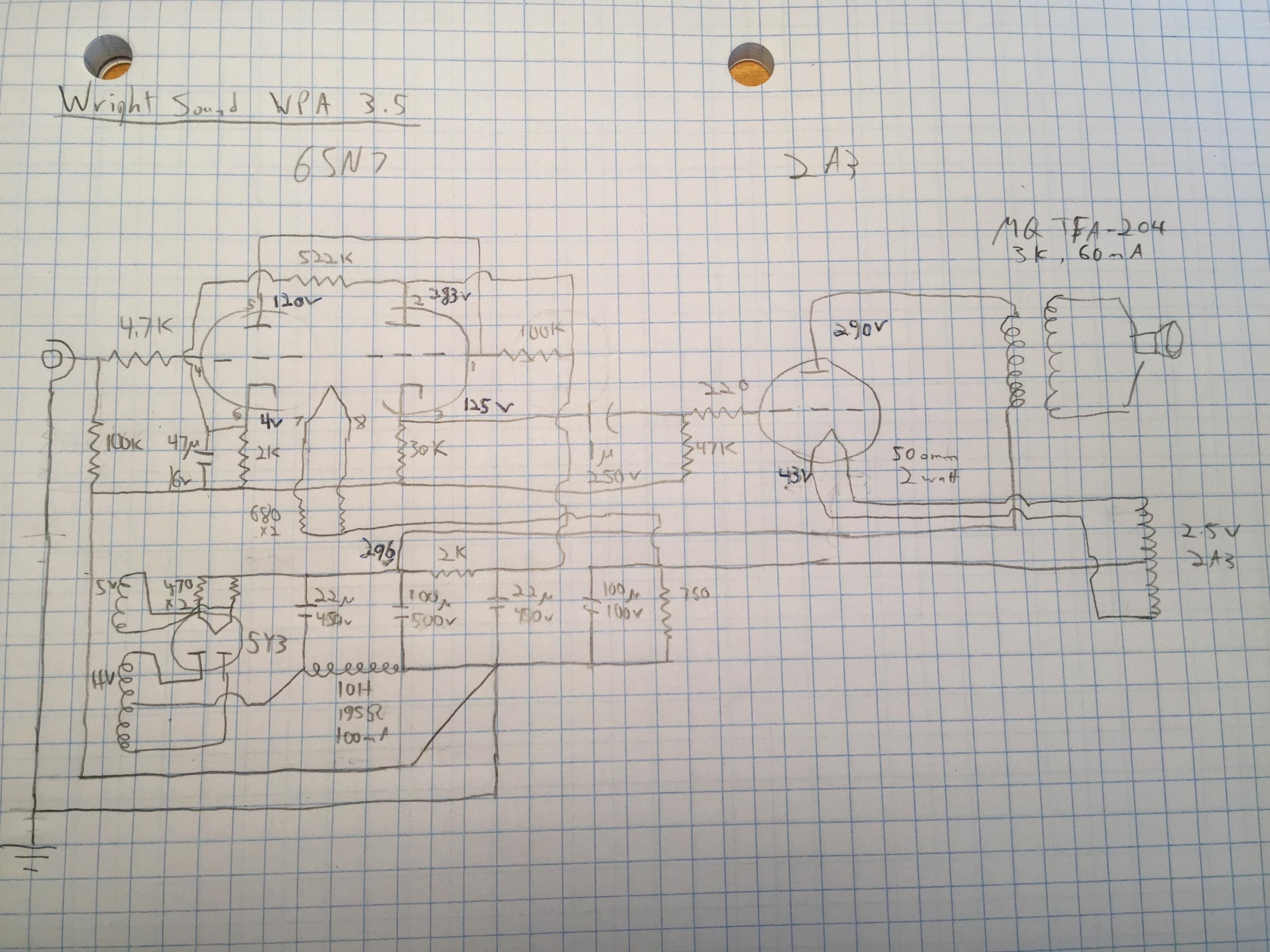

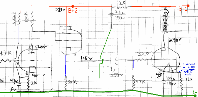

OK, since we seem to be discussing all things Wright schematics, I did up the original WPA 3.5 schemo myself, based on pics I've downloaded, and noticed a couple of errors in the owner-generated schemo I started with. It's awkward, and I'll need to redraw it, but it captures more accurately (1) how the 6SN7 cathode components and the 2A3's 47K grid leak resistor are tied to the negative leg of the final PS cap, (2) how the 2A3 cathode resistor and bypass cap share the PS ground bus, and (3) how the final PS cap connects the entire ground bus to the RCA input ground tab.
I infer that this amp is ultimately grounded through the line preamp via the interconnects.

Your drawing IS good, but confusing me. It helps to know too many schematics so you can recognize basic building blocks and know some good ways to draw them. Also some sturdy conventions for drawing layout.
Small audio usually has one "common" for all power and signal. Chassis, B- cathode returns, RCA jacks.
Tube amps generally have one main B+ for the power tube and some filtered B+ nodes for the small tubes.
This amp appears to have one B-, one big B+, and one small B+.
Draw two horizontal lines, top (B+) and bottom (B-).
Tube stages are usually a string of Rp, tube, Rk. Draw this top to bottom for each tube.
Here, V1a is the basic tube stage, plus that odd 522K resistor from B+ to Rk. V1b lacks a Rp (plate to B+), so draw that and its grid connection. Ah, it is a direct coupled cathode follower.
The little tubes need a cleaner B+ than the fat tube, so there is an R-C network in the B+ rail. While it may physically be with the other power supply parts, for functionality it is clearer if this is shown between little and big tubes.
Sticking with top-down B+ to B-, the 300B's plate winding goes up not down. This IS debatable, because there is SO much going on at a 300B's cathode (filament winding, CT, Rk and Ck, and here a bias for 6SN7 heater) that space gets tight. But I am an old square and I would still draw top-to-bottom. You got plenty graph paper (I approve!) and can find some paste if it runs to another sheet.
Drawn like that, we can see what does what, and what values may be dubious. Fer example, the B+ Plate and Cathode voltages, drawn top-bottom, should make sense. And now I can see and wonder what the 522K is doing here. It adds another half-mA to V1a Rk. (We could get the same bias without the 522K by making 2K into 2.7K.) If we wanted a certain Rk to set audio gain, we might do that. But no, the 47uFd cap takes Rk right out of the audio picture. Also means the 522K can't be any sort of ripple-cancel scheme. It does not make sense as NFB from any point on V1. It does make some sense as NFB from V2 plate, but we don't usually do that with fat triodes (prefering their own hollow NFB), and also I trust your examination. I wonder if it is vestigial from some earlier design. I can't see how one "useless" resistor is any sort of problem. If you found it there, leave it there.

PRR -- Thank you so much for going through all that. It'll not only help me make better schematics but also think through the circuitry more effectively.
Re: the 522K resistor -- It's funny that every time I post a George Wright schematic, people find some utterly baffling choices that can take up a lot of screen real estate. The 522K resistor has come up in several other fora, and this one at AA has an interesting take on it (read through the couple of followups):

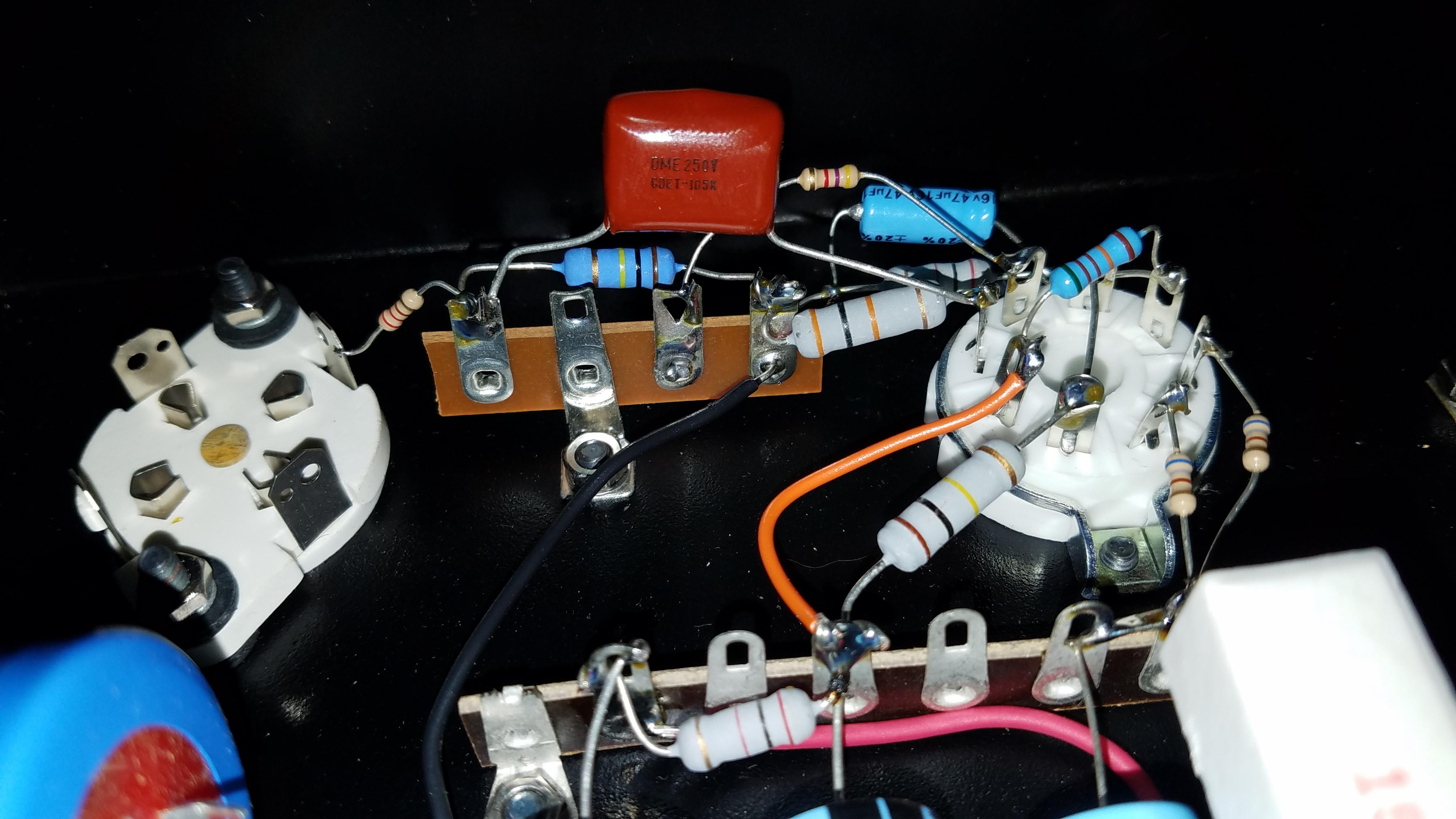

I took a photo of the underside of one of my incomplete Mono 7's. Hope it has something useful.
Hey nerdorama: What does it say on the side of the red "drop" style capacitor between the 6SN7 and 300B sockets?
Yes, I think that's right. Thank you!

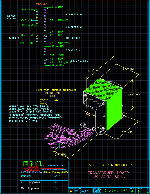

I just heard back from a DeYoung engineer with the DMI 500-7694 PT specs. The HV secondary winding is 620VCT 100mA. So, at 310V a side that confirms my suspicion that the Mono 8 ran at close to 2A3 voltages.
It would be fun to get my mono 7's running. I don't have any transformers so it won't be cheap. The partially finished amps I have are in really nice condition. It's too bad to have them sitting in the shed.
Well, I'll help you with that if I can. With the other pictures I have it might be possible to figure it out.
In other news, I just heard back from an engineer at DeYoung, who gave me the specs and a drawing of the DMI 500-7694 PT they used to make for George. The HV winding is 620VCT 100mA. At 310V per side, it confirms my suspicion that the Mono 8 ran at closer to 2A3 voltages.
The drawing also clears up a mystery encountered in the 6EM7 version of the amp, where a light blue and a white/yellow wire from the PT are soldered together on a tab near the PS but are not connected to anything else. Turns out they are legs of the two 2.5V windings, which combines them into a 5V winding for the 300B filament.
It's hard to read, but the two yellow wires are a 5V 2A winding for the rectifier.

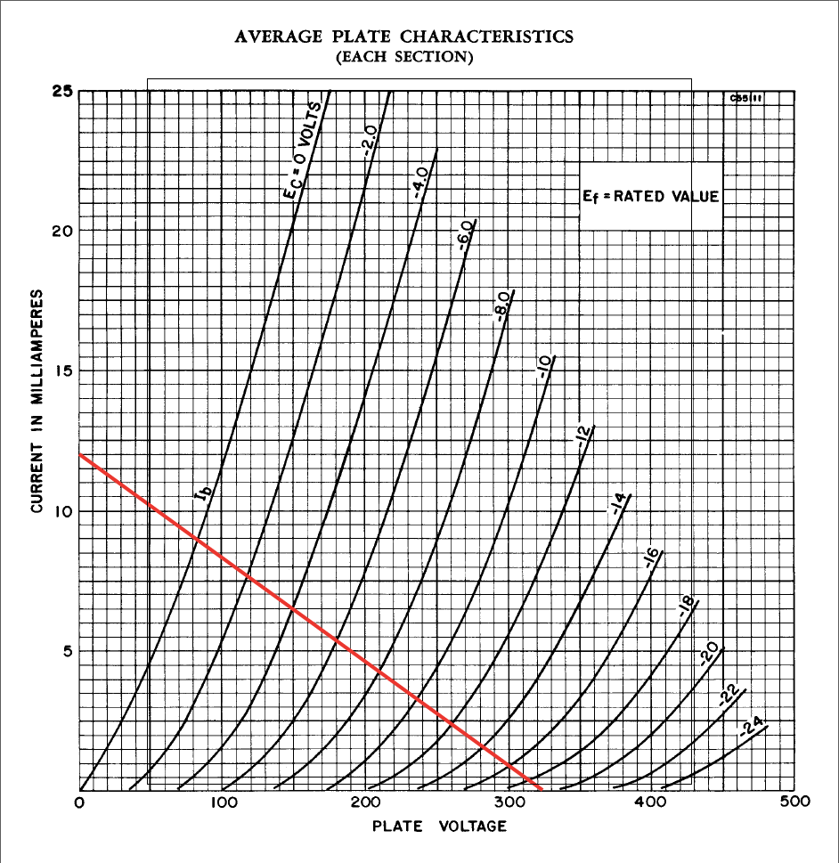

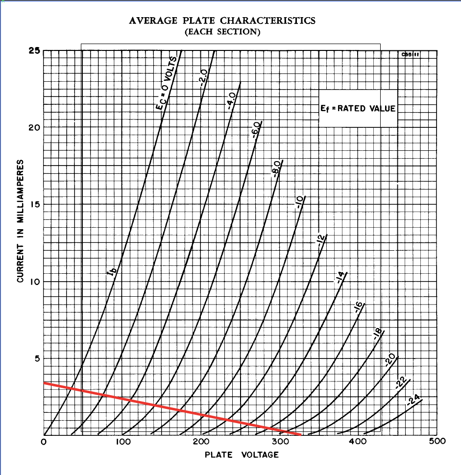

I tried my hand at load lines (attached), which look OK though I'm not sure I did it right.
6SN7 Triode 1:
B+ 323V
Rp 100K
323/100K = 3.23mA
So the line goes from 3.23 mA at 0V to 0mA at 323V. The line seems to match what I get in the model as 1.8mA at 139V. Does that seem correct?

What do we think about that? Should I get the couple of resistors and caps that I'd need, and do it up on the breadboard tomorrow?
Thanks nerdorama, that's much better. It looks identical to the input stage of the WPA 3.5, which is what I have on my breadboard right now but with a 300B output section. I'll start working on this today.

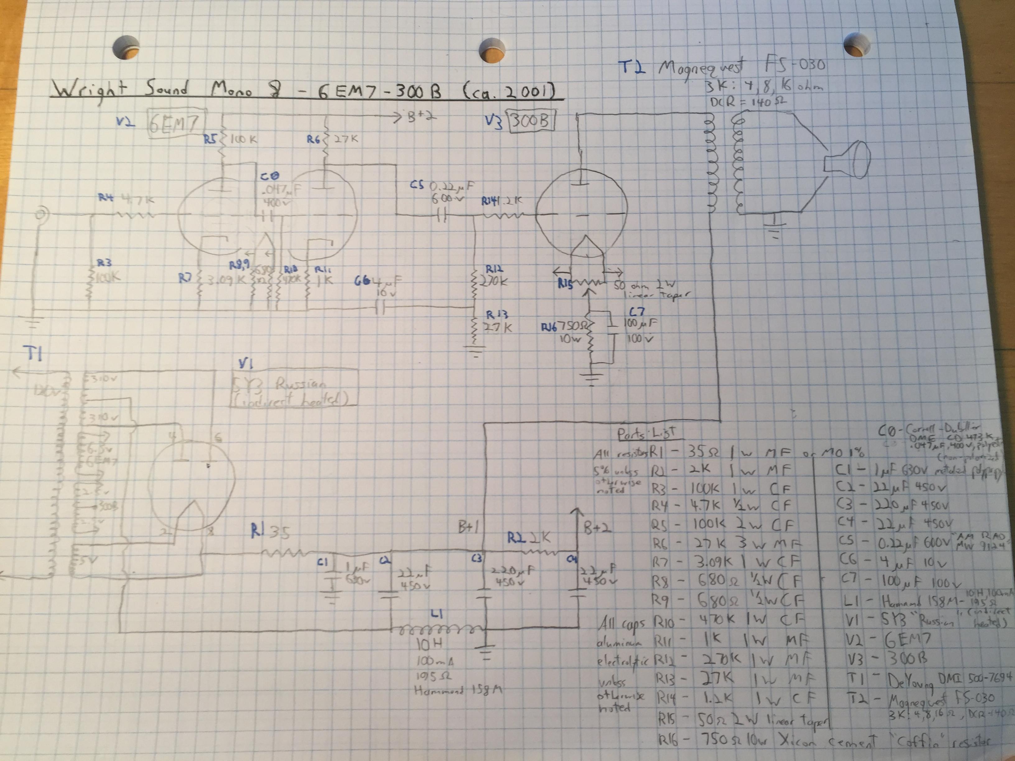

Here’s the (I hope) penultimate draft of the schematic with a parts list for the Mono 8 w/6EM7. I forgot to label the little coupling cap in the 6EM7, so I added it later as C0. Pending feedback, I’ll address any issues in the final version, which will be better scanned and accompanied by spice files.
If I can get a chance this week, I'm going to breadboard the attached circuit with 6SN7s, but with a bypass cap on cathode 2 as seen in the pics of the 6SN7 version originally posted.
In the resistor section of the parts list, MO = metal oxide, MF = metal film, and CF = carbon film.

The one underneath is 22,000uF at 25V. There's a blue one on top in a clamp that is 220uF at 450V.
Something not on your schematic that is in my chassis. A pair of 120ohm resistors on pins 2 & 8 of the rectifier and tied together at the other end.

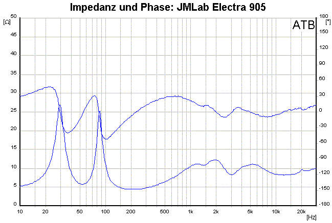

I'm thinking about reflected load on the 300B with my 5K:8ohm OPTs.
5000/8 = 625:1 impedance ratio
Square root of 625 = 25:1 turns ratio
Looking at my speakers' impedance curves (attached), it appears that there are two 25ohm peaks, it's at 5ohms between 140-400Hz, and the rest can be averaged at 10ohm.
So, 10ohm times 25 turns times 25 turns = a reflected load of 6250 ohms
Or, since we’re talking about impedances, you could simply take the impedance ratio of 625:1 and multiply that by the speaker impedance: 625 x 10 = 6250 ohms
Is that correct? If so, that’s a pretty high impedance for the 300B.
The only slots on Western Electric's recommended operating points table that come close to that are:
450V, 40mA, -104V grid into a 6K load (9.5W output)
450V, 50mA, -102V grid into a 6.5K load (9W output)
If I were going by the book, at 6.25K my op point should be right in the middle of those two. And it pushes the tube right to its voltage limit, which is not great.
Or should we just call it a day and go with 8ohms as PRR suggests? That makes the reflected load 5K --- 8 x 25 x 25 = 5000 --- exactly the OPT's primary impedance.
The 750R cathode ressistor for the 300B seems too small - if you are sure there is no back-bias used in the design. Also you do not design the amp based on the peaks in the speaker's impedance curve, you should use the nominal value as PRR has already suggested.Here’s the (I hope) penultimate draft of the schematic with a parts list for the Mono 8 w/6EM7.
