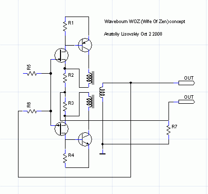

WOZ: Wife Of Zen concept (Courtesy to NP)
Here is one more concept, Wife Of Zen.
Balanced, FET inputs, transformer output.
Local NFB by current in each shoulder, common NFB by voltage, also a common PFB by current to reduce an output impedance. Inverting amp, both NFB and input goes to the same point.
Is not she beautiful?
Enjoy! 😀

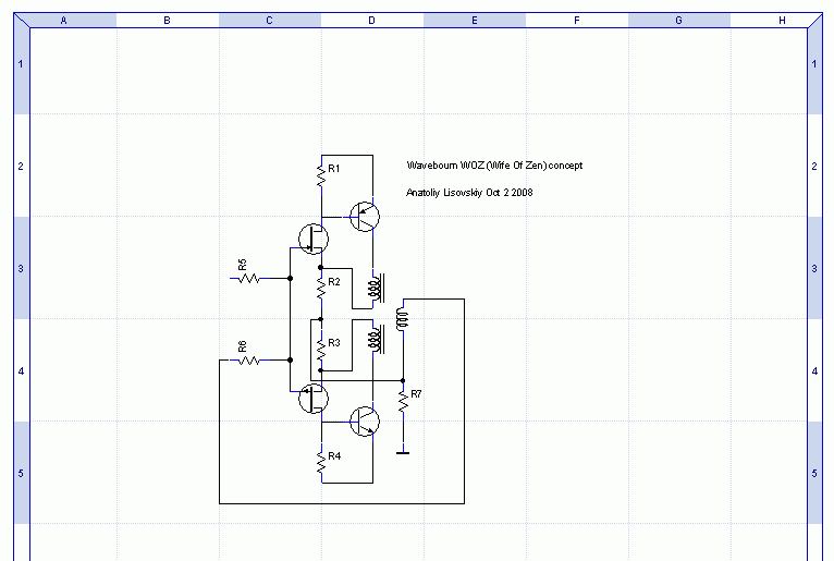

Mooly said:
Re post #1
A self oscillating "Wozallator" with reactance coil 😀
Why? 😀
The error was, a negative FB by current instead of a positive one. What pictured in #2 may be prone to oscillations on a frequency dependent on the speaker connected. Actually, one pot will be needed to fine tune positive feedback so output resistance will be enough negative to equalize the driver, but not enough to make it oscillating.
In a parallel thread a gentleman criticizes NP's amp for high output resistance, this lady may have any output resistance the owner desires. She is very flexible! 😀
Anatoly,
Just curious about your view on this, almost all the "feedback around an output transformer" methods I have seen fail because the feedback tries to correct what can never be corrected, which is the limitations inherent in a transformer. So, the result is an output that is on the surface "flat" in frequency but lacking otherwise.
What do you think?
